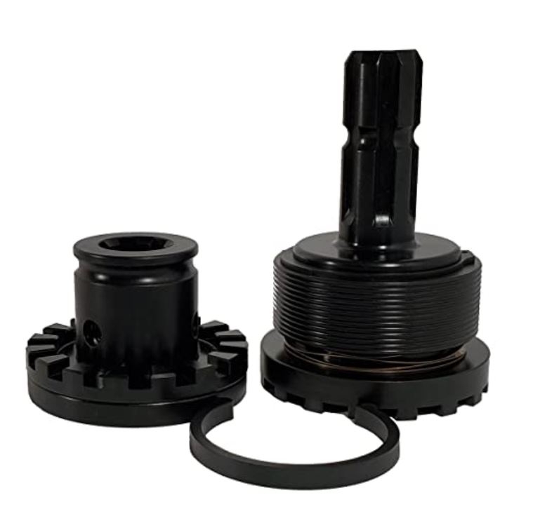

Seeking advice on getting a quick hitch. A quick hitch would make many things faster and easier but what about connecting the PTO shaft with a Quick Hitch? It looks like a quick-hitch would seriously interfere with connecting the PTO .
My Kioti DK45s has a PTO brake and the tractor shaft cannot be turned to align PTO splines.
Typically, I connect the top link after the PTO so I have more clear space for connecting the PTO.
So, does a Quick Hitch hinder connecting the PTO? It sure looks like it would but what have others experienced?
On a related issue, would a Quick Hitch damage the hitch pins on the attachment? It looks line standard lower-arm "balls" would be more gentle.
Thanks, Scott

I added a short PTO extension after installing a Pat's quick hitch and it is now easier to connect/disconnect the shaft.
