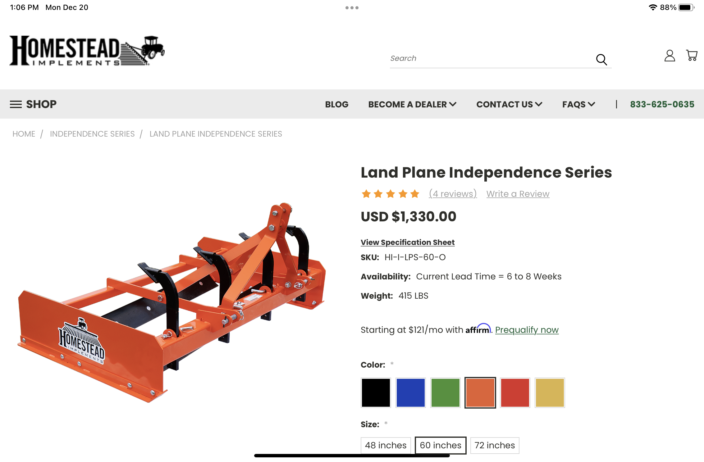

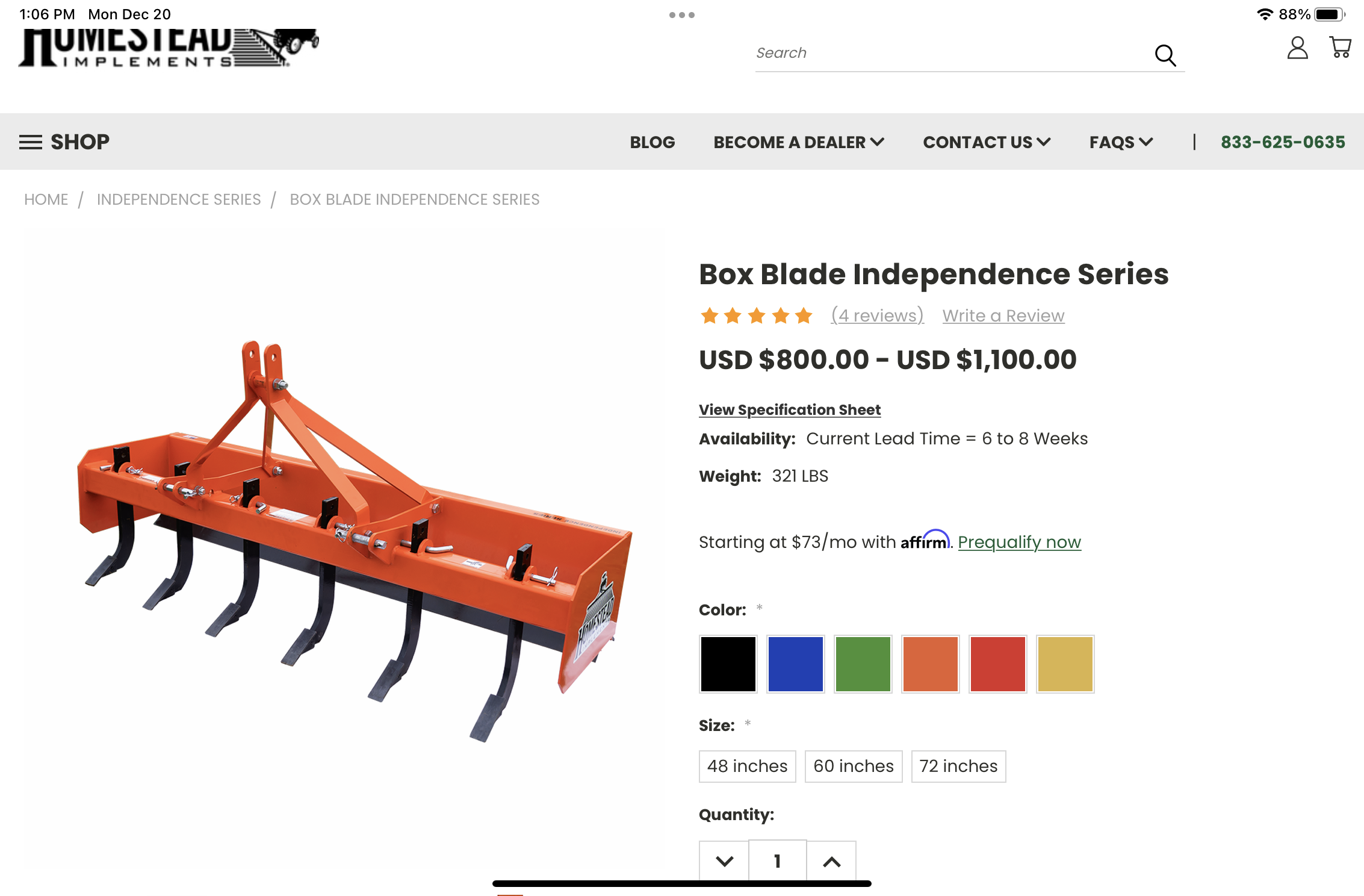

Box blades are cheaper than land planers? Box blades have more options on using.

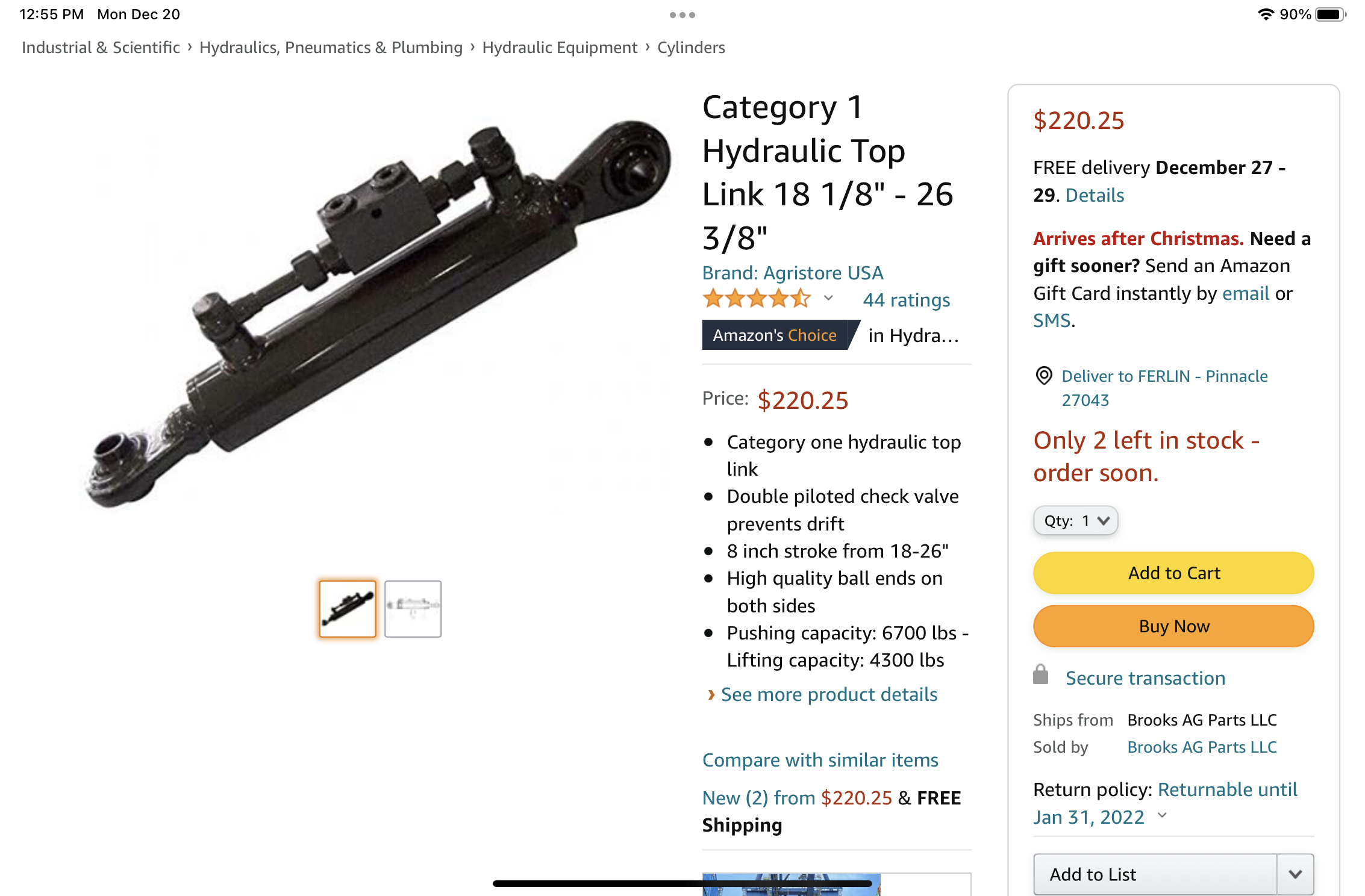

My roll over box blade( ROBB ) and my land plane grading scraper ( LPGS ) were $2900 and $2200 respectively. My back blade is a MUCH heavier implement and cost $3950. Remember - weight is your friend when dealing with 3-point implements.
Now is the time to purchase a hydraulic top link. If your tractor is set up with rear hydraulic controls. I have a Fit Rite hydraulic top link. It is a REAL game changer when dealing with 3-point land engagement implements.

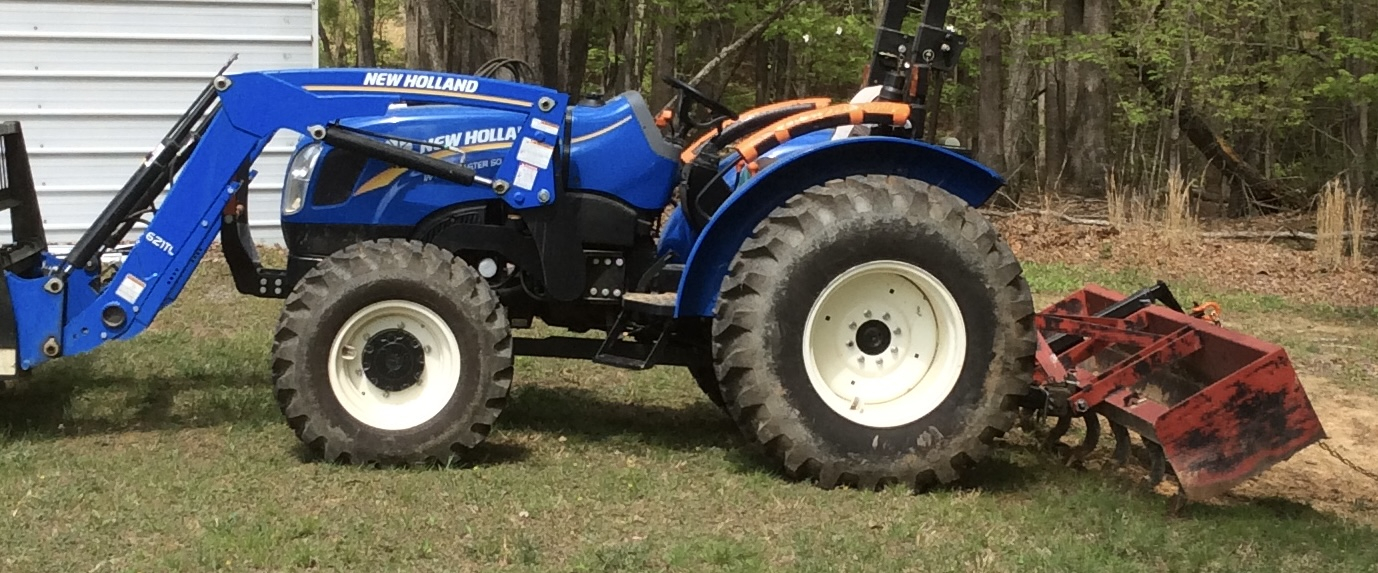

Titan Implement 60” box blade with scarifiers on my 35 hp Kioti. Plus a hydraulic top link which is awesome

Good setup!
