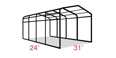

Looks like I知 going a completely different, thanks to Dale and his VersaTube link. Looking at a 31x24x8 carport.

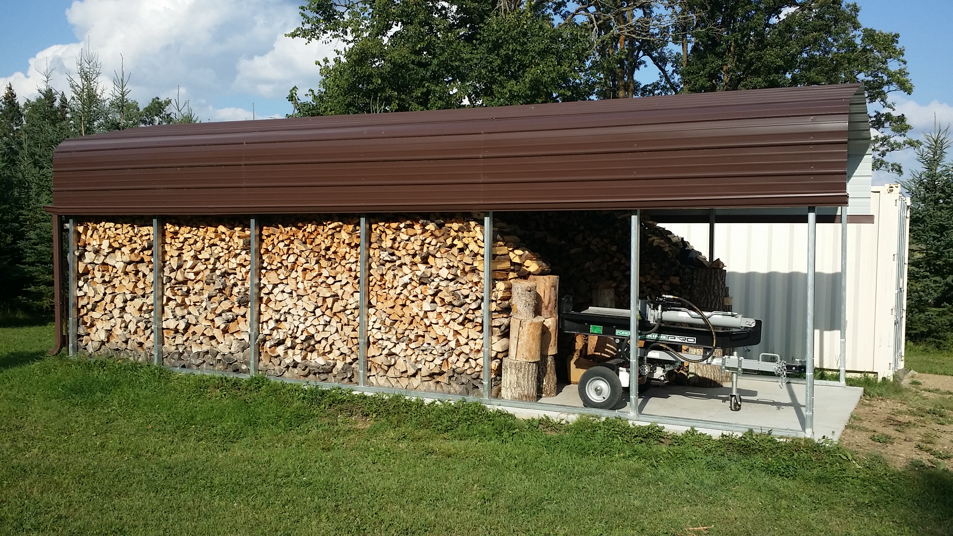

I used a VersaTube carport kit as a woodshed. After retiring, my wife and I moved back to Minnesota and wanted to use wood heat since we have 80 acres and more trees than we could burn in a lifetime. We had the concrete slab poured when we were doing our sidewalks and deck supports. We put the VersaTube kit up ourselves. Their directions are first-rate, in my opinion....very easy to follow.

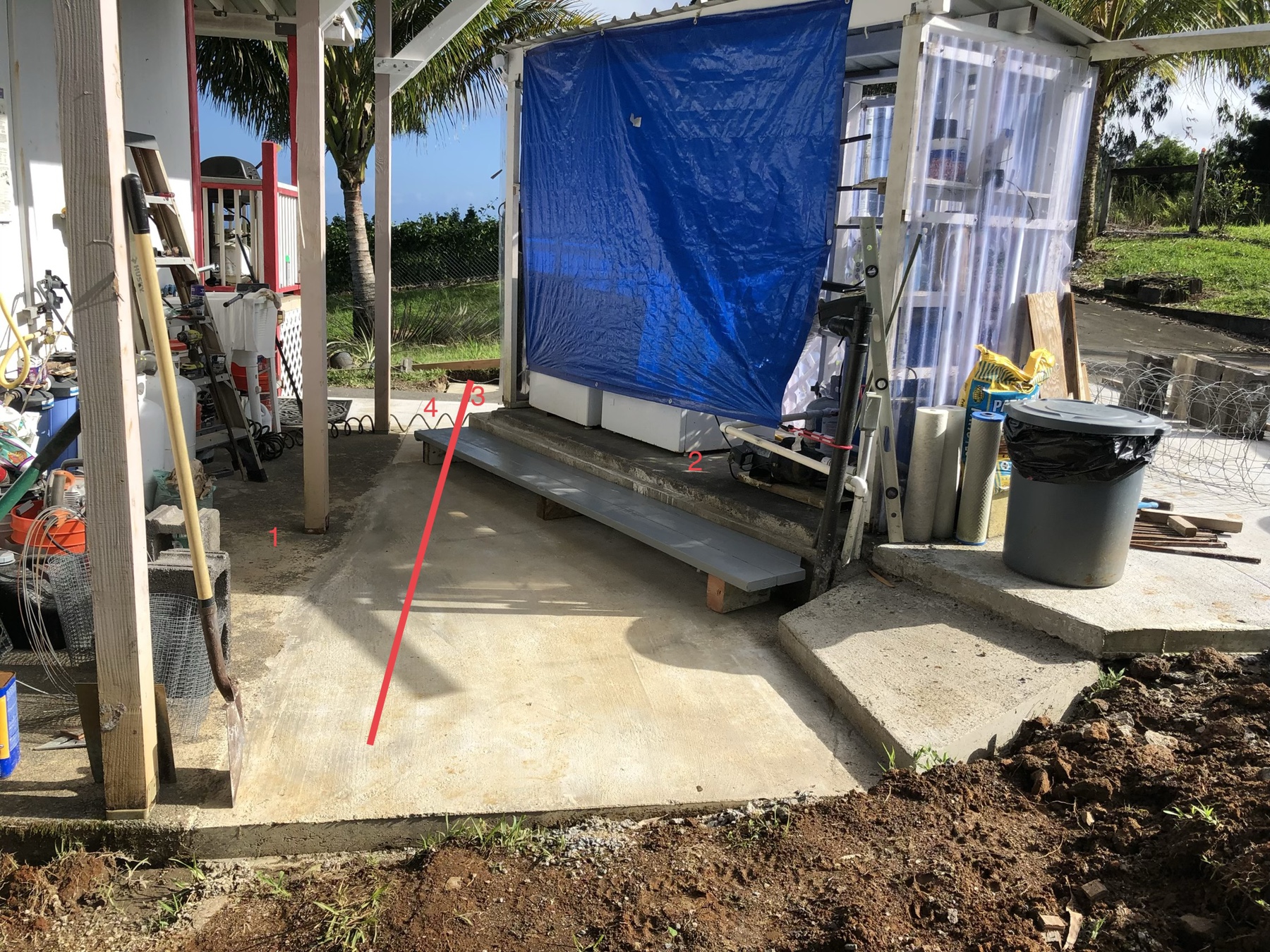

Closing in with carport prep. 36, 80lb and 6, 60lb bags of Quikcrete. Rented a mixer from HD for 1st day when a neighbor helped with slab. Wheelbarrow mix by self for the smaller areas.
Step painted today and temporarily back in place. Will replace the 4x6 wooden blocks with concrete blocks. Not sure of final length yet.
Concrete basically done except the cleanup, then need to work on placement of the carport supports (red line). Setting too close to the cottage and the verticals become obtrusive, too far away and the end post is potentially a problem in tying into number 2, but I will have to modify regardless. Won’t do anything permanent until pieces are in hand (ships Jan 2). Verticals are spaced 5,5,5,5, & 4 ft. Similar to below with 1 more section
This last piece of concrete ties in pieces from 4 previous pours over 15 year period:
#1 was part of original construction to give a dry place out of the mud for generator, batteries, washer & dryer, etc.
#2 was for initial solar panel install, just 6 post slanted frame. Latter enclosed and roofed to house washer & dryer, water pump & tank.
#3 was part of driveway pour for walkway.
#4 was this summers driveway expansion.
A very different vision from 2004
