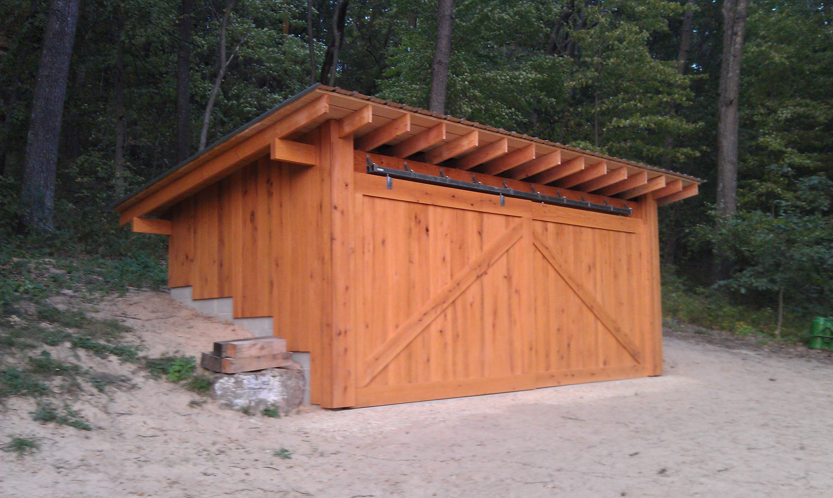

View attachment 348690The only real way to keep them from not only the element but from the sun is to use a shed. The draw back to the shed is then you have to maintain the the shed and incur the cost of building it. I personally built my shed so that I didn't have to look at them all laying around. I built it so that it was easy to get loader and 3 point implements in and out by having access to one entire side with sliding doors. I still have yet to build the heavy duty "shelves" to organize all the implements, so for now the ones that are already rusty stay outside until I get it organized.

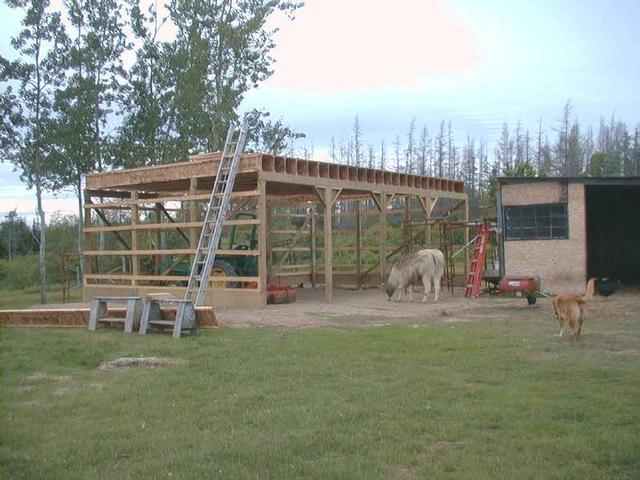

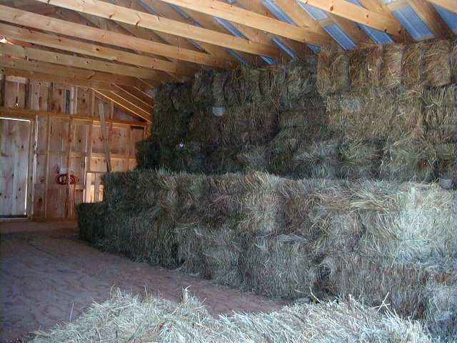

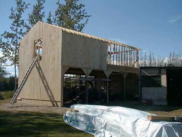

I needed both equipment storage and hay storage, so I built a minimalist barn.
Pressure treated 4x6-16' poles set below frost (4' minimum) on concrete pads, backfilled with screened gravel to shed water. Dirt floor. I did splurge a little on the second floor (hay storage) with 1-1/8 inch T&G subfloor over engineered joists. Nothing I hate worse than bouncy floors.
The main building is 20x32, the ell is 10x24. I had right at $8000 invested in materials including the metal roof.
It's been there since 2001 and hasn't moved a bit. It's situated with the back walls facing West and North and that keeps most of the snow out of it, and gives the critters someplace to get out of the wind in the winter and the sun in the summer.

That is VERY cool. Reflects your personality rather than a cookie cutter type. Are the loft floor joists those glued, particle board type?? Can't think what they call them?? Friend of mine is gonna use those to put a loft in his 16ft tall pole building. Very cool design. Has a definite country feel.

Thanks!
Yes the floor joists have 2x3 flanges and OSB (oriented strand board) webs. VERY strong and allowed me to span the 20' depth with no center posts. I can't even begin to wedge enough hay in that loft to stress the floor.
