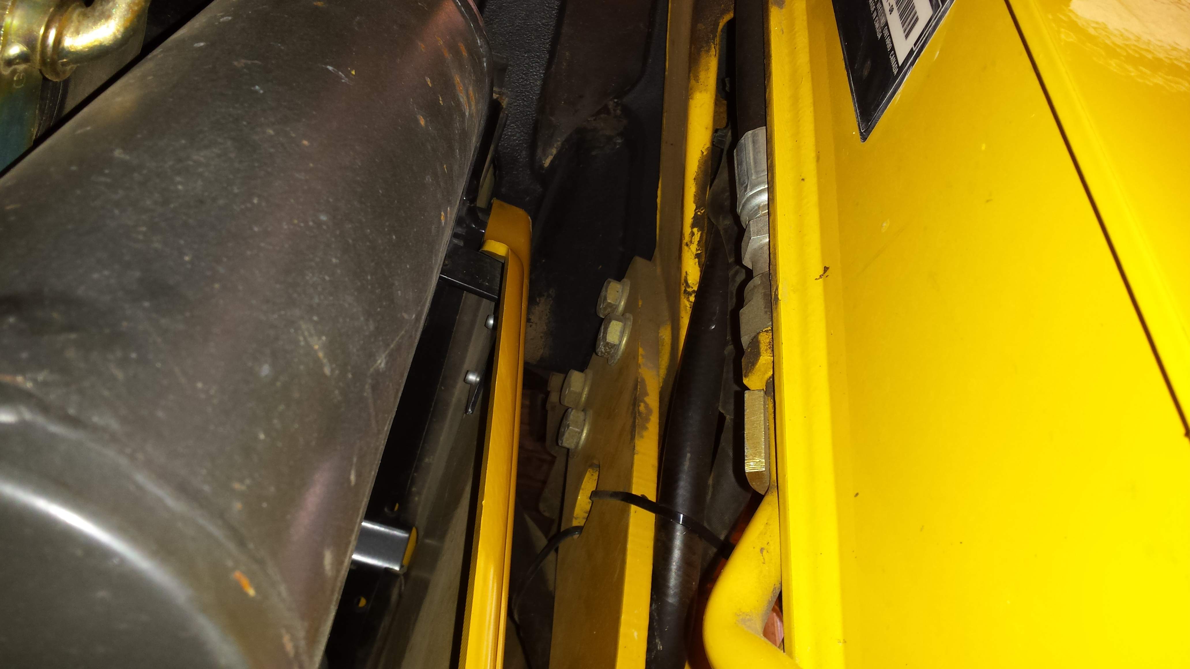

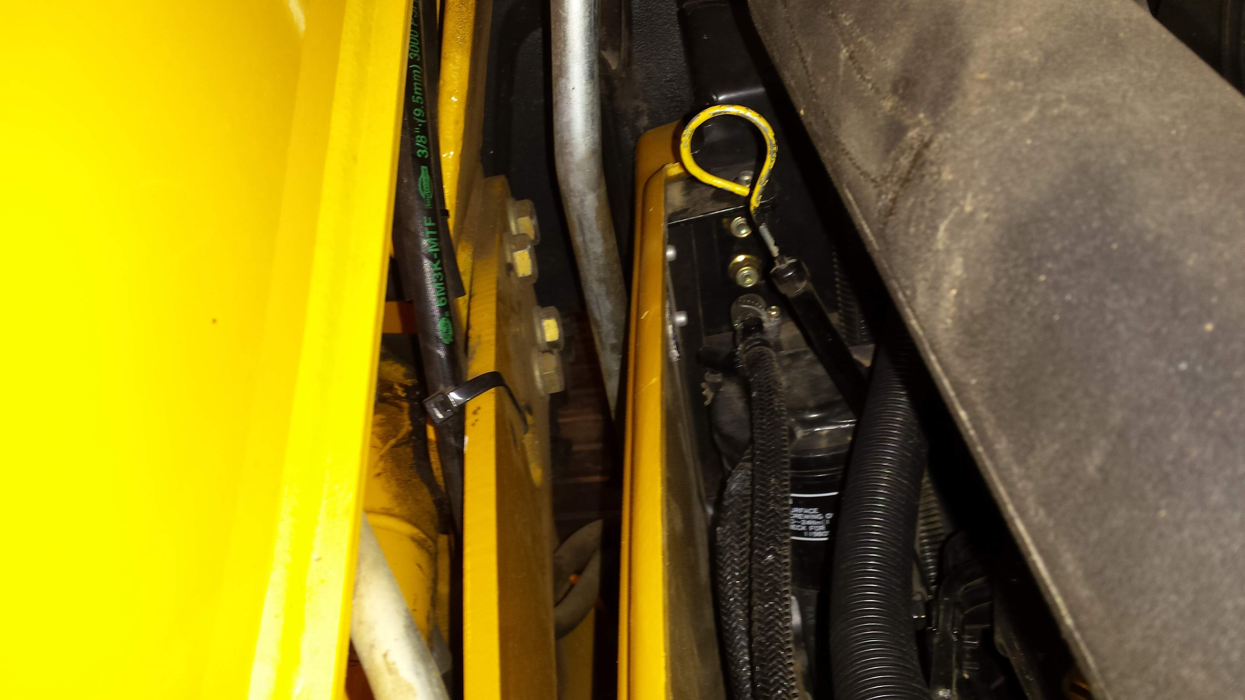

I'm wondering how you guys are getting the torque wrench on the bolts closest to the operator platform? I fiddled around today and could barely get the open end wrench in there. I only found one of the loader bolts to need a small amount more torque.
Matt
   / Cracked bell housing in a 2006 110TLB #58
Matt
Matt,
I did the same as you. I used a 24 mm open end wrench

I actually tightened the mast mounting bolts, I didn't even check the those bridal bolts. I figured that since the mast bolts are attached to the bell housing those were the likely suspects.
Matt
   / Cracked bell housing in a 2006 110TLB #60
I check the 2 large bolts on each side that bolt to the Bell/Flywheel housing... never thought to check the others...
