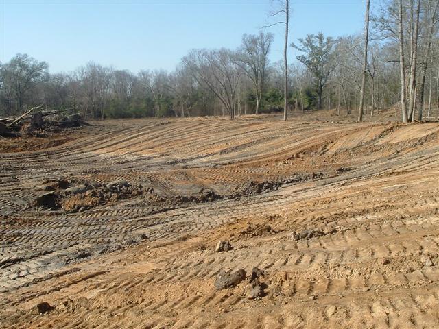

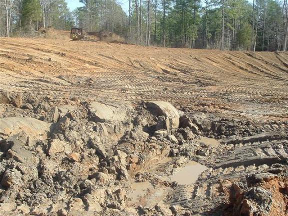

I took these pictures this morning to give you an idea of the dirt pile to haul out when the dump truck is done. When it's done, and if it's still dry out, I'll make another dirt pile. My goal is to get as much dirt out as I can before the rains get here.
When it gets too wet to keep hauling dirt, I'll close the valve, put in the culverts and let mother nature do her thing. There will be two culverts. One 15 inch on the side that doesn't get much runoff, and an 18 inch in the middle. On the other side, there is an open trench that will catch the majority of my watershed. Overall, there should be 80 to 100 acres of watershed.

Oh man, those pictures really put it in perspective! That is a HUGE project. I have enough trouble with the little projects I get myself into. That one is on a grand scale. Good luck with the rains this year too.

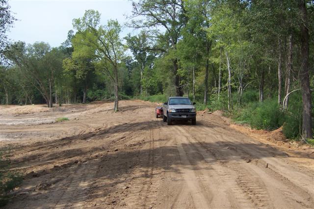

While waiting on the dump truck, I decided to put my culverts in. The shoreline road will act as a dam for the rain runnoff. I need to channel it to the lowest point and get it under the road and into the lake.
Based on the size of my watershed and extreme rains, I decided to use an 18 inch and a 15 inch culvert. There is also an open trench along my property line that carry the majority of the water shed.
The first picture shows my truck and trailer on the shoreline road.

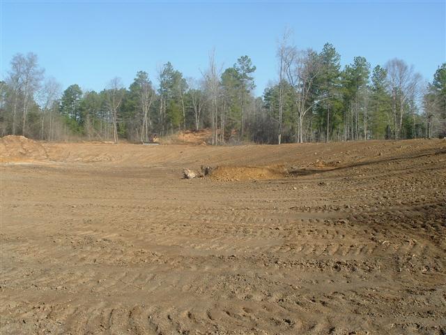

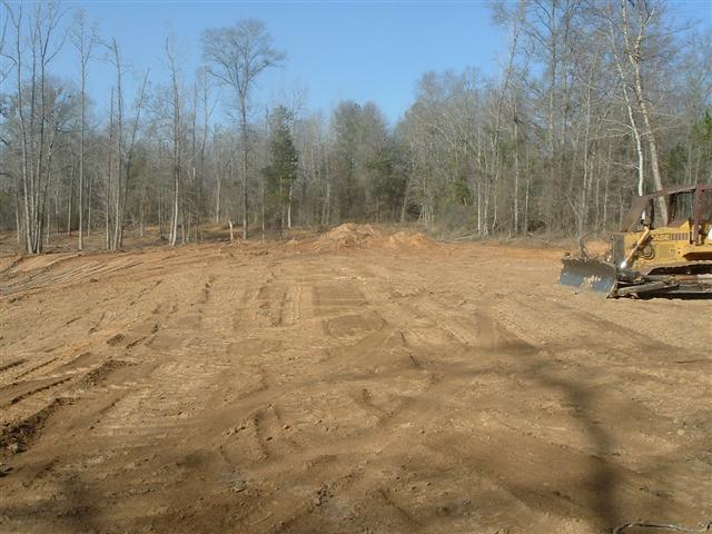

Here are a few pics that I tool yesterday. The dirt pile is just about gone, but I need to spread some more dirt along the width of the dam. My dam is about 6 feet tall on the outside with the water level rising about 4 feet up it when the lake is full. The inside of the lake is about ten feet deep about 30 or 40 feet from the dam and continues to drop to 12 feet in the middle.
My dam doesn't need to be any wider, but it's more attractive, the wider I make it. I like the gently slope of it and a nice wide open top to walk on. Too many dams that I've come across are barely wide enough for two people to walk on side by side. On mine, you can drive cars in two directions!!! Not that anybody will be allowed to drive on it, but I could if I wanted to. hahaha
