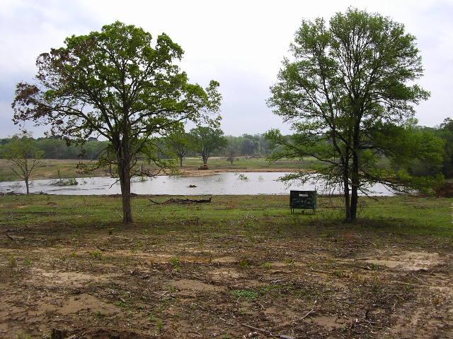

The pile was bigger than I realized, but after days and days of hauling dirt, I got er done!! Then after looking at the open space, I got to thinking that it would be nice if that area was a few feet lower. Maybe 4 feet at the tallest point. hahahahaha
First pictures is of the pile almost gone.
Second picture shows the nice, beautiful, open space that is left.
Third picture shows the new mound and Steph's son at the top of it. Give a kid a mound of dirt, and he's as happy as they get!!!!

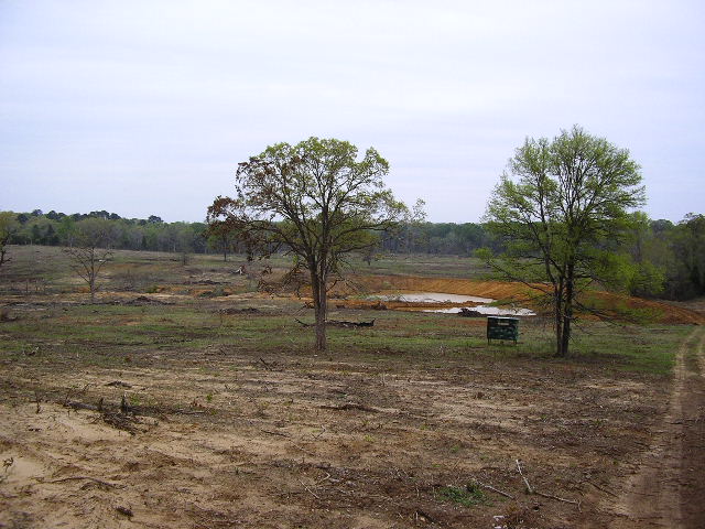

I finished hauling the dirt pile out of the lake. It rained on me before I could finish, and dealing with the mud two days later made for some fun tractoring. Not!!!!! But it's done, so that's all that matters.
Now I'm waiting on the burn ban to be lifted and I'll burn the last of my wood and gargabe. What's left after that just becomes more structure for the fish.
The picture is of the area the dirt pile used to be.

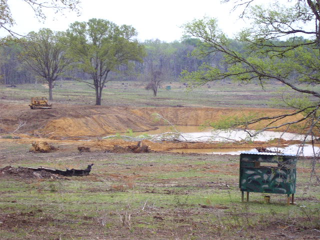

There is a 40 percent chance of rain tonight, 30 percent chance tomorrow and another 40 percent chance for Friday night and Saturday. The forecast seems to change every time I check it, but the overall theme seems to be that for the next ten days, it's probably gonna rain a few times.
My goal today is to get some seed down. It's warm enough out that I think Bermuda will work, so I have 50 punds of the good stuff. That means it's 98% pure hulled seed.
First thing I did was drag the ouside of the dam with my log drag.
The pictures are before and after shots of my dam. Rough from the dozer tracks and blade, then smooth from my drag.
