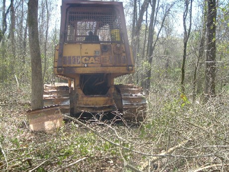

I'm at the worse spot to get my key way in. This is the lowest point, which is the wettest. The dozer is useless, so I'm using the backhoe and doing it a little at a time.
This is what it looks like before I start clearing.

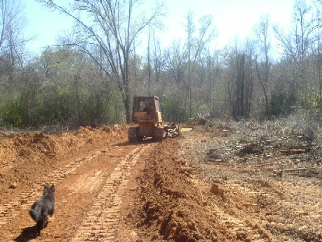

#102
There was a stump that needed to come out which wasn't directly in line of the key way. That just means a little wider trench and more fill material.
Since this is the beginning of the deepest part of the lake, it will also be where the dam is it's tallest, which means it's also where the key way must be it largest.
I ended up digging down around eight feet to get to dry ground. I want the fill material to be on a solid base.

#104
You can see the differnt color of the dirt from what was there and what I just did. The darker material is the new stuff and has more surface moisture. Otherwise, it's exactly the same material.
This is as far as I got in one day. About 40 feet.
Once I get through this area, I'll have to come back and clean up the material on the sides. It' full of roots and could lead to leaking in time.
All the material that isn't clean will be used on the outside of the dike after I finish building it.
