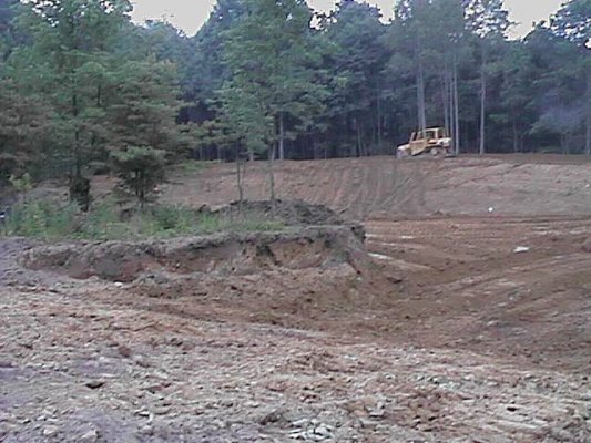

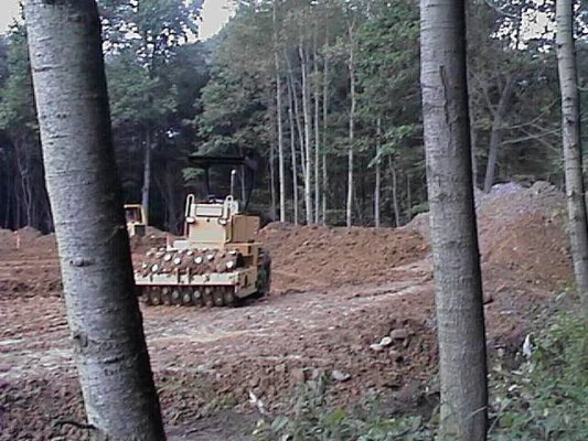

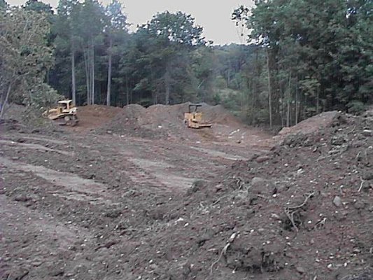

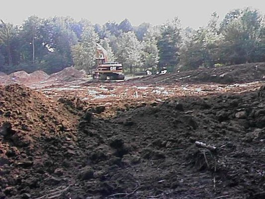

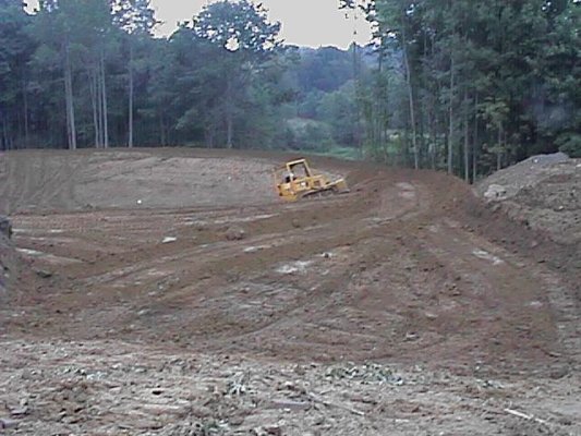

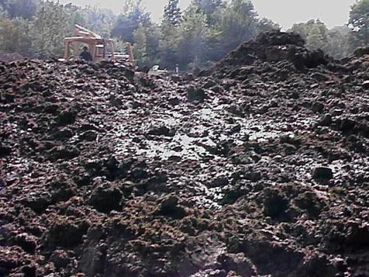

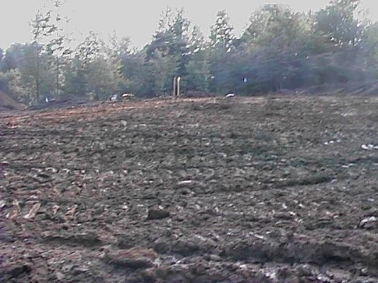

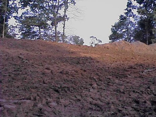

I read all these post from stat to Finnish. Great job it make me want to start another pond. Eddie we are just about neighbors. I live just across the TX/LA line. I finished my pond three years ago here are some pics after I finished I planted grass and had chopped hay put down for soil control. My dam is right at 100 yards long. My water is around 8' at the pier. And 16' deep in the water on the far bank across the pond. I was building my pond with my dozer I had at the time a D6C. While I was working on the pond I was also building my house. I would have contactors come and buy dirt from me. I would trade for road rock. Once my road was rocked we would get cash. I had one contractor come and want all the dirt I would sell him. He hauled out of here for two years on and off. He bought around 100,000 cubic yards. So I made my pond deeper and larger. I just took me longer to build. It was also a pain keeping the hole pumped out. The finished pond is around 4 acres.
Eddie the dirt you have in your shooting lanes looks just like my dirt it is a sandy clay that compacts like a brick. I rolled dirt in thin when I was raising my dam. It compacted great just using the dozer. When you do your final grade on your dam make a higher grade in the canter to allow for settling. Just have it bow up. Try to run you spillway through uncut ground like trees to the side of your dam. Build a berm to keep the water from running on the new dirt behind the dam. I have two 4" drainpipes that maintain my level and then my spill way is one foot above my drainpipe. I have my pipes set at the bottom of my dam above the core. They 90 back up to the pond with siphon breaks. I can drain the pond with the same pipes if needed.
