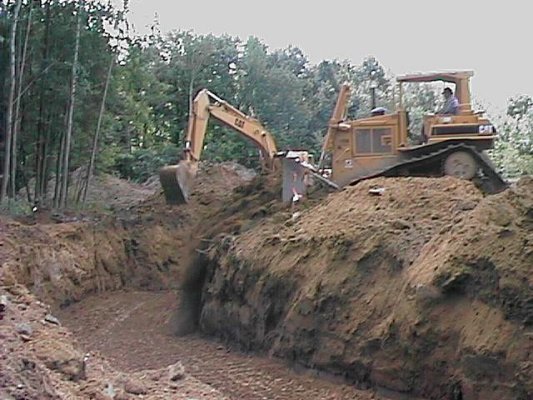

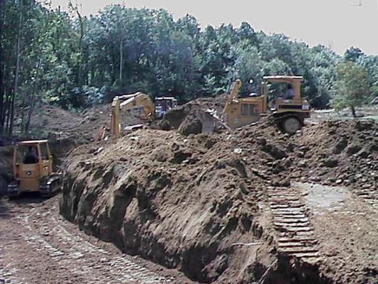

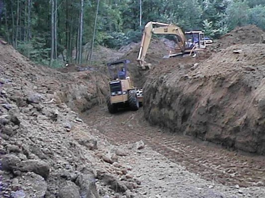

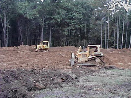

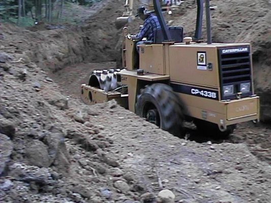

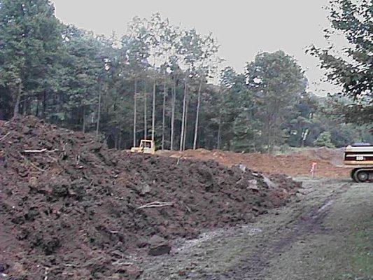

#138
Ready to weld.
Eddie
/ Creating a Lake
