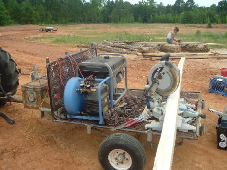

Most panals I can get on the wall easy enough by sliding them up my ladder until I can rest it on the one below.
For the ones above the roll up door opening, I couldn't do that. The ladder has to rest agains the wall, and the panal needs to be inbetween the wall and the only place the ladder has to rest.
My solution was to use my tractor.
The top of the door opening is 10ft.
I screwed on a piece of plywood to the opeing to provide a rest for the panal while lining it up, and to help hold it in position while nailing.
Sometimes working alone has it's drawbacks. /forums/images/graemlins/crazy.gif /forums/images/graemlins/confused.gif /forums/images/graemlins/frown.gif /forums/images/graemlins/grin.gif

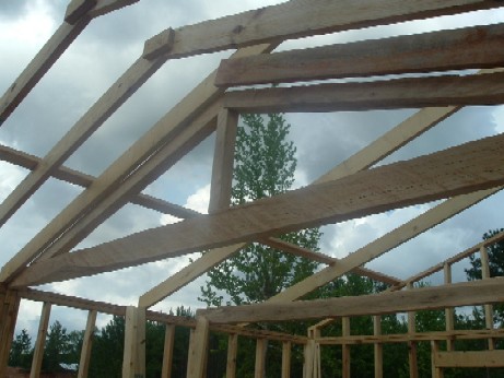

This gives you an idea of how it's gonna look when finished.

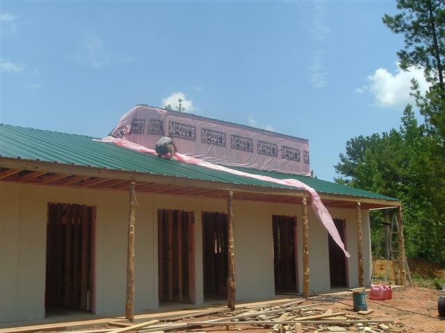

Sorry Danny, heres a shot of "super woman" hanging the house wrap on the second story.

It was only 90 degrees today with the humidity at 60%, wich is really mild. Even so, it was much hotter on the roof, and she really suffered. But she doesn't quit until its done!!!!
She really is my "super woman!"

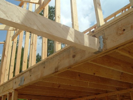

This is what I have to deal with. Heights are a fear of mine, and the higher I get, the greater my fear!!!!!!!!!!
I've been looing at this, trying to figure out how to aproach it, but mostly stalling, trying to build up my nerve.

Turns out my buckets maximum height is just above the upstairs window sill. All I had to do was park the tractor at the window, climb out the window, and work away. /forums/images/graemlins/smile.gif /forums/images/graemlins/frown.gif
At first I was pretty nervous, but fairly quickly, I gained confidence and was able to bring a stool out to stand on inside the bucket. Gave me another 16 inches of reach!!
I'll have to get the very tops from above, but with the rain we got today, there's no way I can stay on a slippery metal roof. Can somebody say "waterslide." /forums/images/graemlins/shocked.gif
