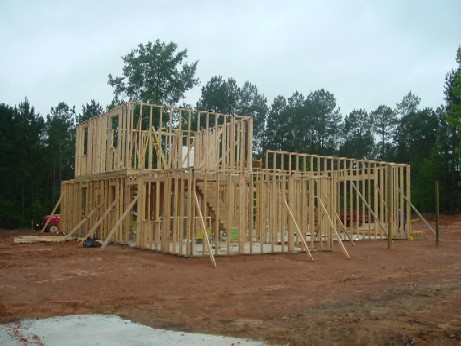

</font><font color="blue" class="small">( These angle braces will hold it until my siding gets here. Lesson learned.
)</font>
When I built my home, I used braces like this, but they were laid across the wall and the studs marked. Then, using the circular saw, saw kerfs were made on both the top and bottom that were 1 1/2" deep. Then using a hammer, each piece was hit and broken out of the studs. A quick clean up with a chisel and then the bracing was nailed into the grooves that were made in the studs. This is called "let in bracing". It added great stability to the walls before sheathing and also I have had no plaster cracks from the walls moving in over 25 years. It doesn't take very long and it will keep the walls from racking in the future.
/ Creating a Workshop & Home #163
<font color="blue"> When I built my home, I used braces like this, but they were laid across the wall and the studs marked. Then, using the circular saw, saw kerfs were made on both the top and bottom that were 1 1/2" deep. Then using a hammer, each piece was hit and broken out of the studs. A quick clean up with a chisel and then the bracing was nailed into the grooves that were made in the studs. This is called "let in bracing". </font>
Back in the days before plywood and OSB sheathing, this let-in bracing was a standard practice on new construction. It adds a little bit of extra time, but it might be worth it in Eddie's projects, since the siding is going right on top of the studs...
#164
Thanks guys. I'm aware of the technique, but decided not to use it as part of my experiment with the HardiPanals.
Two other methods that are used in California, where I'm from, are metal strips tied into the sill plate, and metal stips tied into the foundation.
In fact, one of the newer requirements in some earthquake areas of California require the metal straps to be tied into the rebar in the footings and continue to the rafters. I forget the spacing of this, but every four feet sounds about right.
Plus the sheathing must be used on "ALL" exterior walls. Not just the corners.
I've got clear skies for the next week, so I should be good until the panals get here on Tuesday.
Eddie

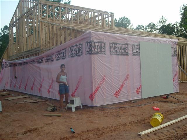

My siding arrived yesterday, but I didn't get a chance to start on it until today. Trying to get power ready to be connected.
My girlfriend is doing the house wrap, while I'm hanging the sheets. I only put on the full ones to start, kind of getting my feet wet. In the morning I'm gonna start cutting. /forums/images/graemlins/shocked.gif Not sure what to expect, but I did by their special blade for cutting it, so we'll see.
Eddie

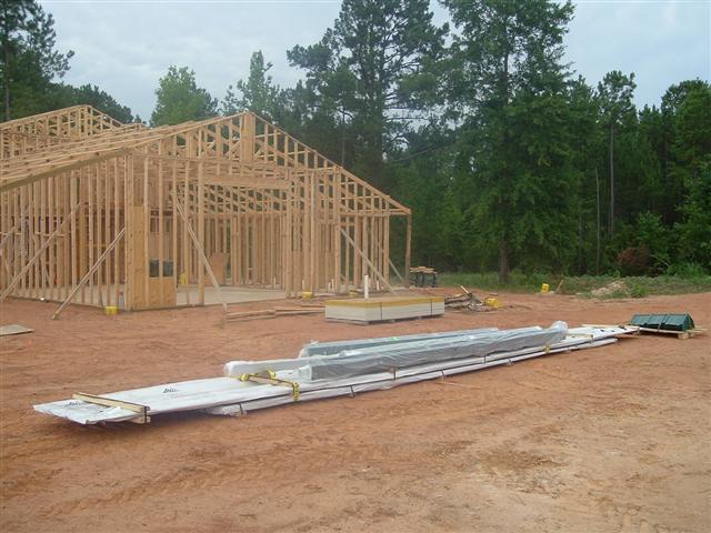

The roof arrived a few days early, so I had it set aside until I finished with another project.
