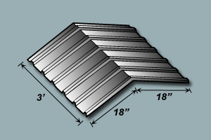

Eddie, I was looking back at this thread and noticed the ridge cap on the shop. I have never seen ridge cap like that. Is it preformed for each specific pitch, or do you bend it more for a steeper pitch. My ridge cap is a piece of metal that is 20" wide and 10' long with a bend in the 20" side. You simply flatten it for a shollow pitch and bend it more for a steeper pitch. The ridge cap on your's looks a lot better. On first glance it looked like you used 2 pieces to make the length, but I new from seeing your work that you wouldn't do that. It was then I noticed it was the cap. Latter, Nat

Nat,
I bought my material from Mueller. There website is www. muellerinc.com and this photo if from there.
They screw on just like the panals. I had the roof panals cut about six inches short so I could adjust to fit.
I've never seen a building perfectly square, and this one isn't either. It's close, but I still need some fudging room.
In order to line up the roof panals on the other side, we brought up a ridge cap and set it in place. Then we lined up the roof panal so it would square up with the panals on each side and the peak. If not, you can have a nasty twist.
Even with lining them up real good, there are a few that need an extra screw to keep everything flush. After awhile, they have a tendancy to ride up on each other.
Mueller bends them to any angle you want. I'm at a 4:12 pitch, so that's what it came in.
I had a few options for the peak and chose closing it up. I will vent from the sides.

Eddie, I used the same ridge cap from Mueller about 2 years ago on my carport. They sure make for a clean look and no need for the gasket material. I have asked for them at other places and always get a "what are you talking about" look. /forums/images/graemlins/confused.gif I wonder if its a Mueller specific product?
Sure is looking good. Keep the pictures coming.

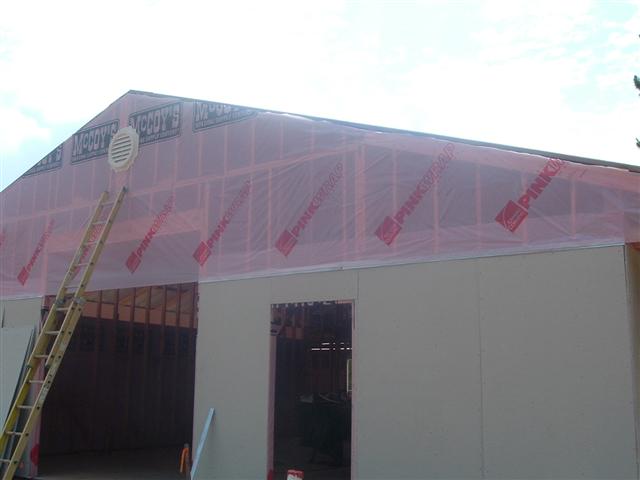

I mentioned earlier that I'm not venting through the roof. I decided to vent on the peak of the gables.
This is the first one.

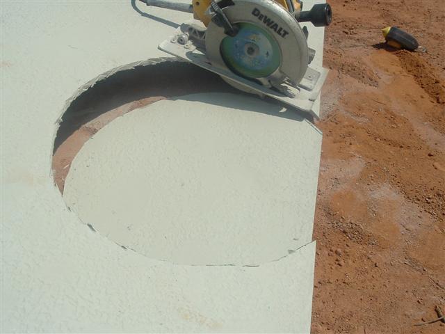

The vent is centered, but due to some creative framing, my panals didnt' line up on center. Not that it's important.
I'm using the diamond blade that was reckomended to me by my supplier to cut with. For the circle, I just plunged the blade in all the way around.
From a distance it looks round, but up close it has dozens of short, straight sides.
This will be covered in the end with a cap that comes with the vent.
