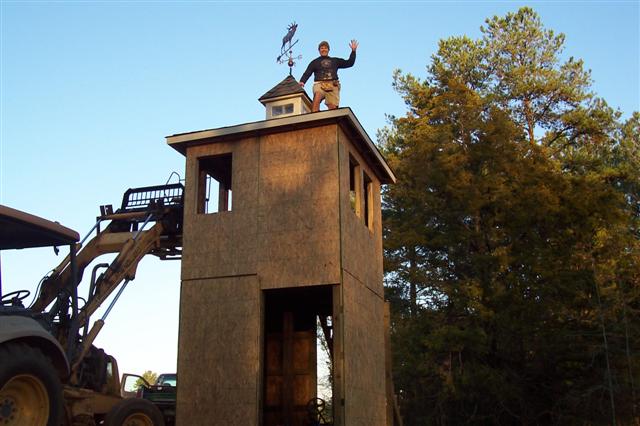

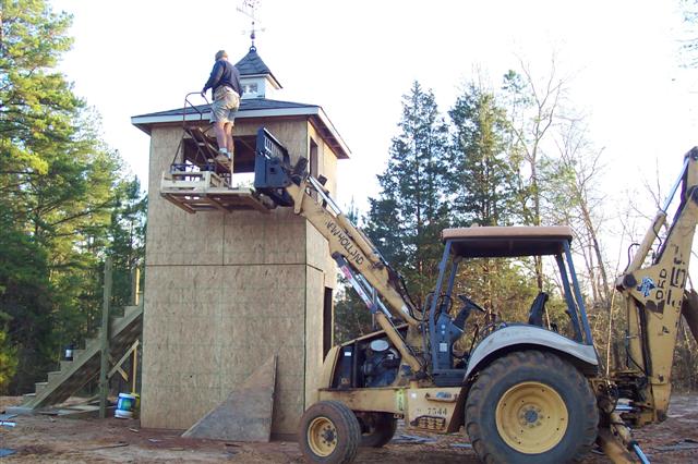

I'm done with the shingles, flashing and putting the Hardi on the cupola. The roof is now water proof and ready for some rain. This was the hardest part of building the blind for me, and I'm very happy to have it over with!!! :)
Steph came out to check on me and with my ear plugs in, I didn't even know she was there for the first few pictures that she took. When I looked down, there she was.
Eddie

Wow! Wonder what the deer are thinking? I know the many threads about using the loader as a work platform but I think I would rather be on that than most ladders.

I think your loader and pallet is safer than a ladder.

I hate ladders, but I'm fond of scissor lifts and manlifts. They can also fail, but they do have lock valves. Eddie, your tractor's hydraulics must be very tight to not leak down and the platform sag. Most of our CUTs don't have the quality hydraulics of your tractor. The only issue I have is you working by yourself at those heights. That's the scariest part to me. I'm glad Steph showed up to check on you.

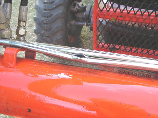

Eddie, don't worry steel hydraulic lines don't rupture.

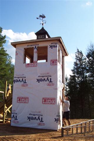

Yesterday I put two layers of insulation into the attic. I have some R13 wall insulation laying around, so I put one layer in one direction and then another layer in the opposite direction so it overlaps. I thought about making a basket when I was doing this.
Then I put in the OSB ceiling. Just doing this gave the building a totally different feel. Then I started to do the interior walls, but ran out of battery power on my cordless tools. My cordless sawzall eats up the batteries. Normally it's not a problem since I have two chargers and four batteries, but working out in the woods without any power for the chargers makes it impossible to keep them charged.
Today I finished off the interior walls and did some small things to the exterior siding that I had put off until now. Then Steph came out just as I was cleaning up the mess from cutting out the windows.
Then we both put on the house wrap. It was windy today and one time we had too much unwound, which took off like a parachute!!!! Funny how quickly that happens.
It was getting late in the day, and I hadn't bought the windows yet. That's the next step, but while there is still an opening in the walls, I decided to take advantage of Steph's help and put in the soffits. I wanted the house wrap on first so that I could tuck it up and over the soffts and add one more little level of water proofing.
Eddie

I think if y'all look real close at the L/H cylinder there looks to be a "U" block so as to lock the loader in the up position as the hyd leaks down.
At least that's what it looks like to me......
   / Creating my "Over the Top" Deer Blind
#70
Yes, there's a block there, but it's for safety while working on the engine with the loader in the up position. I have it locked while on the platform, but it's not touching. The cylinders don't leak down while I've been using it. No movement at all. If it did, I would be to afraid to be up there.
Don't CUT's have this for safety?
Eddie
