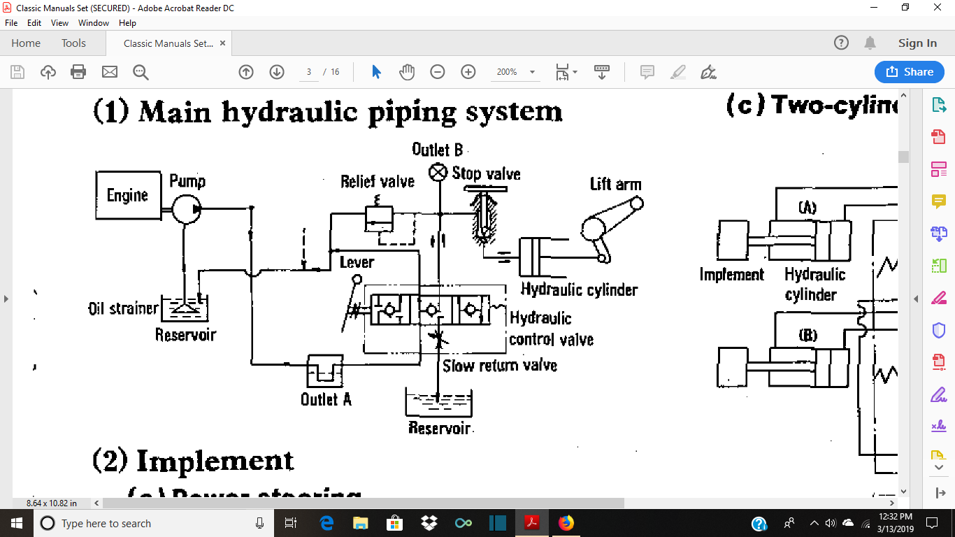

#29
I am convinced that the problem is in the 3 point. It could be a couple things including a leaky relief valve.
The circuit shows the 3 point valve as a 3 position so it has a neutral. This part could be leaky as well.
I think I may take the valve apart and see if there is anything obvious.
   / Creepy loader #30
All those 3 points leak with age. The shaft in the valve is just a machine fit. As it wears fluid can slip past and "leak" internally. When the machine is on it just adds the ting bit of fluid so you never see you implement drop, but when tractor is shut off that's when you will see it slowly fall down.
I have had mine apart a few times. There are no spare parts to be had for them other than parts tractors and there is no seviceable/wear parts on the inside of them either.
