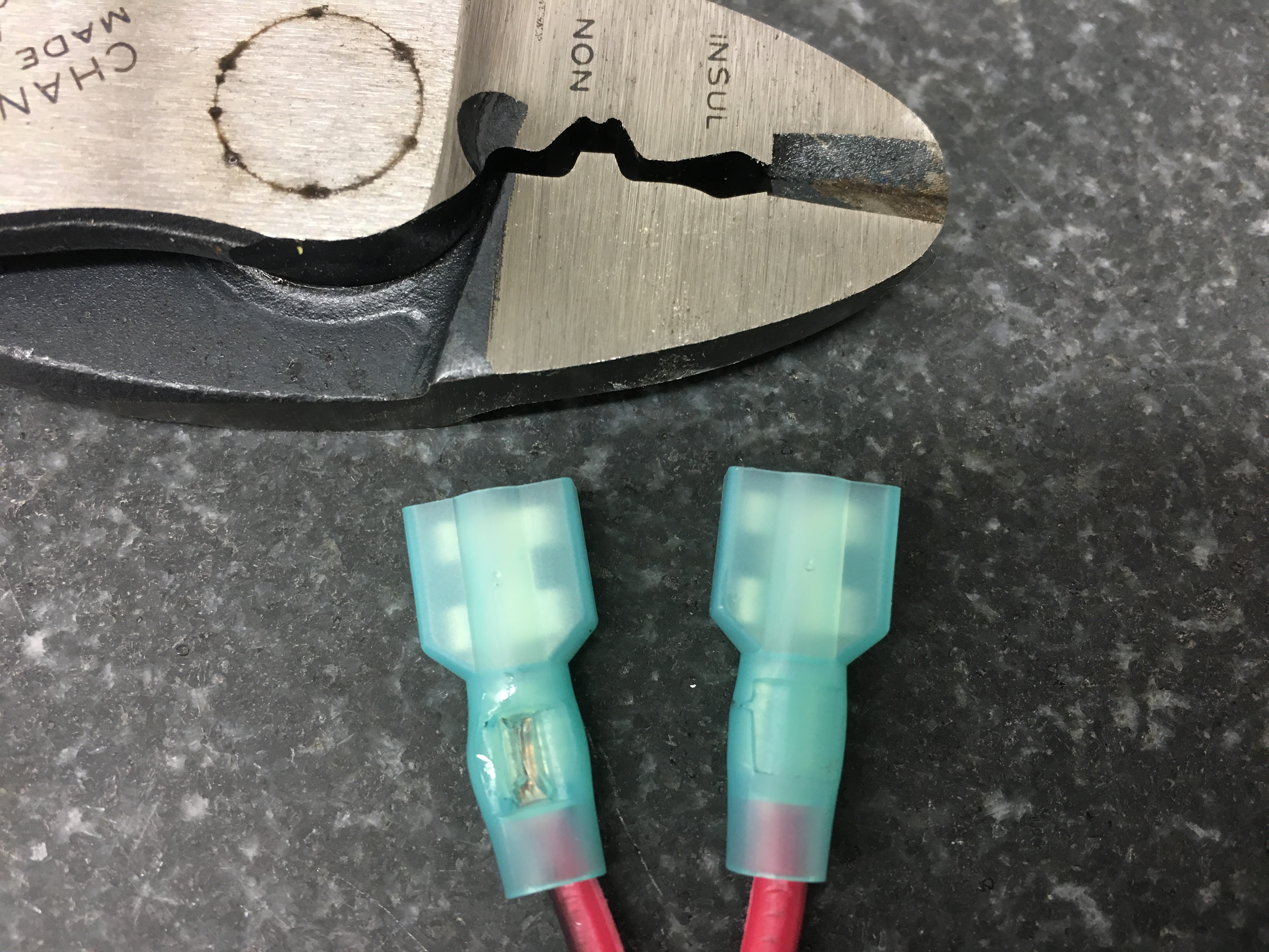

For the splice terminals you want a wide flat pliers. The Klein pliers are a must- but not for those connectors. I have good luck with channel locks, lineman or slip jaw/combination. You insert the wires, squeeze the metal splicing bar into both wires and then close the cover.
Edit- OP- which connectors are you referencing? Half of the connectors would use the Klein crimp style pliers and the other half need a flat and wide jaw.
The male spade joints.
The reason I brought this up in the first place is because from the nylon translucent insulator terminals as opposed to the standard opaque plastic crimp terminals, I've seen pictures of WITH the wires in them, the nylon ones look like they have no crimp (not talking about translucent heat shrink). Was wondering if I'm missing something with these or if they're supposed to be crimped at all or have a special tool just for plastic terminals.
   / Crimp tool #20
I just crimped some with the same Channellock crimper I linked above and took a picture for you.
On the left using the non-insulated part, you can see the crimp well but as often happens when doing this the plastic is pierced.
On the right I used the insulated part, and yes the crimp is hard to see but it's solid and cannot be pulled off with reasonable force.
