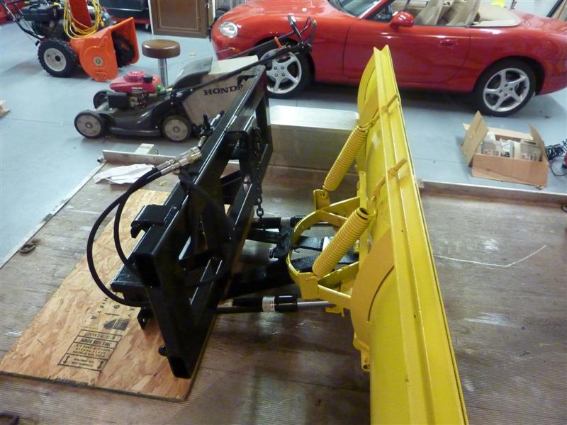

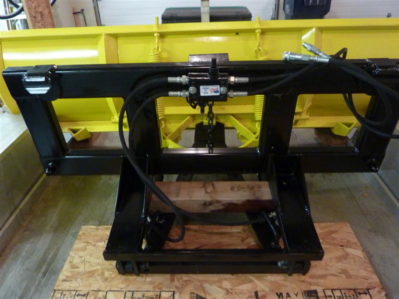

I just got my plow back from being painted....and got my valve from the surplus center and got my hoses and cylinders mounted up tonight. I hope I got the valve installed properly?? :confused:
....will be taking it "up north" to my tractor on Sunday and will post some pics of the plow mounted on the tractor.

One more pic....side view. Pretty happy with the outcome. The plow will be nice and close to the loader masts. :) Hard to get good pics in the garage.

Looks good to me Foggy, I just responded to PM about how to plumb the x-over valves, here is the drawing: http://www.surpluscenter.com/Drawing/DR9-4019-50-H.pdf
Thanks for the drawing. They don't furnish any info with the valve.....but there aren't too many ways to hook things up. I made a few ASSumptions.....and those have led me down the wrong path every now and again. :laughing:
I try to get things done right before taking my projects to my land. When I get there....most parts are hard to come by without a long drive. I'll find out if its right in a few days when I hook things up to the tractor. Thanks for the help Kenny!

nice job foggy, im doing a plow right now for my kubota and would like to ask what width is your plow, did you use 4 inch channel for the main mount on the quick attach? thanks ray
/ Crossover Relief Valve
#9
Ray.....I used 2x4 tube for the main frame....and those rear extending arms are made from 4" channel. The Plow is an ST80" Meyer plow. The plow pins are 12" behind the JD QA mounts to get the plow closer to the tractor. I think I am going to be happy with the outcome. Will mount the plow on Monday and take a few more pics of the finished product.

I recently just bought the same valve for a fisher plow that I converted, very similar build to yours except with a QA skid steer plate. Today just tried to install the hoses with the valve. I a running the hydraulics off a rear remote that is plummed up front with quick couplers. I have tried a bunch of different "plumbing" senarios with no luck at all.
From the illustration it seems that ports B and D should connect to the hydraulic plow cylinders and the A and C should go to the quick coupler (rear remote). When I set it up this way pressure builds and then hydro fluid releases from the quick couplers.
How did your plummbing set up work? thanks Mike

Sounds like you have it hooked up correctly. Does your blade have two SA cylinders?
/ Crossover Relief Valve #17
Each plow cylinder has one port on the end so they are SA, maybe I have a faulty cushion valve? The tractor is new so I hooked up my grapple to make sure the rear remote valve was working properly and that worked perfectly. The grapple does not have any cushion valve just two SA cylinders that open and close.

I just spoke with a service tech at Prince and they told me that this valve will not work with SA cylinders. I explained the application as well as how I plumbed the valve and they verified that it would not work on the SA cylinders.
Let me know how your set-up turns out. I still not convinced that I have it right? Thanks. Mike
