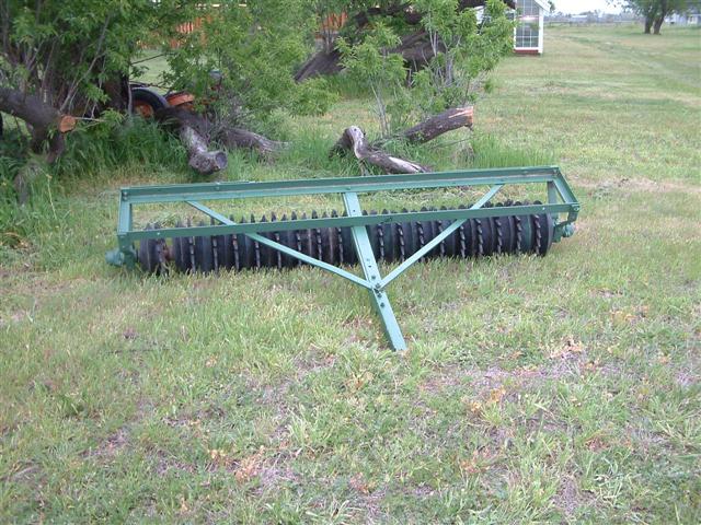

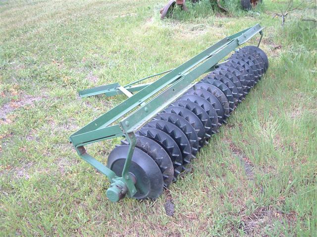

Bought this one locally for $600. It's about 10 ft wide.
Material to duplicate it probably would run $300-400 (new).

You got a good deal at $600. Looks good. The last new wheels I ordered from Brillion were about $70 each + shipping. Ken Sweet
Brillion--the high price spread:D. What's that like $1/lb for those wheels?
