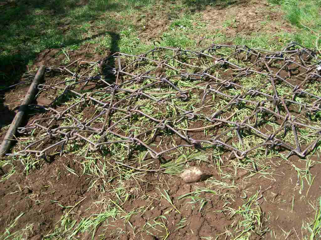

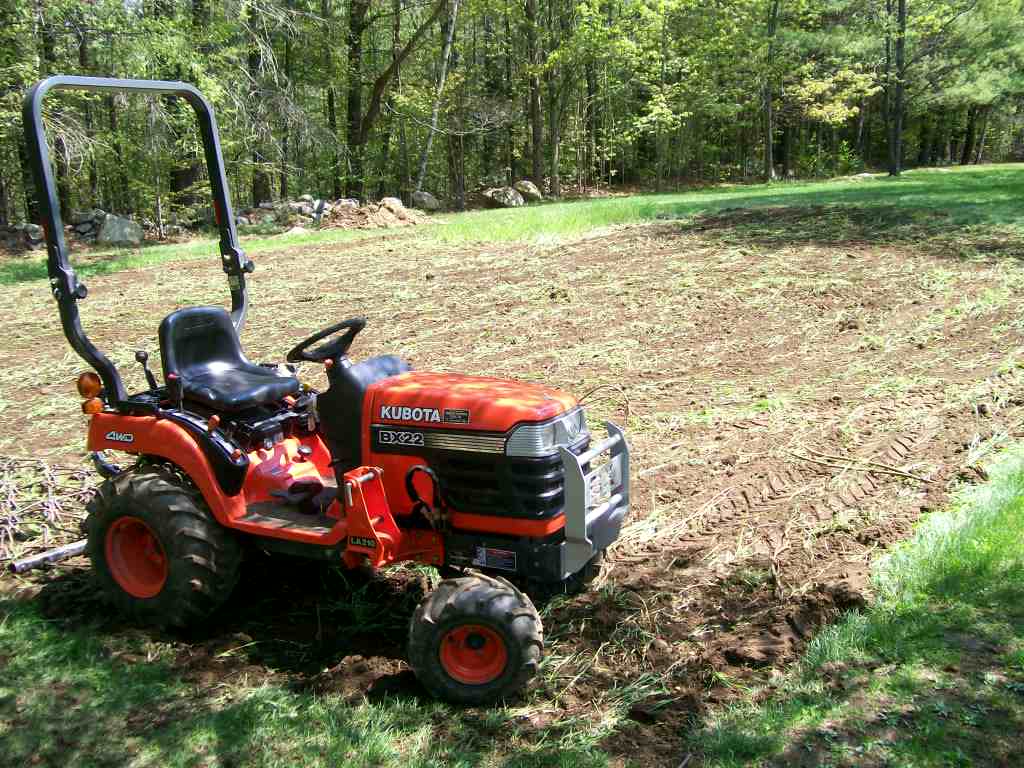

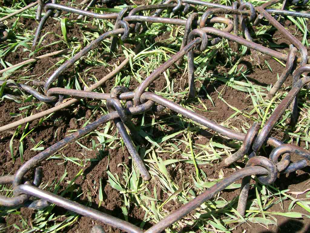

Don't laugh at the size of my operation here, but I did find that my chain harrow broke up clods better than I thought it would.

Clay based soils sure can be a challenge to work with at times. I agree that timing is very helpful. Actually, the soil in my pictures was / is clay based, but I've put hundreds / thousands of bushels of organic material (mostly leaves, and green crops like the rye in the pictures) in there in the past 20 years, or so, and it sure has made a difference. It used to get pretty hard, and crack when it dried out any. I've been in your part of the country, and do know that you have more of a problem with that than I did / do!
