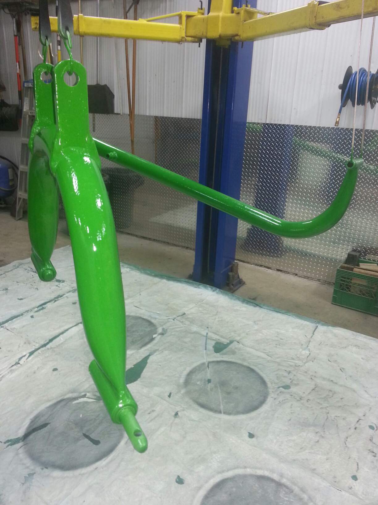

I finally found a Danuser auger for sale and it was only 2 miles away.:) I have been looking for an auger for over a year when this F7 came up for sale locally. I called right away to go and pick it up. It only came with 1 12" auger and needs a little TLC but it is a Danuser. I have it all taken apart and sandblasting all of the frame for repainting. I will post some more pics along the process. I would like a large auger as I have a lot of trees I would like to plant.

I got the frame sandblasted primed and painted this weekend. Looking into the updated driveshaft with the updated safety guards. auger primer.jpgauger paint.jpg I cant not find new U=joints to fit the orignal shaft and need some seals and other parts anyhow.

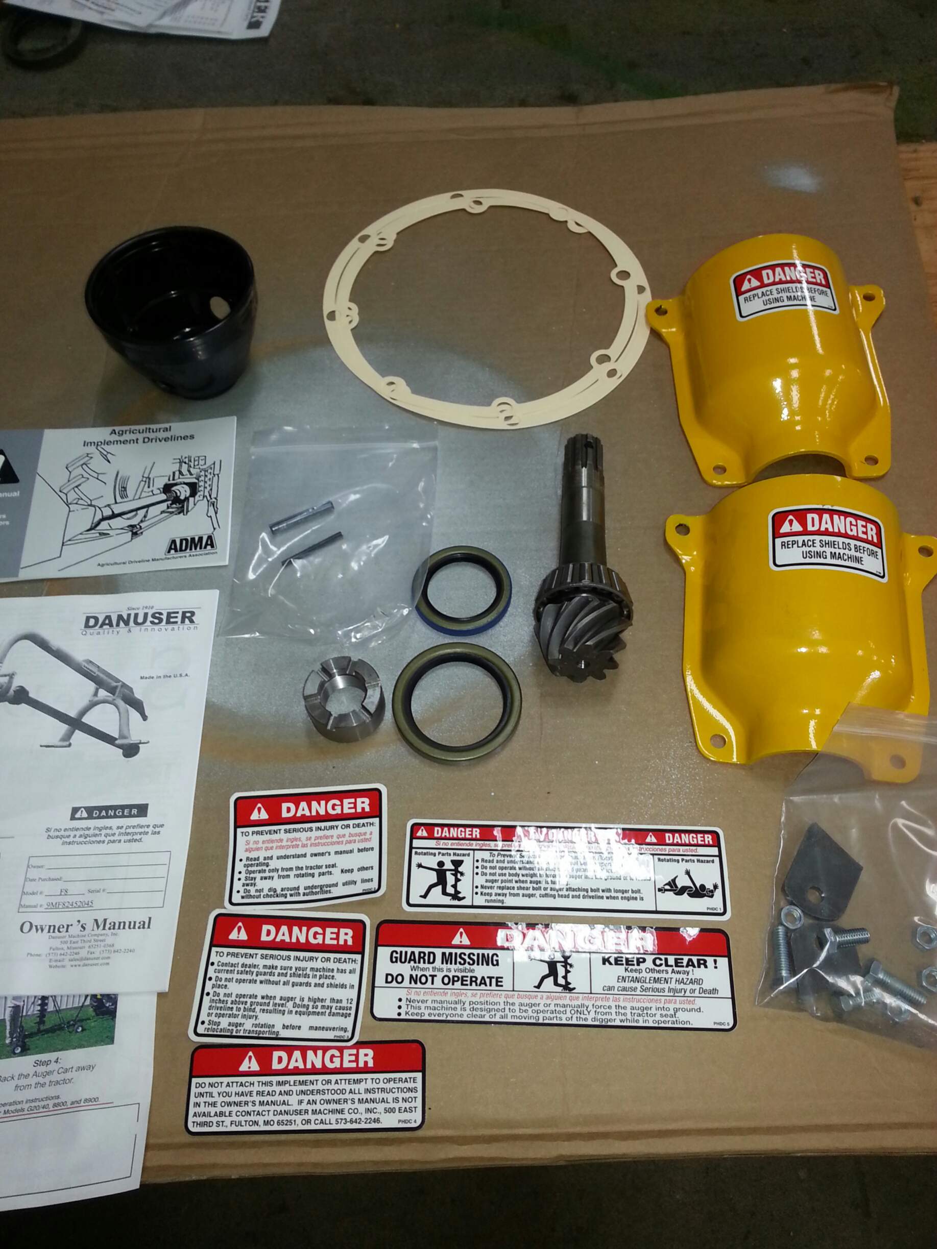

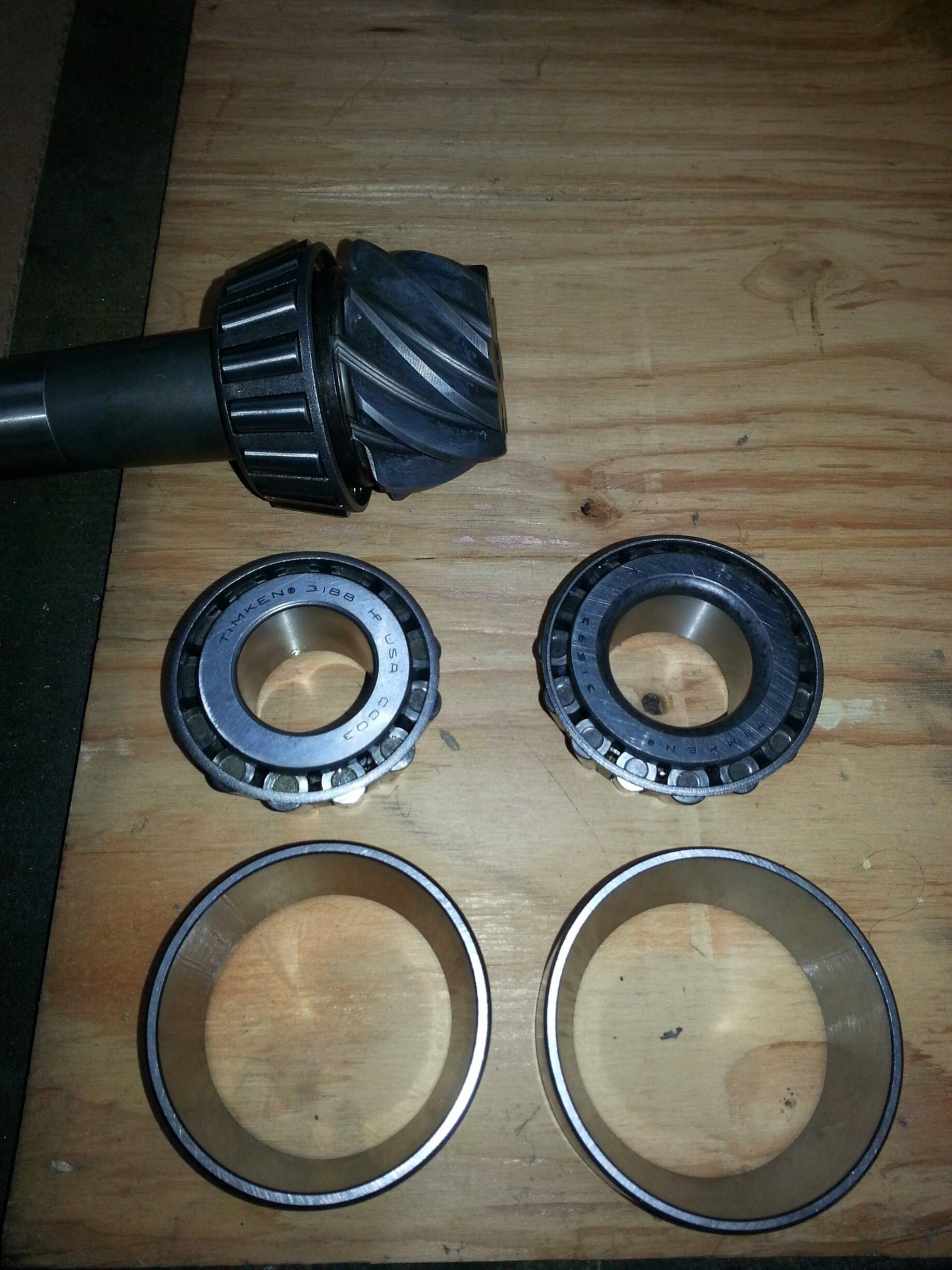

I ordered the complete F8 update safety kit for my auger and have it all back together and it is working perfectly! When I disassembled it the 2 bearings and races on the pinion where corroded from water penetration so I order new bearings and races from the local bearing supply. The update kit arrived and the 1 bearing came on the pinion so I have a spare bearing. Wasted 38 bucks.

ok, I am seeing your post here. So i may just have to order 1 bearing.
