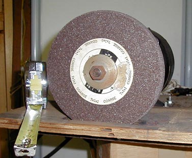

It is something I do fairly often. And think about even more! My wife runs a commercial Lawncare business so I have plenty of opportunity.
I currently sharpen in a big vice, with the 7" grinder. Grind the blade straight on the face first, remove the back side burr, then grind the angle onto the front. Burning occurs occassionally when I get in a rush. Light cuts and a practiced hand make it go pretty quickly.
I have been eyeing a Magna Matic for the last several years, but the price covers an awful lot of my time.
A bench grinder is not the same, as it is a low speed wheel designed for high removal speeds.
It really comes down to how much you are sharpening blades. My case is I should do 12 blades every other day or every third day, and realisticly do the 12 blades once a week to week and a half. I teeter on the brink of it being cost effective to buy the Magna Matic in my opinion. Anything less I would not bother, anything more and I am shelling out the bucks.

/ Dedicated Blade Sharpener #20
Bob'nMN
Dug my grinder system out for a pic, and will attach. I don't find it makes a big difference which way the blade is ground, but did have to go to a courser stone (7") than the original I bought. This one is about right, and it is helpful to have some water to cool the blade between passes. If dinged up real bad, it takes a while to get the notches out. But this system keeps a constant angle which I like, and is easy to do. The plywood 'table' is probably temporary, but has done ok for a good number of years now. Just lay the blade on the plywood table under the stone and draw (or push) across the wheel edge. Any burr can be taken off by standing the blade on edge and lightly drawing along the wheel.
