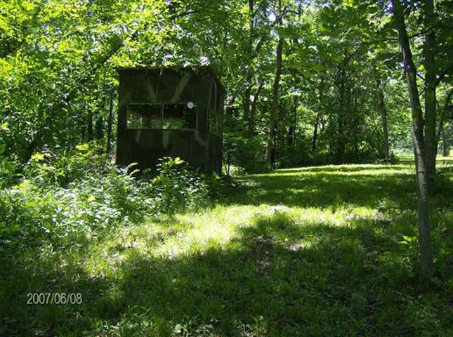

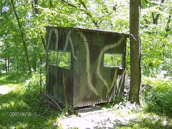

I prefer to have mine elevated by the use of high ground! 6'x6', mostly used materials, also makes a good winter "break room". ~~ grnspot

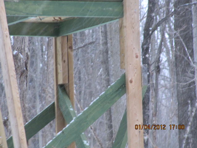

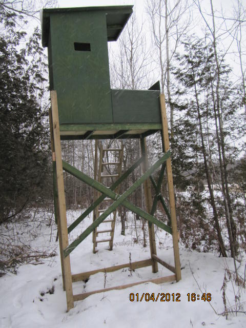

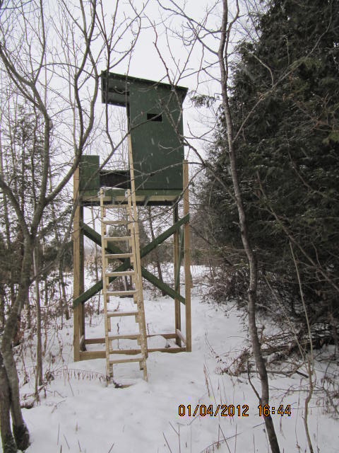

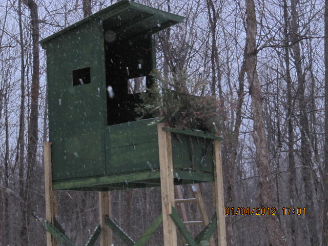

I have built a few, will get some pictures next time out and send some. In my experience, I can build for much better for less than a store bought ladder stand. Using new, diminsional lumber and common tools, have built a 4'x6' stand on 16' legs (2' buried in ground for stability) with deck about 10' off ground (I use remaining legs above deck level for wall supports) for under $200.00 (included roof, walls, ladder, hardware and preservative stain).
I have also built using cedar logs to save money (from my own bush) but that does make it a bit more difficult to assemble.
   / Deer Stands #8
as mentioned...
I use these for bow hunting so wanted an open deck area. For gun hunting, you could enclose more of it, add a shooting rail, etc.
