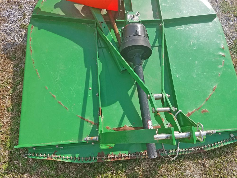

I am a little issue shy about Deere mowers,,
This one was setting on a Deere dealer lot in the used equipment section yesterday,,,
NOT the scrap section,,,
What in the world happened to it? and why would they try to sell it?
That dent circle went ALL the way around,,,:confused2:
That type of damage is pretty common on cutters I've seen. Sometimes a rock gets stuck between the blade and the deck. Sometimes it's a bent blade. Never had it happen to me, but I've probably seen more used cutters than not with that damage.

Yeah, extremely common in my experience and not a Deere specific issue, Wood, LP etc all will do that.

The only thing that would concern me about that is the mx7 and most of the Deere shredder lines are double decked. If it damaged the top skin, it would have completely trashed the interior piece. My mx7 was two pieces of 10ga with a space between them if I remember correctly

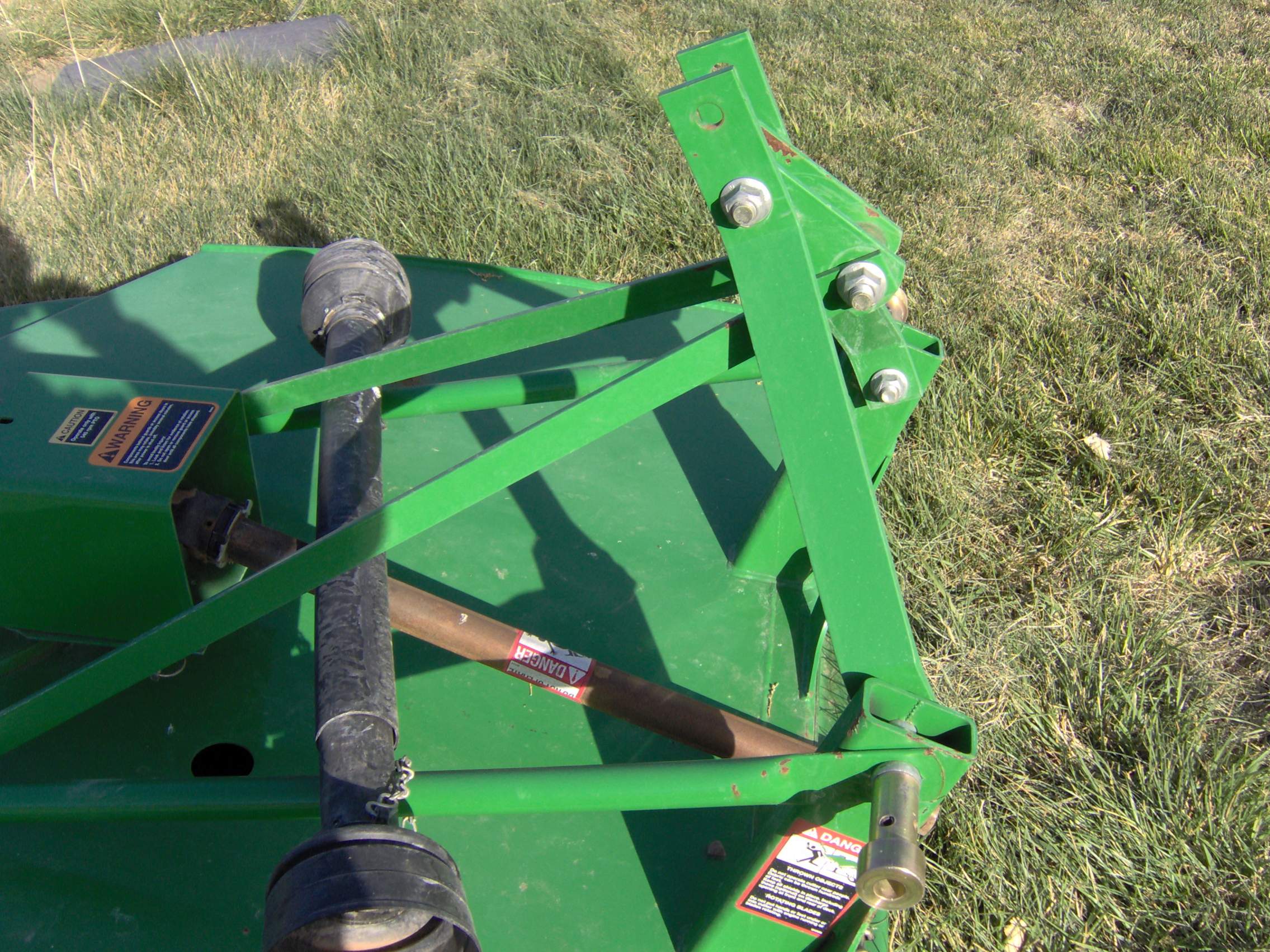

What model was the mower? Just looking at a picture of my MX6 makes me think this was a light duty cutter.
