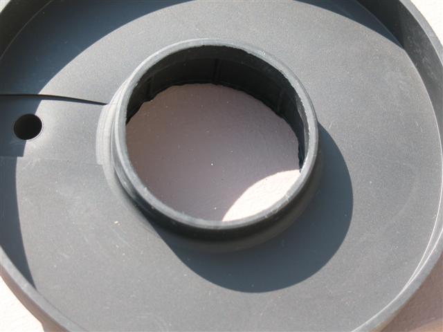

Are they all splitting like the one in the picture? That looks like a stress crack from being too small.

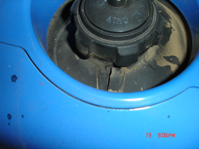

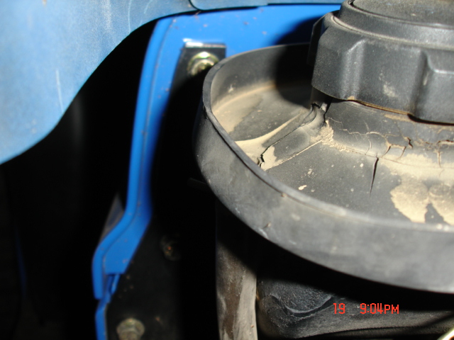

Here are some pics of the deteriorating rubber around my fuel cap:

   / Deteriorating Filler Cup TC34 #46
Hmm.. that looks thin. On my 7610s it is thicker and 'appears' to have fibre imbedded in it.. ( kind of like those rubber feed buckets for farm animals.. uh.. fortiflex.. etc.. )

   / Deteriorating Filler Cup TC34 #47
johnnylight said:
Is it possible the hood or some sharp object is rubbing on it or maybe the fuel cap?
am going to examine mine in the am.
yes I do question myself at times.
Rubbing or a sharp object definitely did NOT cause my filler cup to deteriorate. In my case, it developed cracks around the drain hose fitting, and started leaking when I spilled. I tried to reposition it one day, and it just split from the filler neck to the outer edge, making it useless. After I removed it, you could tear strips from it like a sheet of paper. Because my tractor stays in the weather 95% of the time, my first thought was that the material used to make this thing was not capable of withstanding the sun, and just rotted.

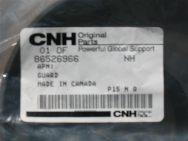

   / Deteriorating Filler Cup TC34 #49
New replacement 10/4/07

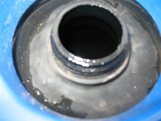

   / Deteriorating Filler Cup TC34 #50
10/9/07 starting to tear.
check out the new TC34DA at the Dealer they have the same tears going...
