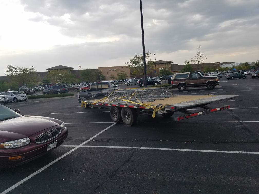

I've been happy with my DiamondC otherwise. Wood decking is a little soft & I really need to seal it up. But the trailer is sollid. Pulled great behind my Tacoma when I was getting 500lbs of ham radio tower. Was a much nicer drive than the F250. 20180618_122125.jpg20170909_182516.jpg

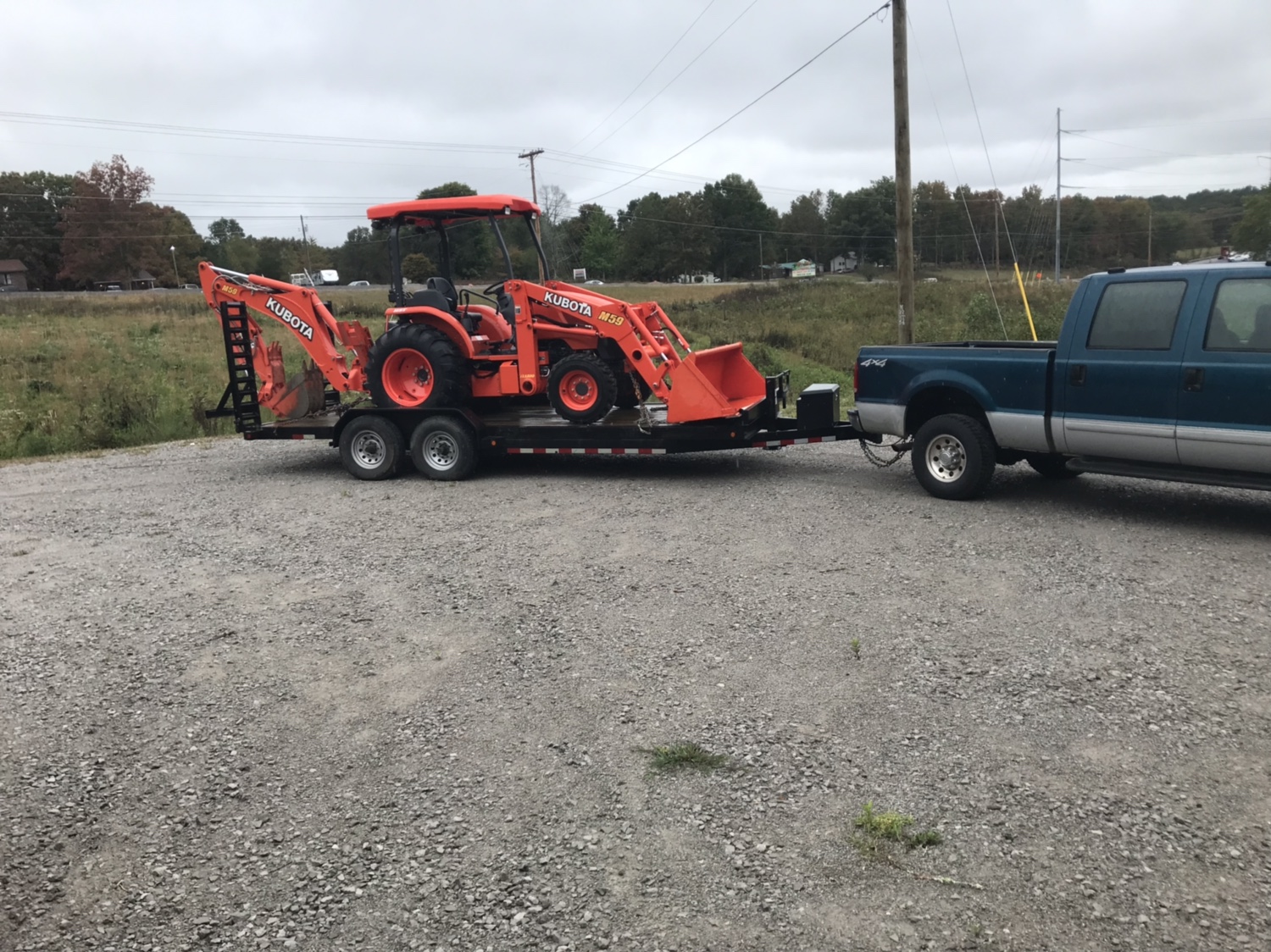

I like that trailer! It fits your L4060. How long is it?
A 20’ is too short for my M59. It needs a 22’ minimum 25’ being ideal. If you don’t have a backhoe a 20’ is probably enough. This is a 20’ pictured.IMG_7631.JPG

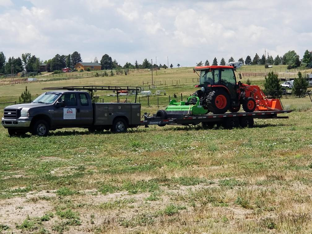

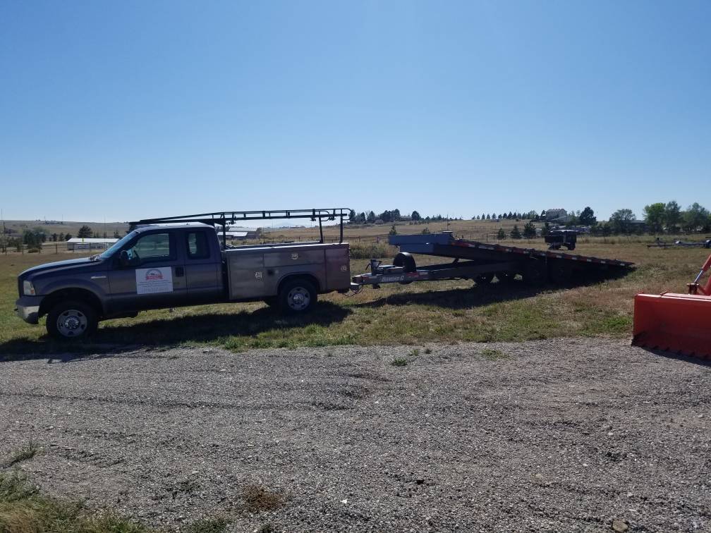

22' deckover power tilt. I'm not a fan of the deck height or the deck angle required to load or unload. But it means no fenders to deal with. I couldnt fit my flail mower between fenders. Also no fenders or other obstacles to deal with loading non vehicle stuff over the side.
22' will fit a Grand & impliment easily. An extra impliment gets pretty crowded but is doable. You loose the last few feet of the deck as usable space on a gravity tilt due to ballance issues.
I miss the low low deck on my old 16' gravity tilt. But it was way to short. The super long tongue was the only reason it kept working as long as it did. The ease of loading & determining ballance was undeniable though. I assumed I was going to replace it with a gravity tilt with a small fixed front deck. But I ended up with the deckover power tilt instead. It's a compromise & not always ideal, but on the whole has been the right choice View attachment 62634620191002_143926.jpgIMG_20140209_110007-2.jpg
