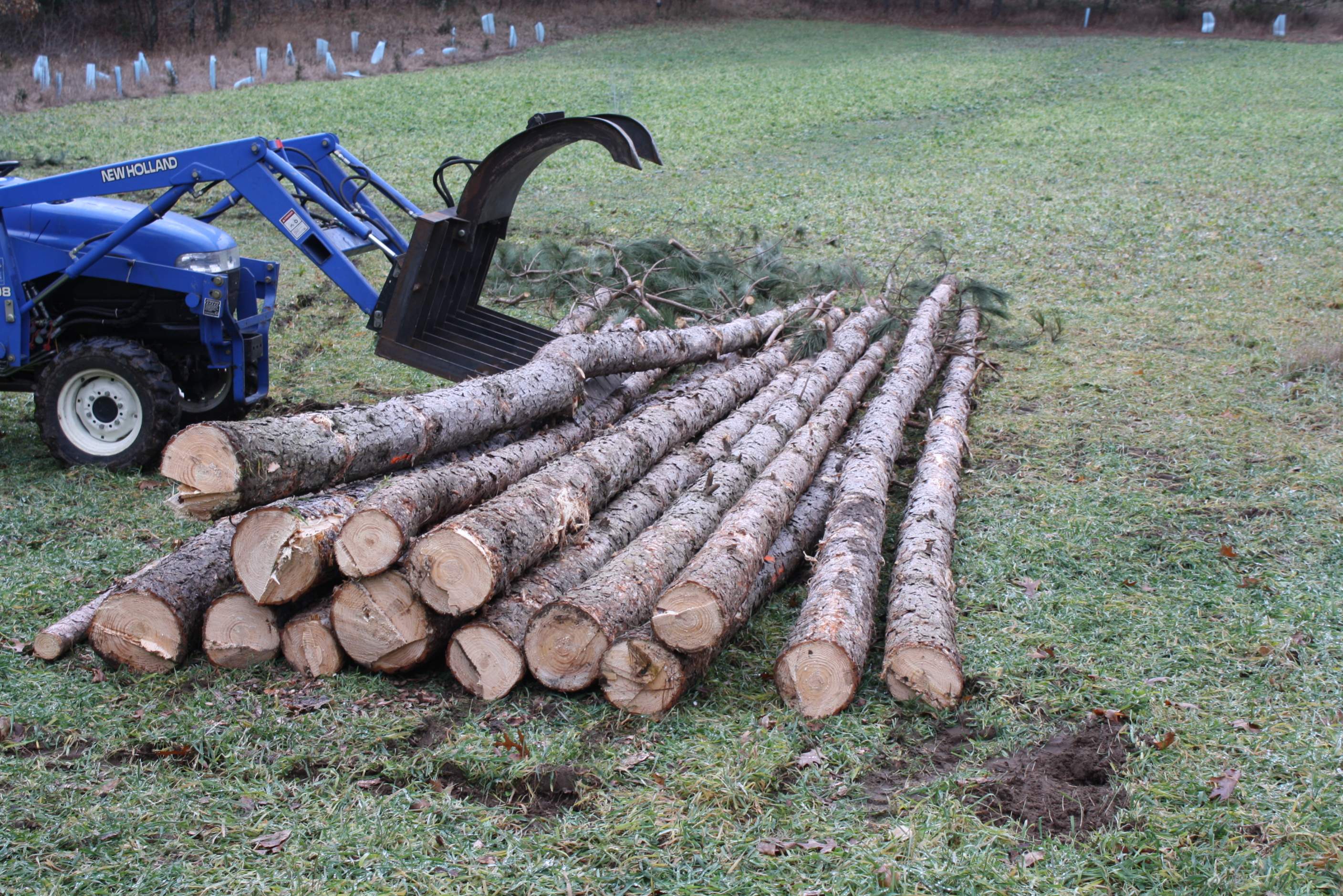

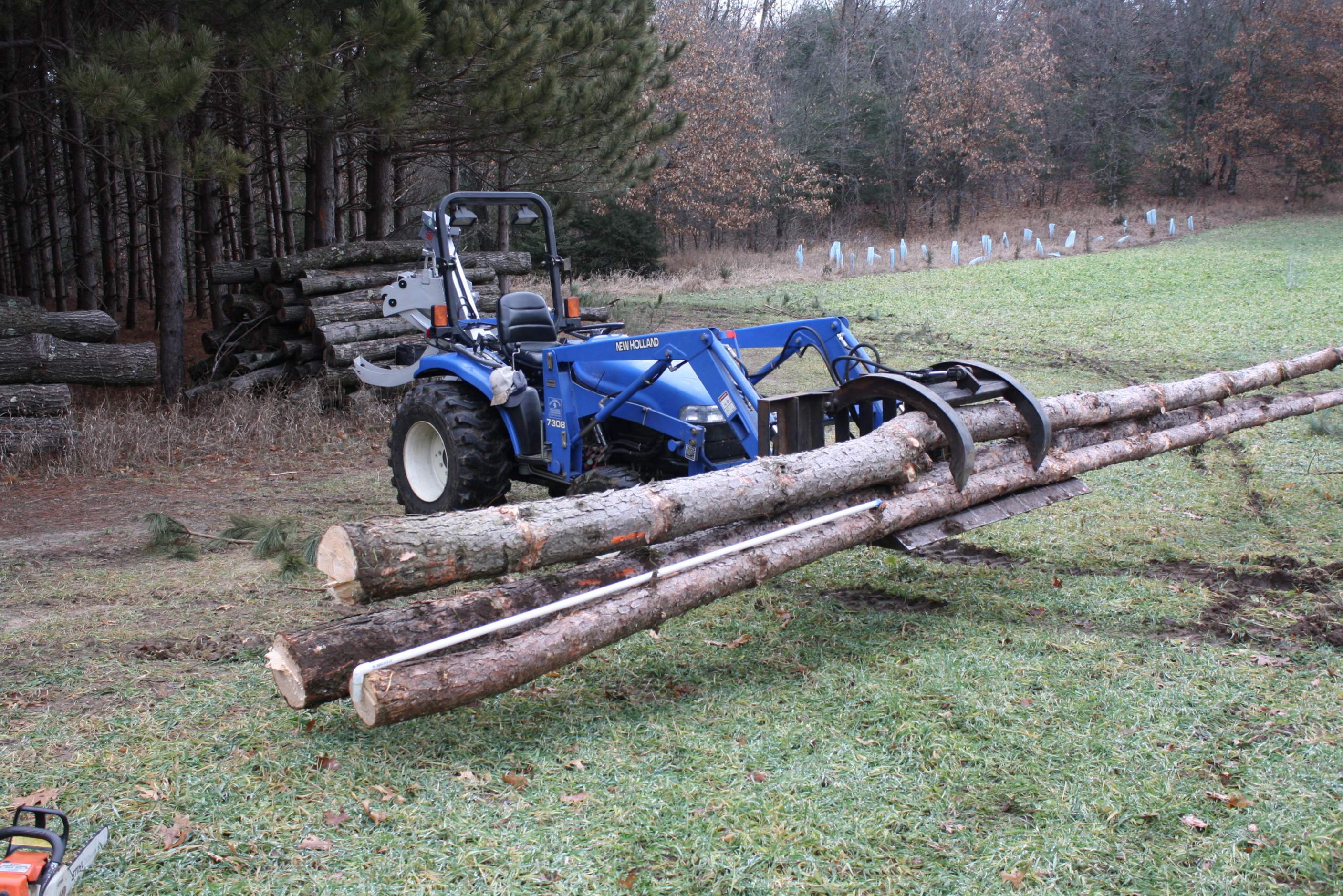

Very professional. I wish I had the patience to do wood mockups like you did; my stuff would not look as good as yours, but it would look (and work) a lot better than it does.
Send us some pictures of it in action.
   / different kinda of grapple
#23
Great job Looks Like factory built
I have been gathering info on and off this year ,on building a smaller version of the grapples I see on the internet.. I actually met with my welder friend yesterday. This is insperation. I will have somthing to show before spring. Mine will be much smaller though. Just for say 16 inch butt and down is all i need. Do you know how many pounds of pressure you have on the log grapple cylinder?
Thanks, I don't know what the pressure would be. Its a 2 1/2" bore, 3000psi welded cylinder. What would I do to check the pressure?. I would highly reccomend the boom swings side to side if your building one. Alot of the ones I seen didn't and after using for a few hours yesterday it came in very handy.
#24

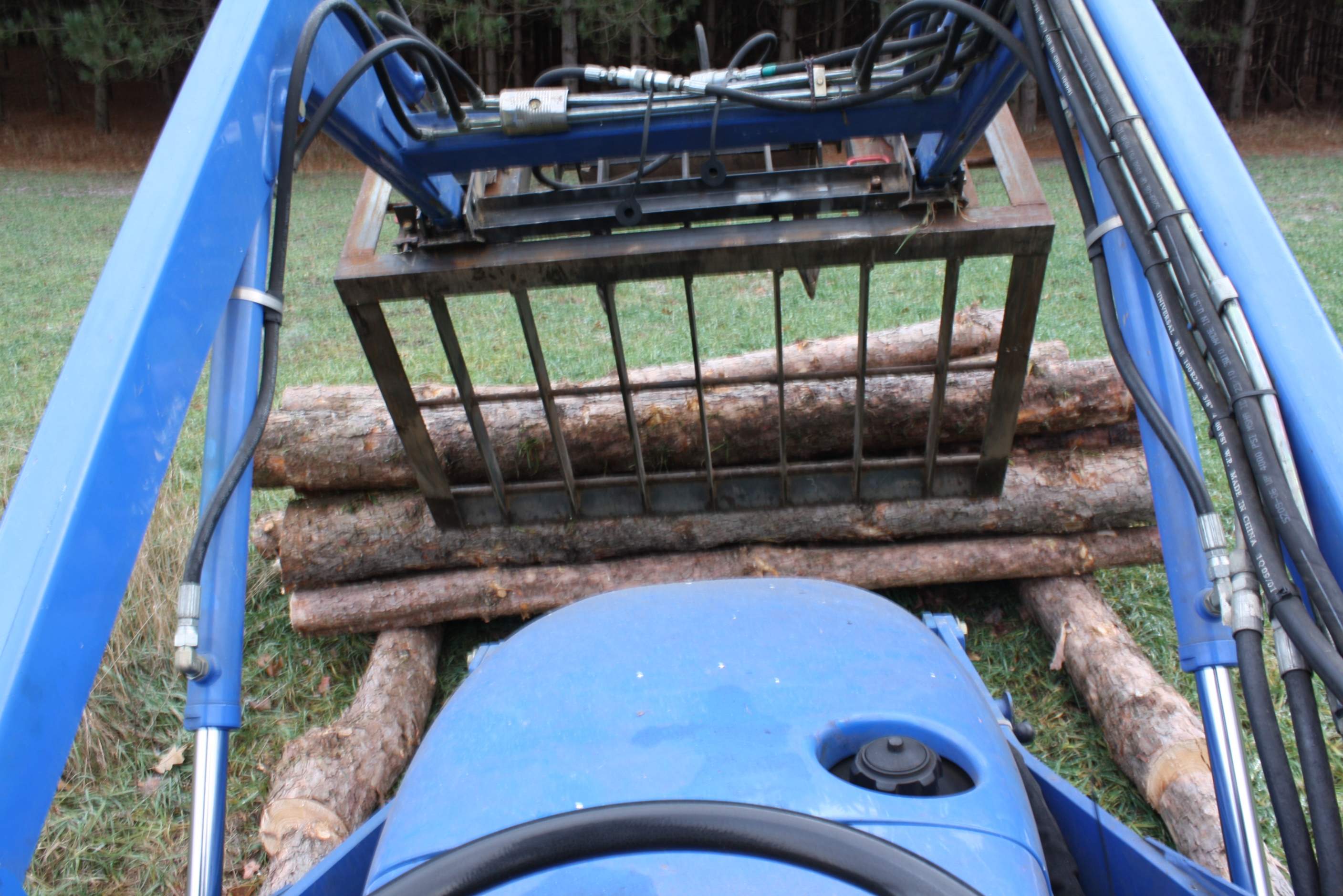

That looks great, very impressive! What is the thickness of the steel used? Can you please add some photos of your grapple? Thanks, Stanley
I used 3/8" for most of it. The boom is 1/4" Heres a couple shots of the grapple. I posted some on here last year. I dont know enough about computer stuff to put a link to it, but I guess if you search my post it should work.

Very impressive!!!!!!
I'm looking forward for some pics of it in action. Do you have any steering problems or need for more weight up front? How about a video on youtube?
Thanks for sharing,
Eddie
Was out with it yesterday, but forgot to take any pics, tommorrow! youtube video my be above my computer illetirate technolgy challenged ability:confused:
I figure wood is a lot cheaper than steel, and easier to work with!
Im a paramedic by proffesion, a woodworker by heart, and a wannabe fabricator on the side pictures coming.
Thank you for the info and pictures. Looks great!

Is this your own design or did you copy some one elses. I call it R&D rob and duplicate. Verry nice work.
Bill
