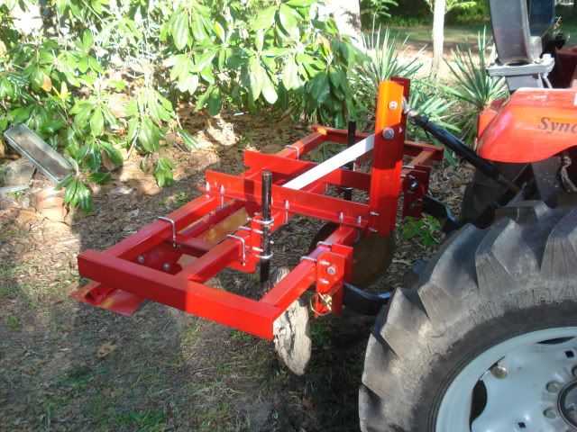

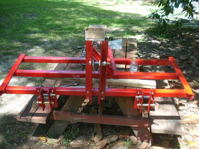

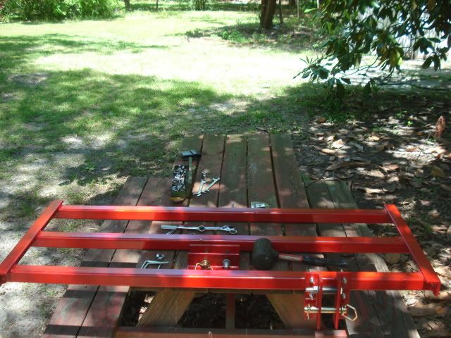

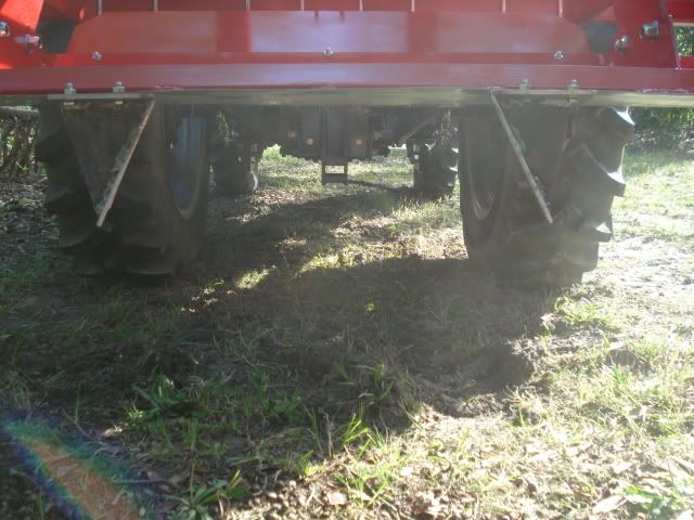

Seeing the pics reminded me of why I got rid of my Disc Hillers and built this instead:
That really looks good and simple too. I see you paint your designs to match your tractor too!!:cool:
I finally got the head of R&D involved in my design.

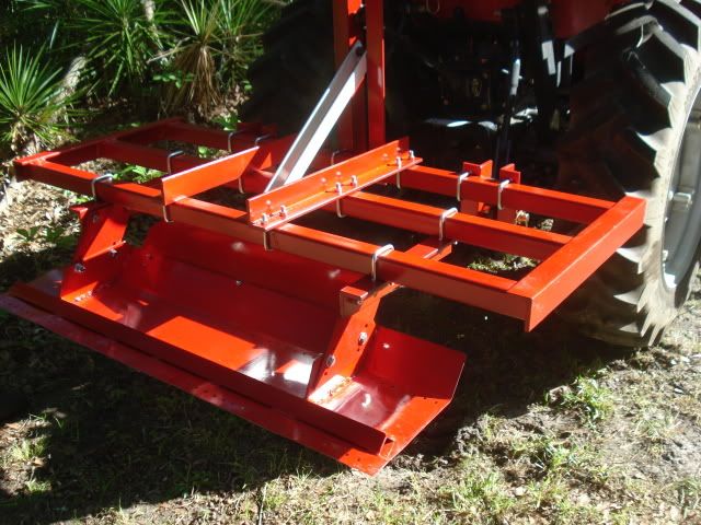

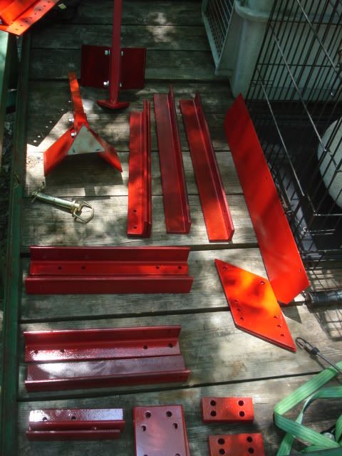

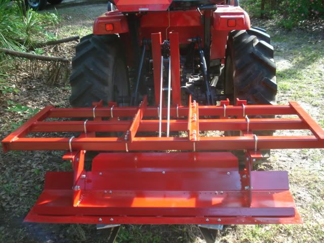

Would you have pics of your forming pan or is it just a "flat pan"?
Updated pan design change - Riv-2.1
I did not get to the farm this weekend as I help the USFS once a month and this was the weekend to help out. I did get a chance during the week to upgrade the chutes on the pan as I brought it home from the farm. I made them longer and higher to catch more dirt. Hope to try it out next weekend to see how she does.

I am now contemplating a modded furrower,
thumb.php
feeding a disc(s), then to a forming pan.
I'm interested to see how your Rev.2.1 works.
I should add that putting a large weight (approx 200 lbs) helped alot with my limited trial yesterday.

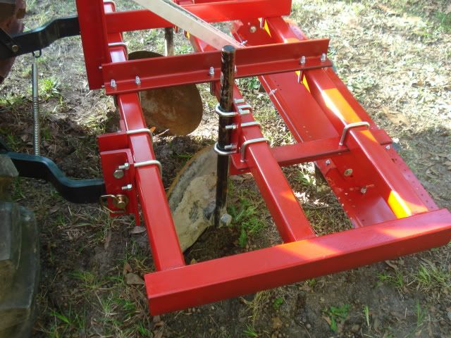

Well my upgrades did not work as well as planned but after many adjustments I finally got a few good looking rows. I should of left it alone, Soil prep is everthing and boy could I really use a rake to get the grass clumps.
Here are some updated pictures of my result as well.
Here are pictures of what I did 2 weeks ago on my first test run and their results, my peanuts are looking good.

I'd like to see more information on your bed former pls. What did you use to hold the mold boards? It looks like a cast piece. Do you have any measurements for your mold boards?
