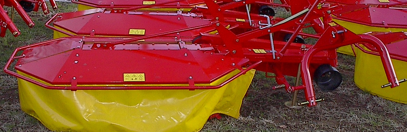

You can purchase a new CCM 165 drum mower ($3,000) for less than a AS IS USED Disc Mower. The CCM drum mower is designed for your size tractor. It will mow any crop in any condition as fast as you can ride your tractor. We have been selling this design since 1982. Thousands of these drum mowers ar sold each year around the world.
