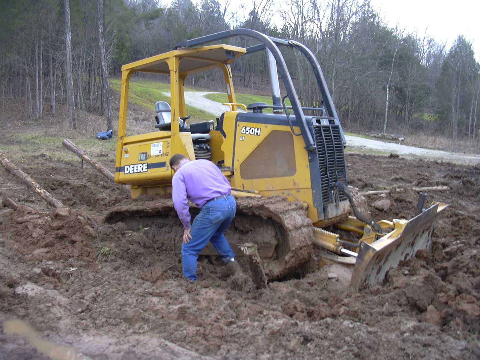

Speaking of too soft .... the top 12" was pretty solid and came off just fine. But when I scraped beyond the top 12" I found the bottom 48" was a mucky mess. It took three tractors and a lot of digging to get this one out.

   / DISCOVERYS OF UNSAFE TRACTORING PRACTICES #34
KEG
OOPS, that looks like quite a mess.:eek:

KEG said:
Speaking of too soft .... the top 12" was pretty solid and came off just fine. But when I scraped beyond the top 12" I found the bottom 48" was a mucky mess. It took three tractors and a lot of digging to get this one out. KEG
KEG & Eddie, Next time, and you know there will be a next time, put an 8"+ diameter log cross wise in front of or behind the tracks & hook it to the pads with a short chain or cable. You'll drive right up onto it, a few more logs 2' apart will pave the road to solid ground. My cable D7 has been unstuck this way several times. Just make sure the log is thick enough not to break. You have the added advantage of blade downpressure to lift the front. I'd have driven KEG's dozer out in 1/2 hour easy, Eddie's would take a little digging to position the log. I keep two 1/2" chains with homemade grab hooks at each end on my dozer all the time. The hooks have a throat deep enough to slip over the end of the pads. The chain will pull the log under the track rather than the grousers slipping. When on top of the log just remember to stop & unhook the hooks. If you're buried deep remember that the drawbar may extend beyond the tracks & the log will hang up on it when backing. You can guess how I found that out, D7's have pretty good torque & will break a 10" oak!!!! MikeD74T
