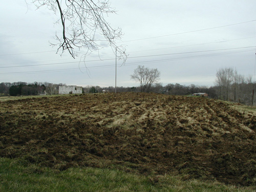

Let me see if I understand the facts as laid out in this thread: Tilling can eliminate the need for running a disk harrow through the area? Last weekend I went through 2 new acres of ground where I'll be putting in 1500 grape vines with a Deere 650 'dozer with three 2' sub-soilers/rippers attached to the back (see photo). Given this, do I still need to disk, or can I go straight to tilling? I hit clay-like soil after about 12" depth, if that makes a difference.

I've read quite a few posts where guys use their tillers to do this. I'm not sure my tiller will be up to it, but I'm going to try anyways because that's what I have and the price of a disc kind of freaked me out.
