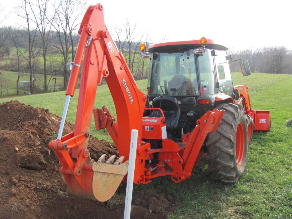

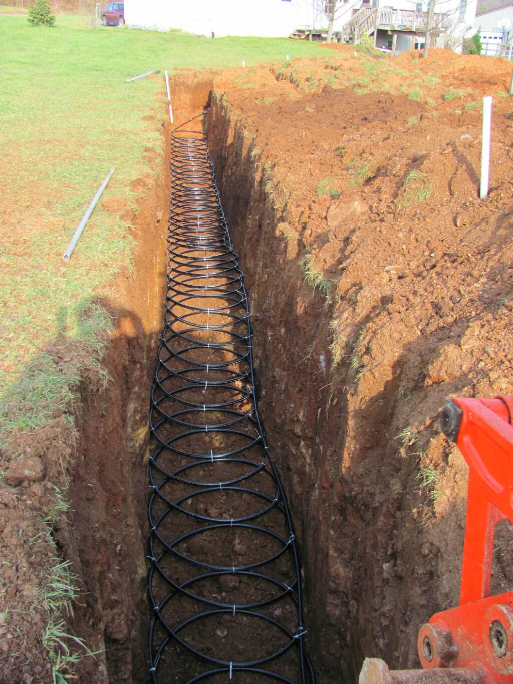

I bought my BH92 for that very reason. I dug 5 trenches 70'x3' wide for slinkies. 18" bucket. Do not remove soil first, it will make it worse. Did not take too long. Doing the geo install myself instead of "farming it out" paid for the tractor and backhoe.
View attachment 579832View attachment 579833
I had the predecessor of the op's 1710 (gc2310) and your bh92 is different level machine that would be successful for the project.
Best idea as op and another poster said is dig a test trench/hole 6' deep. You will experience the difference of task from digging a 2 or 3 feet deep trench with your machine.
Reread Digginit's post...take that advice in consideration too. Post what you think after test hole. If you're still confident...I guess go for it! If not, rent an excavator.
On last thing, can you dig and add coil(s) with these systems piece meal as you go along or does whole 600' need opened up with pipe installed at one time? Might be safer that way with extended time to open 600' of trench.

Looks great how many ton unit did you put in? what MFG did you go with on the Geo unit?
How deep did you dig?
Comfort Aire units by heatcontrollers., same as climatemaster unit, same control boards.
I put in a 3ton and a 2 ton. One 70' trench per ton. Mine are 5' - 6' deep. Did one at a time, in parallel. Digging the next trench, piled top soil between trenches, then filled the other trench as i went.
