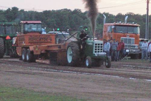

I am new to this forum and found this thread while searching the net on ways of building a homemade tractor. I am very impressed with the tractor that GT2 is building. I want to build a similar one. I have an Oliver pulling tractor and I want to build a small version of it to tow my puller around at the pulls. I would like to make it look very similar to my puller except without the rollcage. I also want the small tractor to be 4 wheel drive so that it has an easier time pulling my big tractor that weighs about 8,000 lbs.
I bought an 88 Suzuki Samurai for $200.00 to get my axles and drive train. This samurai runs but needs carburetor work to run well. This question is mainly to GT2 but others are free to reply as well. How would it work to use the Samurai engine, transmission, transfercase and axles? Would it be slow enough with the transfercase in low range? Our Sami doesn't run well enough yet to see how fast it does go. How short could you make the tractor using the whole sami drivetrain?
I also have another problem. My 13 year old son has taken to the sami and wants to jack it up and make a mudder out of it. I hope that once we get it running and he runs it around the fields for awhile that he looses interest in the mudder.

OP, My tractor has a 6' wheel base. I could have used the sami trans and transfer case but it would have had to been direct coupled to the rear diff to keep the tractor short. Also the whole drive train would have to be lower in the chassis to couple to the rear diff ( might not be a problem for you), resulting in less ground clearance.
The gear ratio might be low enough for you depending on tire size. There are aftermarket transfer gears that will lower the ratio a ton.
You will have to use the same tire size front and rear unless you change the rear diff ratio.
Assuming a solid axle mount, what about running a chain and sprockets from the transfer case output shaft to the pinion yoke? This would raise the ground clearance and allow one to change the gear ratio on the rear axle to compensate for tire size differences too
