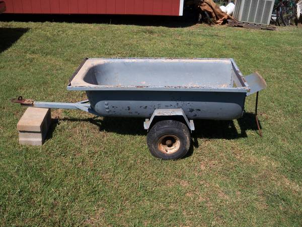

I built this using scrap material... dunno what to call it... diverter, deflector, diffuser, director,... whatever. It's to dump the load pass or driver's side. To be installed before filling. Figure it'll save me some shoveling. It's going to be bolted on at the front using a single wing nut. I'm not worried that it's not pressure treated as it'll stay in the shed when not in use.
Used the rest of that can of rust check... man it didn't go far. I guess I'll need at least two more.

Worked on the fenders. When I made them for some reason I thought I wanted the fenders and extensions seperate... but I never had an instance when that was needed, so I;
Welded them together.
Primed the welds.
Seam sealed between them.
Rubberized undercoated them underneath.
Painted the extensions black
and painted the fenders body color. I'll give them another coat before calling them done.
I won't bother with clear coat on these, as they'll stay on a shelf in the shed until it's time to hit the road, wich is rare.

Put 4 more lag bolts in because the puck board was lifting in the sun and tearing the seam sealer out... hopefull this will force it to lift in the middle where it won't matter as much.
Started fitting cheater boards. 2x10, so it gives me another 9" where the sides are just 18"
Here's how the ends are going to be held. They're from PA and seem to be pretty beefy
Dunno if it'll be useful, but the gate can lower with the boards in place.
Re-seam sealed before being done for the day. That's it until I get more hardware and paint.
Oh, before anyone asks; this is just for lighter stuff... branches, bark mulch, maybe even firewood, but never rocks, gravel, or dirt.

Took it through the "Property line" trail for the first time today... well one length of it at least. The trip was just to see if it fit, and it kind of did. I'm going to tweek it a little to work better. I picked up a load of firewood on the way through.
I'll hammer out the part of the rock under the tire
I cut this big pople earlyer in the spring and placed it when I went through in a previous pass today to act as a retaining wall.
Ready for gravel!

Finally made it to the quary
V8 TJ dumping trailer - YouTube
Load #2
The square tubing doesn't hold much back
Dang it doesn't go far :(
Jeep and trailer worked great. The springs settled 1.5" on the trailer with the bigger load.

Well most of what they see at those bins are guys filling pails in their minivans. The policy is that they don't load single axle trailers, because the loaders have 10 yard buckets... and I hear some small trailers have been destroid there in the past. If I went down the road where they have a skid steer, it would cost twice as much.
The 2nd load took two hands on the jack for the 1st 1/4 of the way until the weight shifted back. Watch the hitch in the video... you can see exactly when that happens. LOL
