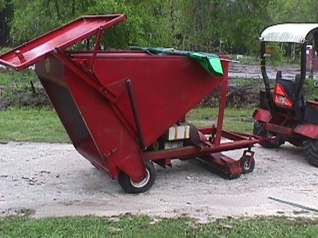

If I were in your shoes - and I sorta am (4 or 5 acres of lawn, probably not as many trees) I'd be trying to find a used Giant Vac Trail Vac, as pictured below.
I have no personal experience with them myself, but have been looking at them for a long time and have always wanted one. I don't believe they are made any longer by Giant Vac (except for one similar model that is huge and meant to pulled behind a pickup truck) ..... but I believe several other professional turf care companies make similar units, Toro being one:
Toro Sweepers & Vacs
Most of the specialized turf equipment is probably going to be very pricey - so looking for something used would be the economical way to go. The other alternative is is copying the design and making one of your own, if you have the equipment and skills to do that.
The benefits of Giant-Vac Trail Vac type unit is:
1. Large capacity.
2. Can be used as sweeper with wide vac head or adapted to the discharge chute of mower deck.
3. They appear to be designed so that they will dump very, very easily. This is a really big deal - if you are doing large areas and have to dump the unit repeatedly. If your yard is so small that you only have to empty the unit once during each use it ain't as big a deal.
I have a large trailer-type Trac Vac (Palmor) - in terms of design it is absolute junk - the unit is not high enough off the ground to get sufficient dump angle to easily empty the load (particularly with grass, somewhat less with leaves) ..... and it requires alot of effort and digging with a rake and/or pitchfork to empty (something I had to do somewhere around 20 to 30 times the first time I mowed this year)
A TBN member, sandman2234, had a neighbor which has one of the Giant-Vac units for sale in Jacksonville, FL - might be worth a look. I believe the second picture below is that unit.

Cannon,
Welding the muffler is much better option than copper and epoxy as I think the delta of expansion between the metals and epoxy then vibrations would last maybe a hour ... so welding is the best for muffler.
Next will be the connecting pipe from your impeller housing to the cart. The trac vac uses a fairly stout 6" flexible pipe (one radius) with a 45* connector to the dump box. You must be careful about this pipe because projectiles from the blower will dent the impeller housing and this pipe (i know i have a 580 Trac Vac)
Then you will need to make the dump box on top of the cart, and the Trac Vac has tapered sides from front to back to enable unloading easily so stuff falls out easily. Dont know your plans around building your box but I suspect thats next on your list..
You can build a plywood box with a hinged rear door but be sure you have some good material on the door as the projectiles from the blower will also create dents etc..
Sorry, but I have to disagree on this one - stuff rarely comes out of my Trac Vac (a Model 880) easily ........ particularly if whatever it is (grass or leaves) is at all moist.
The unit itself sits so low to the ground that it is impossible to tilt it enough to achieve an adequate dump angle to easily empty.
I do agree with Carl regarding epoxying the modified exhaust system - you would be much better off having it welded.
Another alternative (to using the original muffler) would be cutting off the muffler (from the exhaust pipe and flange) and welding on a threaded female pipe fitting that would allow you to install a commonly available small engine muffler.

Gotta agree with others... I doubt the epoxy will withstand the heat of an exhaust system. Instead of taking the muffler off the engine and trying to make a new exhaust manifold/muffler, would it be possible for you to adapt to the outlet of the existing muffler to make it exhaust in a different direction (I'm thinking something like a metal downspout elbow)?
On the trailer, you could make the top hinge open as well as the back so that you could access the top of the leaf pile in the box. Fabricate a heavy strip of tarp or other material to lay in the bottom and up the back of the leaf box. The leaves blow in on top of it. To unload, you grab hold of the strip and pull it (and all the leaves) out the back of the box.

rsryan,
The 880 is 50 Cu Ft vs 30 CU Ft capacity of the 580 I have probably makes for a longer cart and more overhang on he rear wheels equating to a lower angle of dump. Also I dont usually vac wet leaves, but on occasion when I do it still comes out as a brick of leaves/waste.
I unlatch the cart and tilt it back quickly which loosens the load then drive away. When less than full it does not dump as well due to less compaction. Over all tho i have not experienced any dumping / unloading issues..
