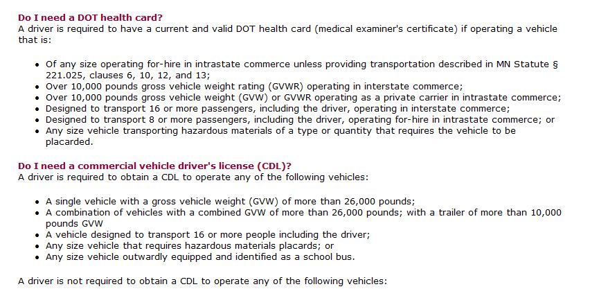

Your correct, I guess I just pointed out that the only thing required to pull the trailer was a regular licence. With that you do not need a health card even if used in commerce.
To say that because it only requires a regular license it doesn't need a med card is incorrect as I previously pointed out.
   / Do I need a CDL? #52
I went through all the old post and missed that, can you point out the post # or give and example again.
Here is a snip when a health card is needed and when a CDL is needed. This is from the MN site but it mirrors the federal regulation.

In the image I posted every time you needed a med card you needed a CDL. In your own example it was when a CDL required.
You do not need a med card if a CDL is not required. Can you give me a specific example were I am wrong?
Really?
Right in the image you posted,
"Over 10,000 lbs gross vehicle weight rating (GVWR) operating in interstate commerce"
That does not require a CDL but it does require a Med card.
Can you show me the example I gave that requires a CDL?:confused:
