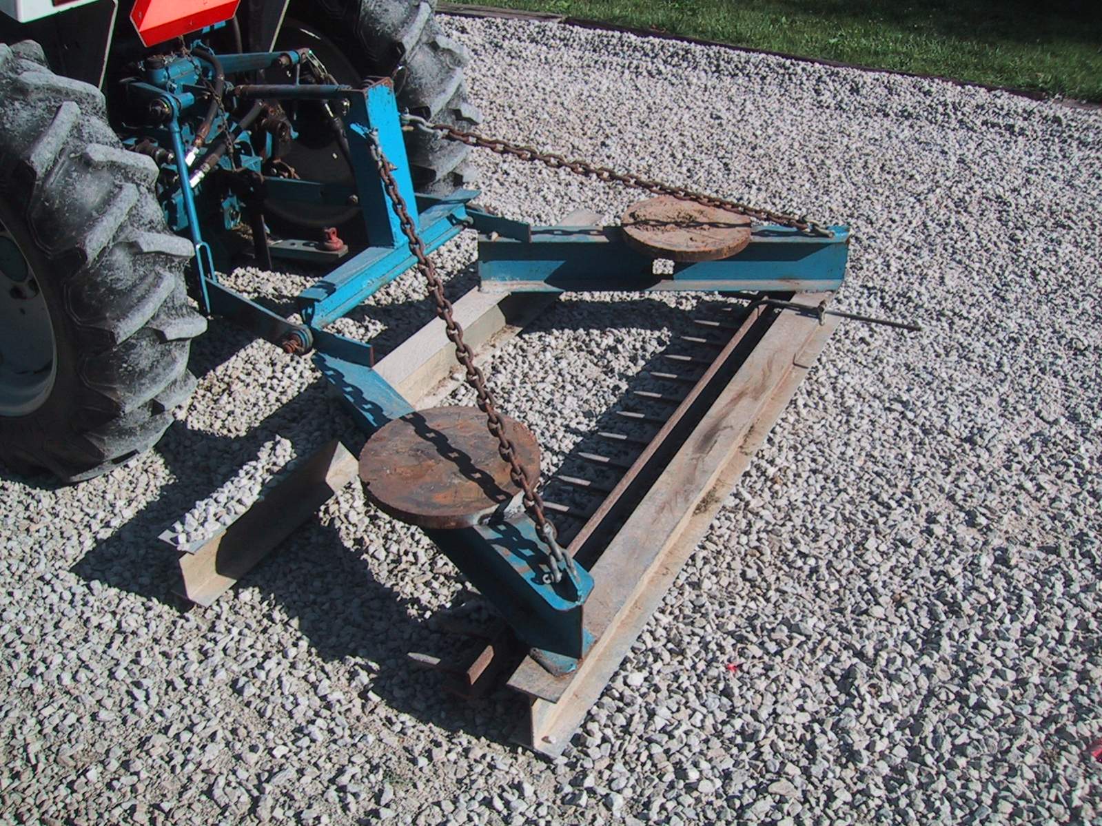

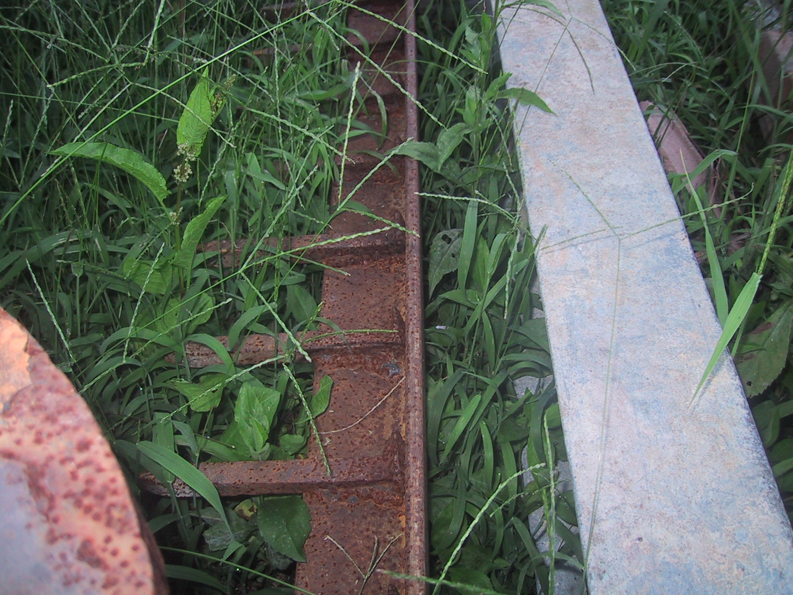

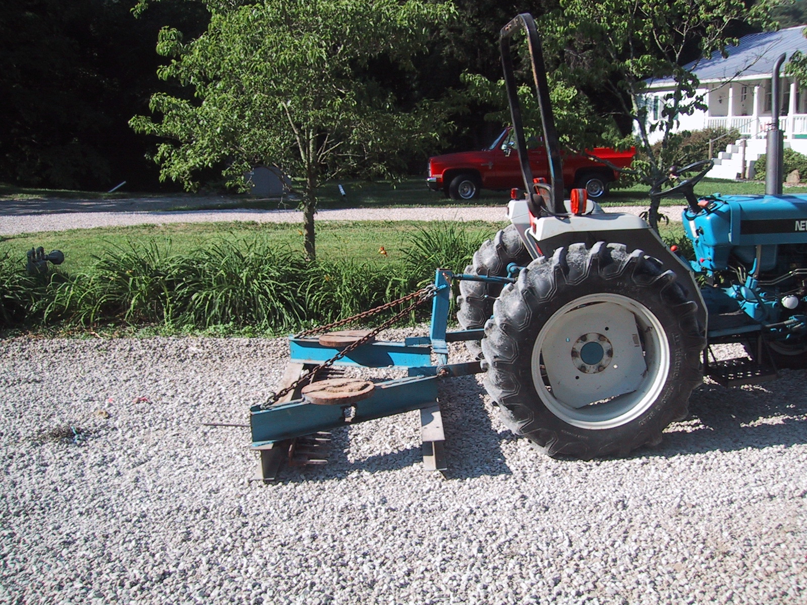

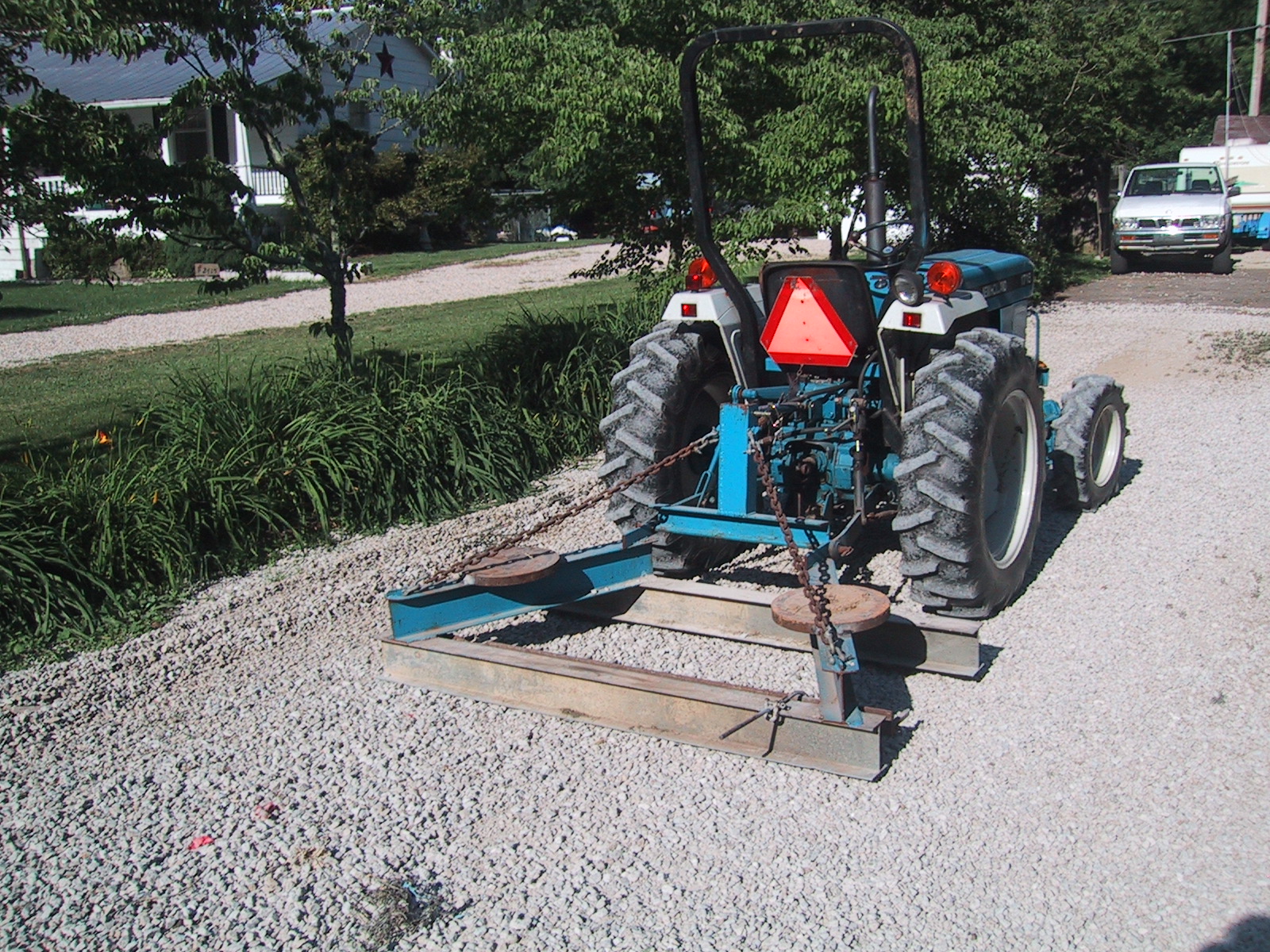

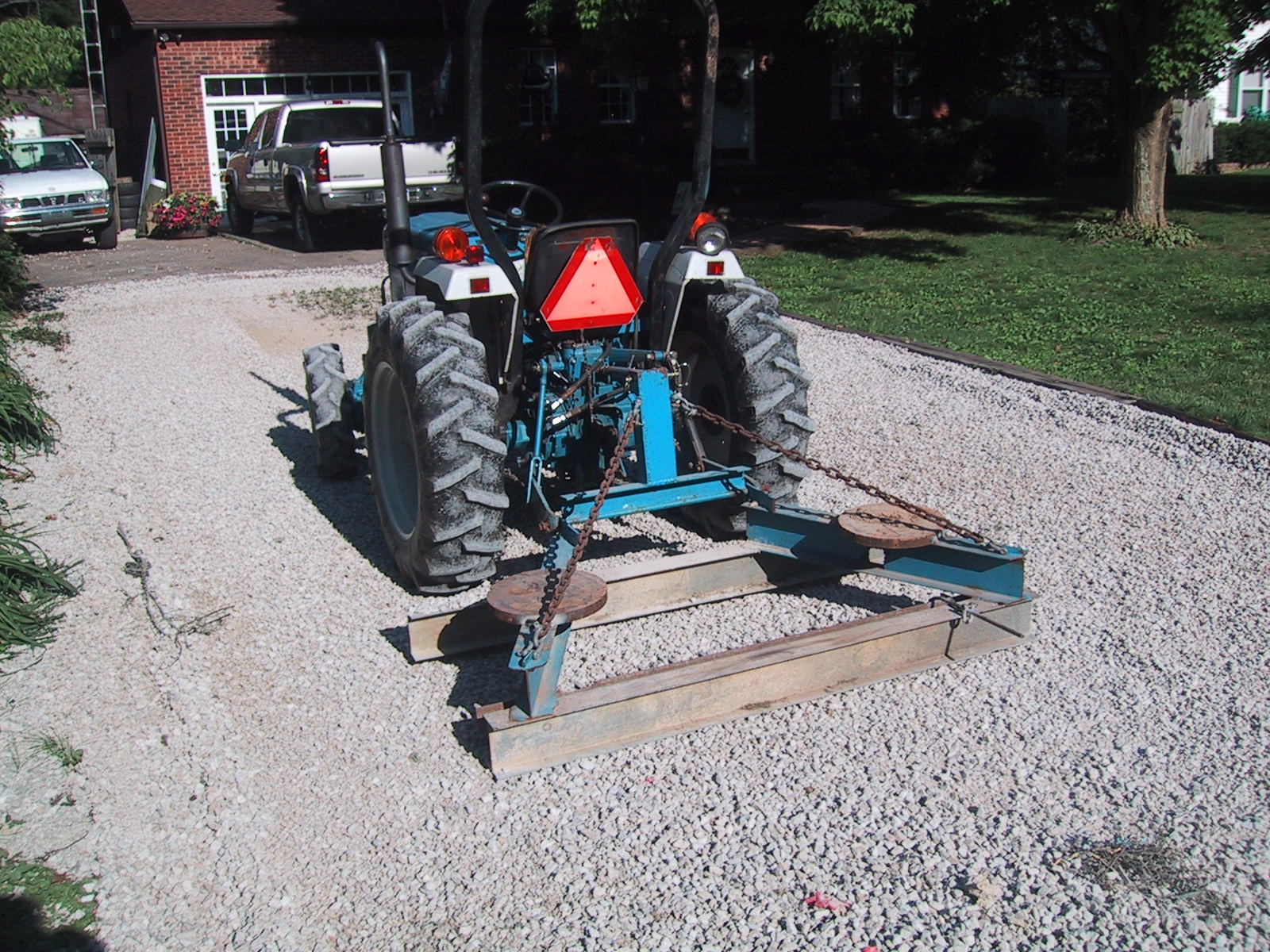

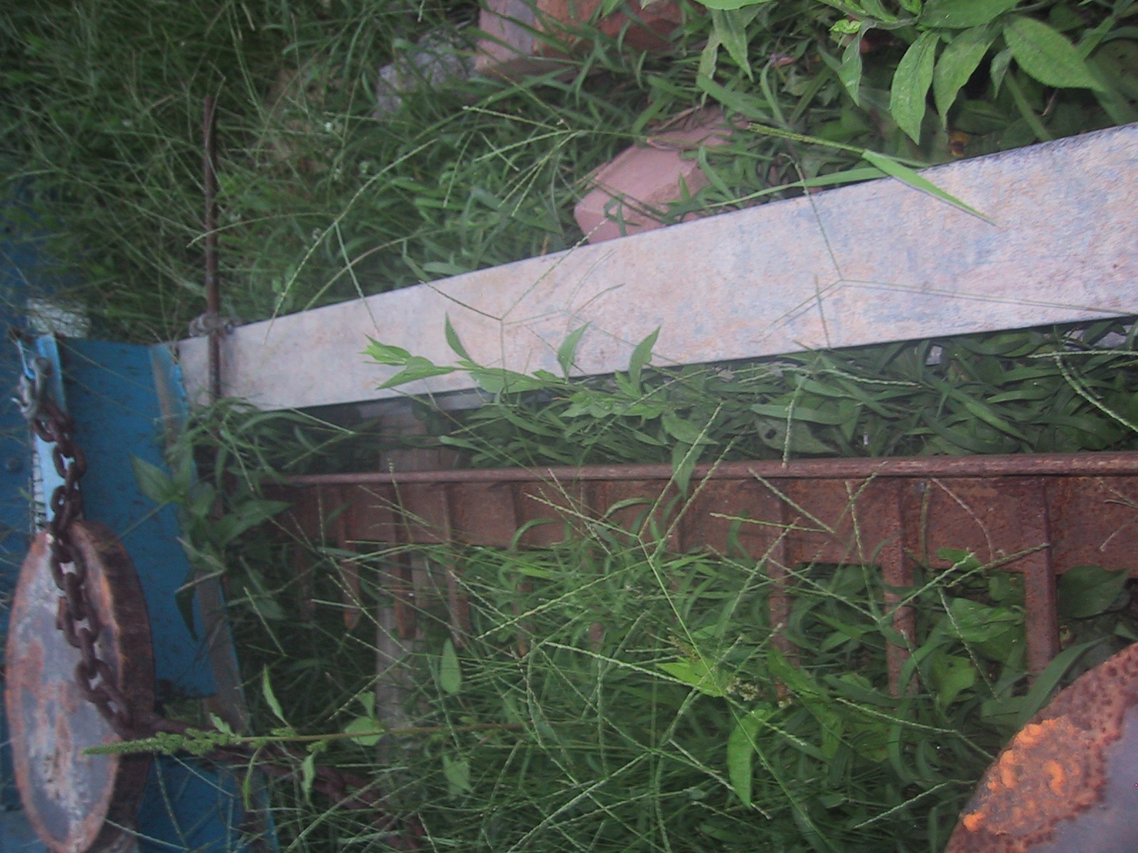

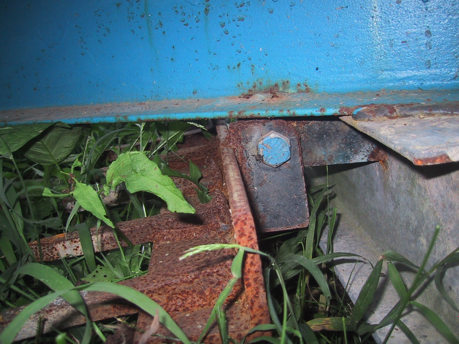

I built my own out of Guard rail post. Works for my short drive way. Had about 6 hours labor and $25 it it . Just made mine stright as my driveway is flat and level. Have rail Road Spikes to dig up grass then can fold out of way to finish leveling.

OldMax-- so what do you do, just loosen bolts and allow railroad spikes to swing down & rearward to contact rear "blade" when using it?

Picture doesn't show but there is a lever on the back right hand side that I use to move it up and down . Thanks I know it isn't for some driveways but mine is flat and about 150 ' long it sure beats pulling grass out by hand and as you see it works quiet well at leveling also.
