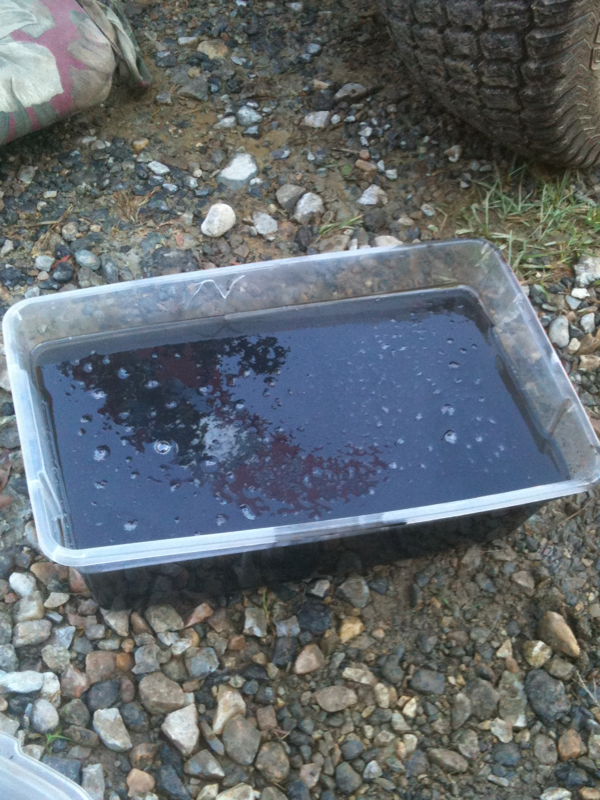

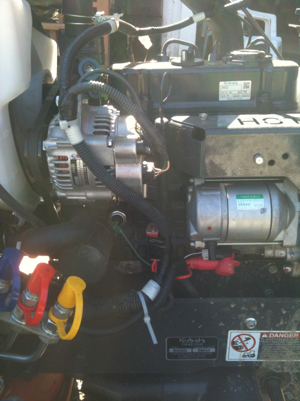

Well i finally hit the 50 hr mark on my bx25. Changed engine oiland filter. Also hydro filter, swapped out fr axle oil for gear oil. All went well, cleaned strainer also.one thing that surprised me was how dirty the axle oil was. thanks again for all the info on this site, god bless!
bingo..that is why I changed the axle oil also at 50 hours....junk!! black oil and metal all over! Installed Amsoil's best fluid...mint!

Noticed in the thread discussion about removing the hood to get to the oil filter. For the BX25 I have a socket attachment that fits many sizes; it fits over the end of the filter that you can see if you get down to eyelevel on the right side. The opening is just large enough for the wrench with a long extension if you nudge the hydraulic hose aside. Piece of cake, they sell them at NAPA.
