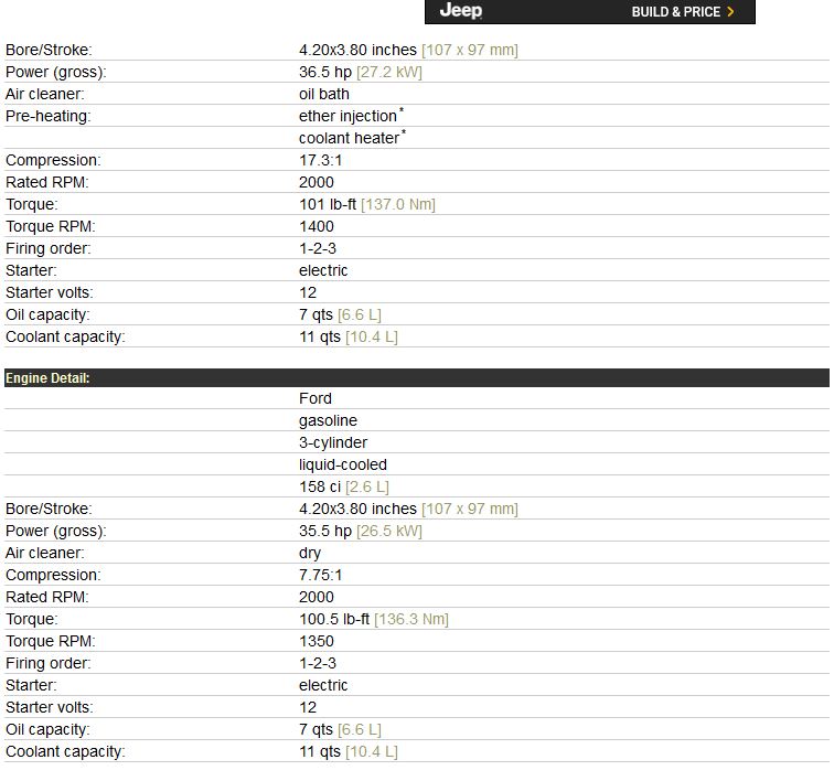

Take a look at the 4020 gas torque and 4020 diesel torque . Please tell us what the difference is .

Some comparisons as to why gasoline tractors disappeared. Selecting 2 of John Deere's most popular models of the past, 4020 gasoline and diesel, the Nebraska tractor test showed the 4020 gas achieved 10.53 HP-hr/gal while the 4020 diesel achieved 14.77 HP-hr/gal. After this series (JD 4020, IH 806) gasoline versions virtually dropped out of the scene.
Comparing technology changes over the past 50 years, I selected a typical JD farm tractor with Tier 4 final Nebraska tested in 2017, the 6195M equipped with power shift, same as the 4020. It achieved 18.34 HP-hr/gal, a 24% improvement over the 4020. In addition the 6195M power increased from 161 to 181 as it lugged down from 2100 rpm rated speed to 1700 rpm where it produced it peak power. The 4020 reached peak power at 2200 rpm and dropped off from there - 8% torque backup vs 36% torque backup on the latest generation. The common rail injection system has significantly improved the ability to lug through tough spots.
It will be interesting to see if the tractor manufacturers do switch to gasoline engines as the EC Stage 5 emissions requirements come into effect. It would seem to be a major shift because even Kubota uses other brand gasoline engines in things like their zero turn mowers.
