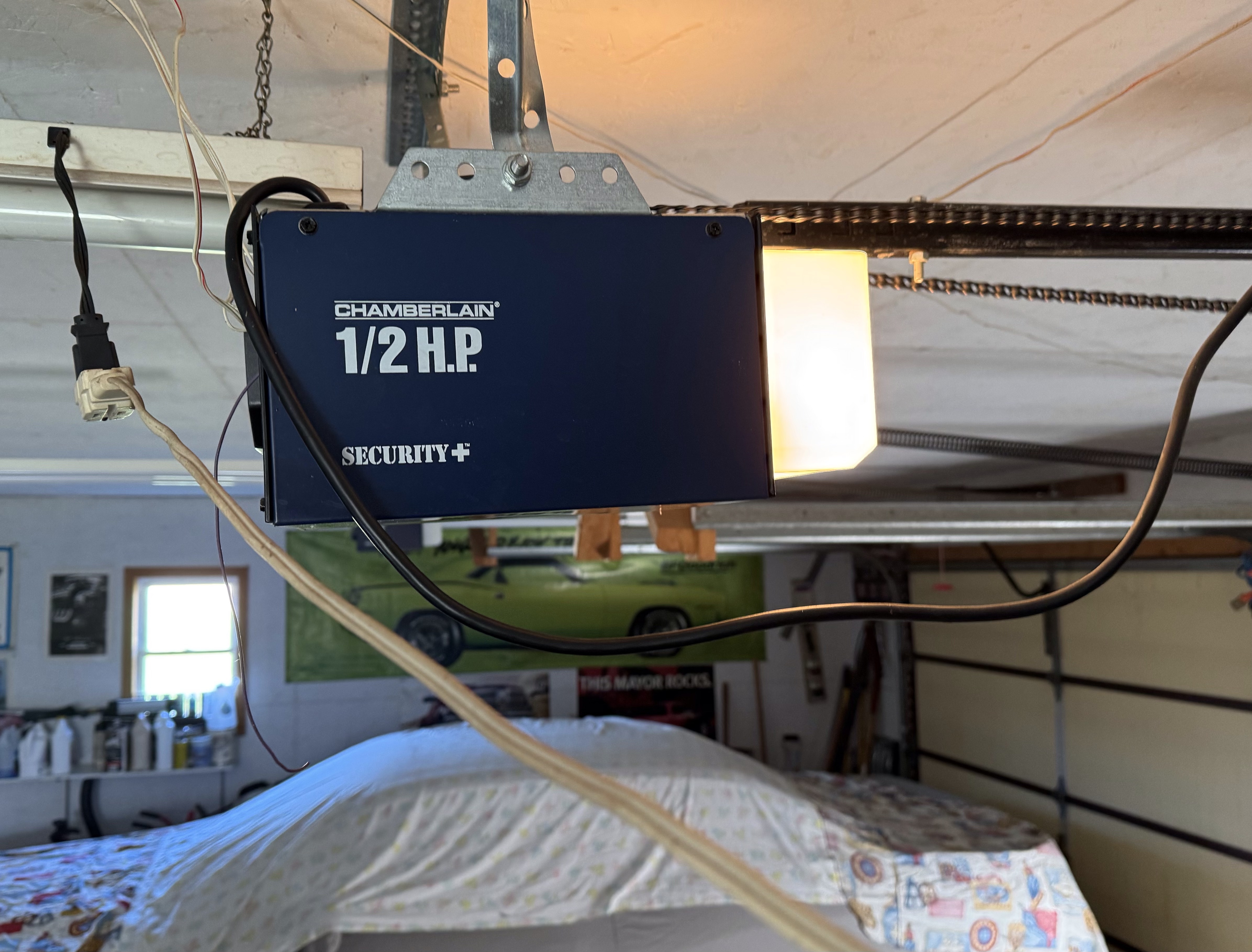

View attachment 1868102I have a Chamberlain garage door opener, about 15 years old. The problem is getting it to go down with a remote. I have one remote and one car both programmed for it.
It always goes up and down with the button in the garage. It always goes up with the remotes. It will sometimes go down with either the remote or the car but it’s less than 50% of the time. If I try and lower it with a remote and it doesn’t work it will go down with the button in the garage so I do think it’s the safety eyes.
Getting closer with the remote doesn’t help. I reprogrammed the remote and car, that helped for a day. I also read a CFL or LED can interfere with the signal. I have a regular rough service light bulb in it and taking it out doesn’t help.
Any thoughts?
Check to be sure the sun isn’t blinding the receiving eye at certain times of day. Had an issue similar to this years ago and took quite a while for my dumb ass to figure it out!

Duh! Call Chamberlain. Buy a new remote at Lowes, try it. If it works, keep it. If not take it back to Lowes for a refund - because it is an issue with the main (receiver) unit. In which case Chamberlain may offer a repair - or tell you to buy a new opener.
Or, try a garage door forum?

Lots of good ideas, I’m pretty sure it’s not the tension adjustment, door counterbalance spring etc since it ALWAYS goes down with the button on the wall. It’s an intermittent problem with it going down with the remote only. I looked at a new/used board, an add on remote system etc and just ordered a new unit. It’s about $50 to $100 more than any attempt to fix this one and it’s over 20 years old.
Good decision, the logic board is the most likely problem, you have eliminated everything else.
Please follow up and let us know wat the final fix is.

The final fix is on order, a new unit. It’s over 20 years old and probably closer to 25 years old, I’m not expecting anything from Chamberlain. It’s not the remote, I’ve tried two plus the one that’s built in the car.
