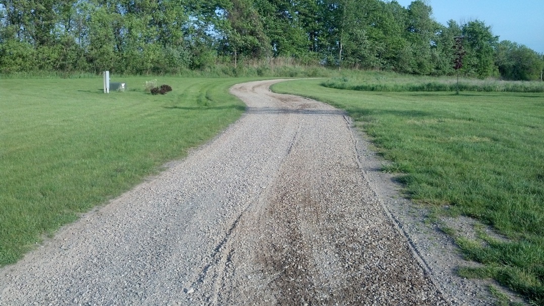

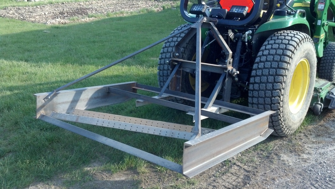

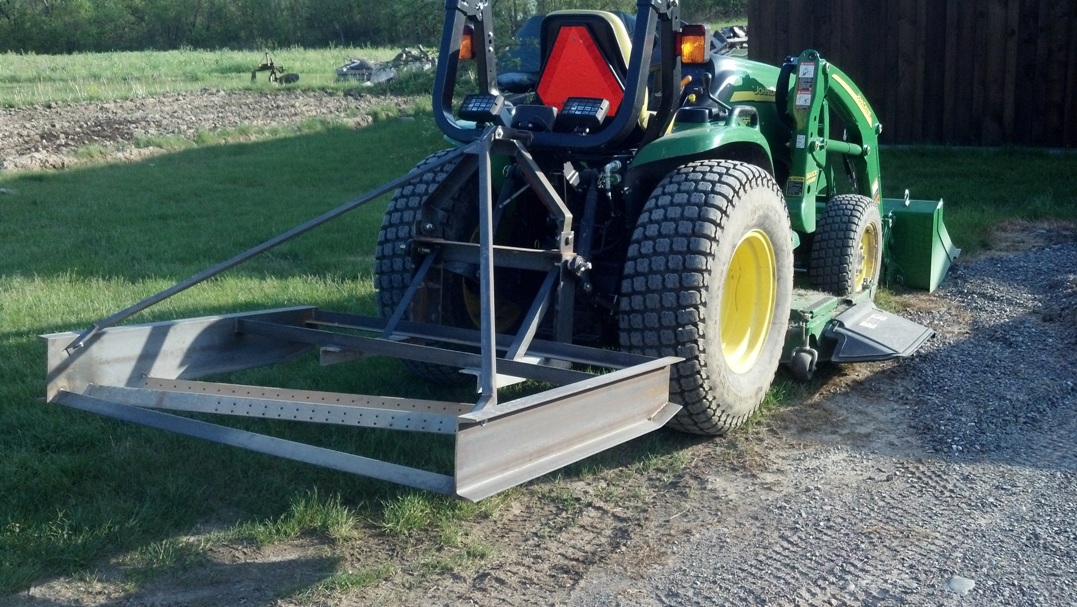

Just an update to this post. I removed the chains, and put in ridgid angle bracing. I also lowered the cutting edges 1/2" below the skids. It works like a charm! OK, I don't know how the factory ones work, but this does a beautiful job. I lowered it down, and with in 3 passes, the driveway was looking great. I did find that it moves a ton of gravel if it's not packed yet, but most of the time I will be using it on a packed surface. I'm very happy so far with it. Here are a couple updated pictures. I still need to finish the welds, weld in some gussets, and get some paint on it. I have had a quart of JD green kicking around since I touched up my bucket hooks. Should look good when done. Thanks again for the advice!

I did find that it moves a ton of gravel if it's not packed yet...
One article I saw said you can control the amount of gravel it carries along by changing your speed. If it is picking up too much gravel, then drive faster.

New gravel is tough because the skids don't float on top of the soft gravel. The blades pull them down in so it takes a deep bite. On mine if I lengthen the top link I can make it less aggressive. Yours may act different but you might try changing your TL length longer and shorter to see what it does.

On my grader if I run a chain for a top link the big problem is when I hit anything solid, like a rock . The back of the grader kicks up violently because there is no Top Link to hold it down.
Slip a piece of pipe which is shorter than the chain over it. It will still float but if it kicks up, the pipe will act as a solid link.

Looking at the pics I think you might want to consider moving the blades forward a bit so that you have about eight inches or more skid trailing the blades. With the top link you can adjust the trim of the skids to cut aggressively (short) or lightly smooth over the surface (lengthen) even with the blades set at 0 depth. I use the landplanes primarily to smooth lawn areas and they work great for this.
