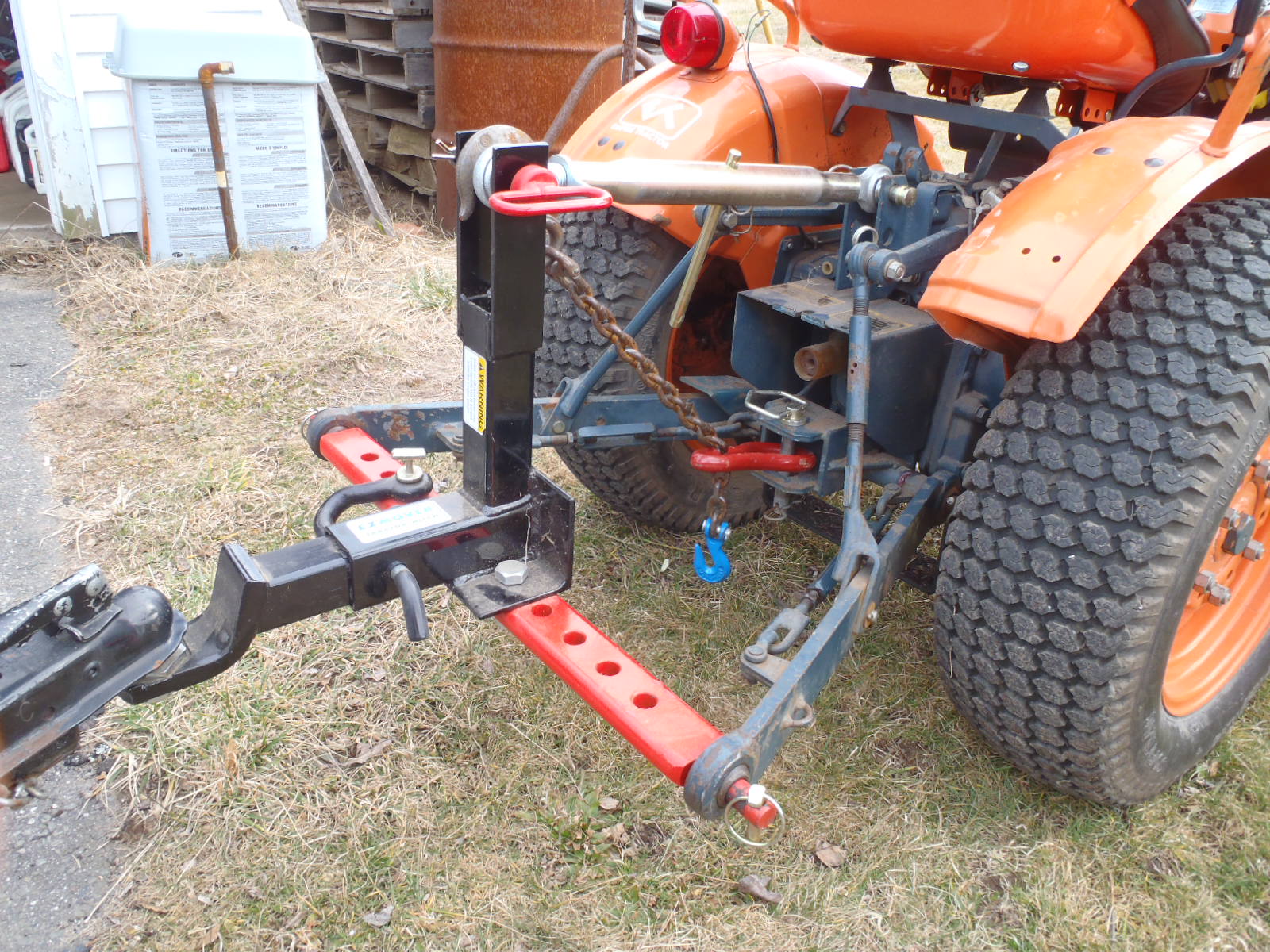

Just load it right and watch the draw bar you can bind it, and for god sakes don't use the 3pt.
/ Dump Trailer with b3200? #12
Lol. I was waiting for that! 3pth works fine for me but make you own decision.

I one time hooked my dump trailer to the 3pt and was going down a hill while dumping, it came unhooked and set right down on it's tail gate. I tell you that no one wants to go thru that. Now it is always hooked to the draw bar and never dump going down a hill, or unlevel ground.
/ Dump Trailer with b3200? #16
I was always afraid of it coming unhooked and coming up in the back of the seat. Mine is good as far as jumong up. Last fall I found that I could load it with wood and raise the dump without it hooked to the tractor. It just sit right there, but sand may be a different story
/ Dump Trailer with b3200? #17
Just keep in mine the 3pt can float up.

Leejohn makes two good points. When backing up it's possible to bind the drawbar and get yourself into a "jackknife" situation. When this happens, if you keep backing up your inside rear wheel will start lifting and you're on your way to rolling over. Don't ask how I know. As for the 3pt lifting, that can create a whole other set of complications. This happened to me with a load of wood, going uphill, the load shifted aft and the tail of the trailer dug in. The result was a loss of traction that took some futzing with to get the load back in front of the trailer axle. You can limit this tendency by securing the 3pt hitch with a chain. Just make sure you make a good, secure connection between the toplink and the drawbar:
