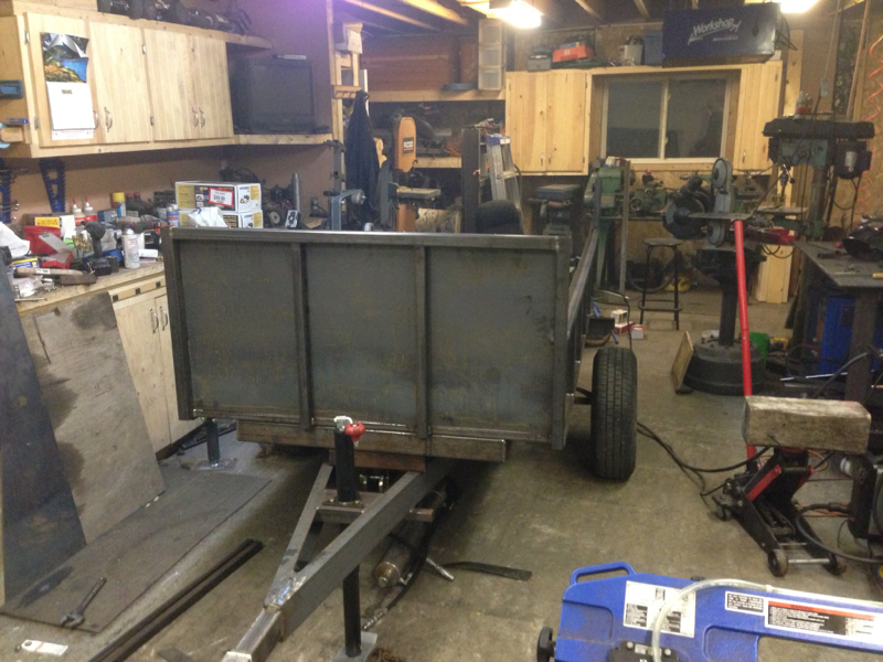

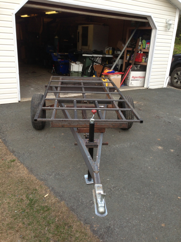

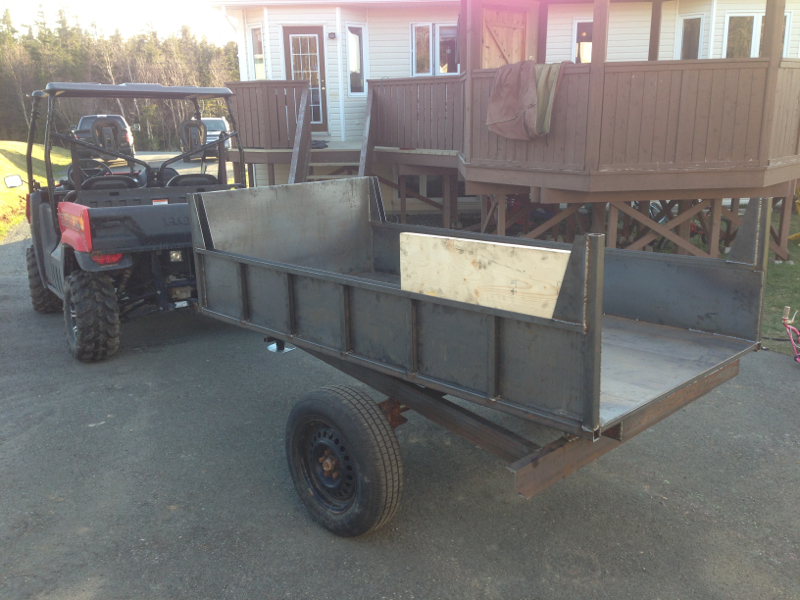

The sides are done. I put 2" channel on the sides and built supports so I could add 2x12's to side for extra capacity.
Just need to build the tailgate and fix the leak in the hose.

/ Dump trailer #26
Any update on your trailer, did you get the tailgate installed? Have you tried dumping it with a load?
/ Dump trailer
#27

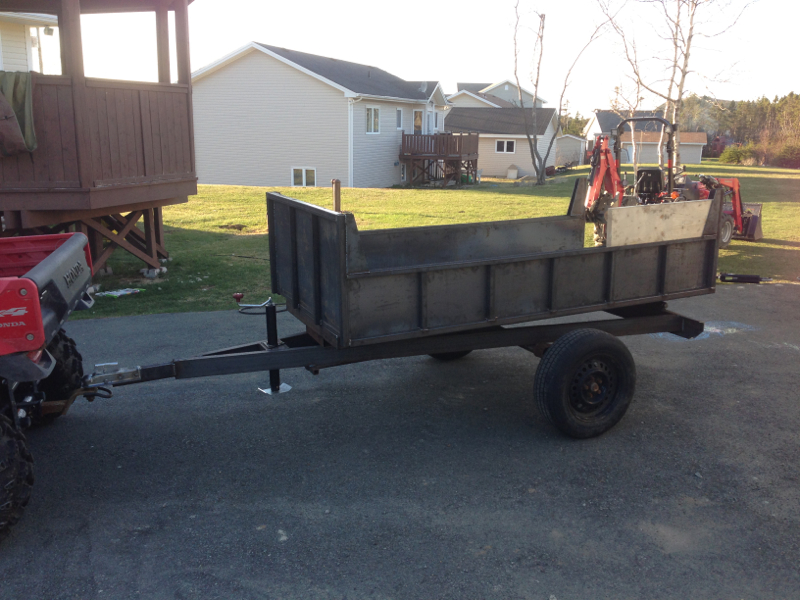

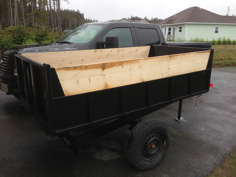

I just have the fenders left to install. I am having issues with the ram and need to take it apart and check the seals. Hope to have the parts next week to finish up the ram.

/ Dump trailer
#29
It's a spring loaded pin. I cannot find another one so I have it in the middle of the tailgate right now. Once I find another one or something else that works I will change it. The wife wanted a load of mulch so I tacked it on.
/ Dump trailer
#30
Made a short video of the trailer in action. I just bought a pump for it so I can use it on the bike or the truck without having to use the tractor all the time.
