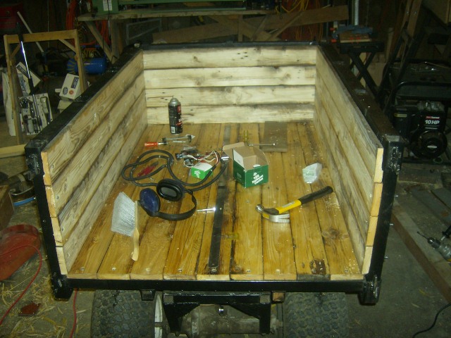

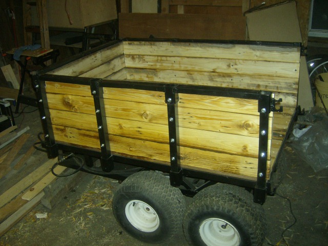

I got back out and made a little progress on the trailer.
I bolted the wood to the sides of the bed. Because of the sockets that I put in the top to receive bedside extensions in the future, I had to rout notches in the top rails all around in order to get the top rail to fit flush with the other boards.
I've missed the good weather, and so I'm probably going to have to take the sides and front off one at a time now and bring them inside to varnish. The bottom of the bed has a single coat on it. I'll probably leave that like it is for now and just plan to put a bunch of varnish on it again in the spring.

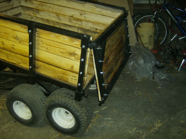

I put the wood on the tailgate tonight. In the picture, the bed is dumped just a bit to show how the tailgate will swing to allow material to dump.
Those bolts are plenty long. I'm planning on going back to all of the bolts and cutting them off flush with the nylox nuts that I used to put them on.

/ Dump Trailer #279
Iplayfarmer said:
In the picture, the bed is dumped just a bit to show how the tailgate will swing to allow material to dump. I'm planning on going back to all of the bolts and cutting them off flush with the nylox nuts that I used to put them on.
Whoa there buddy. Don't cut all the bolts off short. You need to add adjustable chains on both sides of the dumpgate to control the rate of feed of gravel and such. The extra length of the bolts should be sufficient to attach aome "S" hooks or similar to allow using chains to control the amount the gate will swing back.
Pat
/ Dump Trailer
#280
Pat
Good thought.
I was actually planning on drilling into the pins at the bottom of the gate and running an eye bolt through the hole to attach said chains.
Those bolt ends sticking out beyond the nuts are just about shin height. I know me... I can't even leave my ball in the receiver on my truck without finding it in the dark with my tibia.
