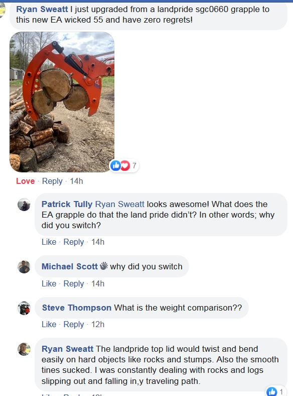

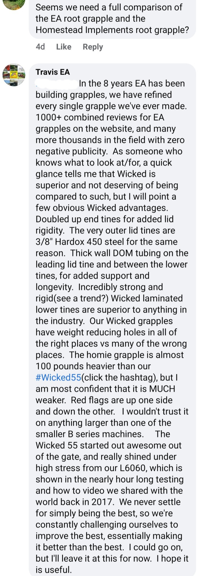

To me, Travis with EA, who started the Wicked Grapple thread here on TBN, when we began making grapples almost 10 years go, it seems that a responsive manufacturer representative would be a pleasing note of confidence in today's market, rather than sitting back and letting disinformation spread.
Here's a response I composed a while back, concerning what makes EA the obvious choice..

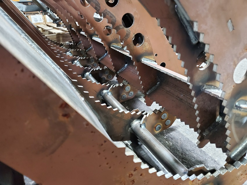

Since that response, we've moved onto an even Wickeder version, as I've been known to call it. EA never stops improving our products. These horizontal serrations greatly help you rake material/dirt/rubbish to smooth and clean up areas you're working in.

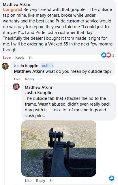

I can elaborate some on land pride, as well. Anyone who has studied grapples should have already discovered the many shortcomings which have never been addressed by that company. They remain the same to this day.
