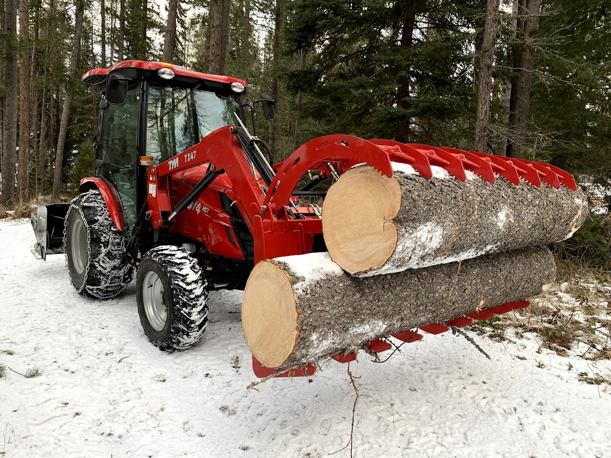

Yes, if I had that grapple, I wouldn't be doing such as that.
WE do such as that with Wicked, and so do our customers!

Example 1
Example 2 Crazy? yes. Proven? Most definitely.

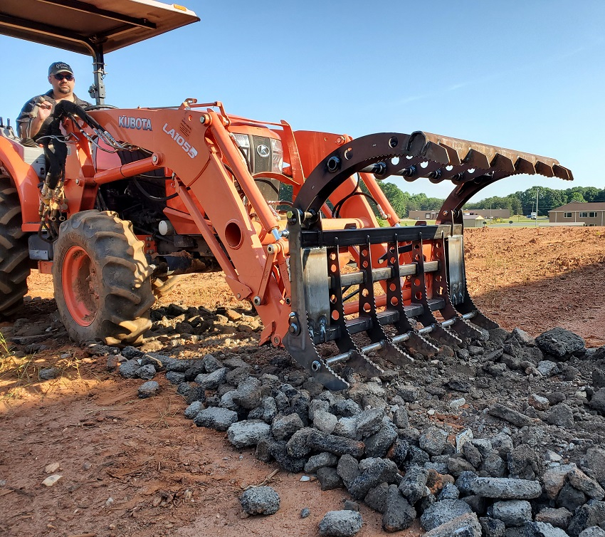

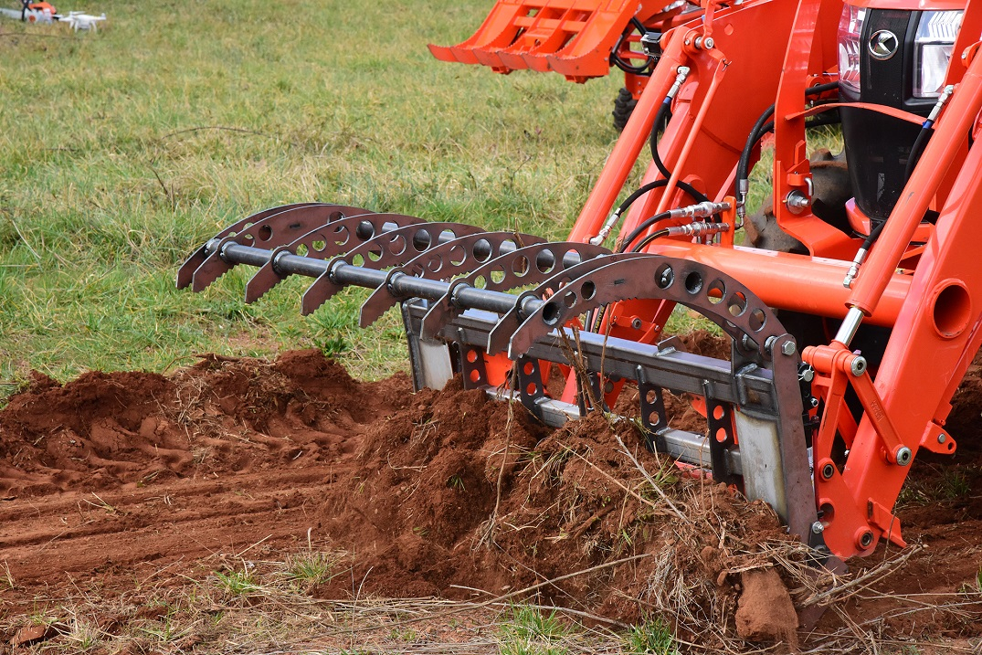

It's all about the angle of approach. Longer tines, or more forward aimed short tines, are rougher on the loader and loader cylinders because in order to dig/pry/grub at the best angle, it requires you to dump it down, which extends your loader cylinders. Extended loader cylinders are most vulnerable to damage.
Notice how our Wicked grapple rake tines are angled. Not much dumping at all is required to achieve an optimal pushing, asphalt ripping angle of attack!
Despite many changes/enhancements over the years, we kept the same lower tine angle. #DemandTheBest

Well, if that first picture isn't staged I don't know what is. Somebody dumped a pile of asphalt in an open field and snapped a shot thinking no one would notice.

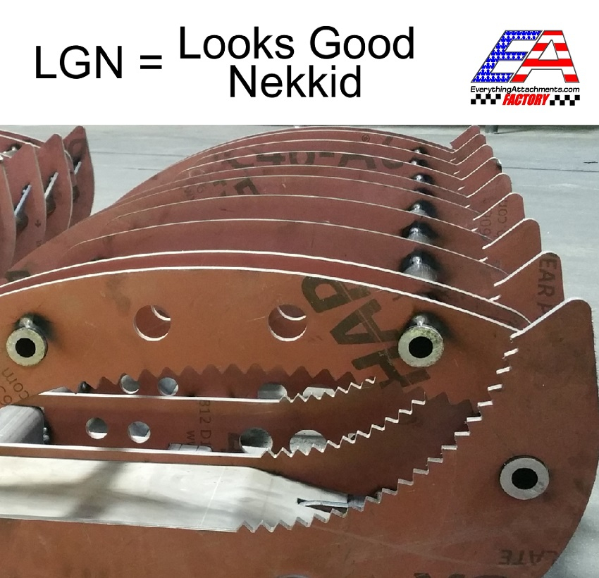

I will say I kind of like the raw look of the unpainted grapple. If it weren't for rust I'd prefer to have mine that way. At a discount of course. Paint and labor savings. ;)

Nah, not staged, dude! I'll look for the video footage. lol

Guys have begged for nekkid Wickedness for years!!
