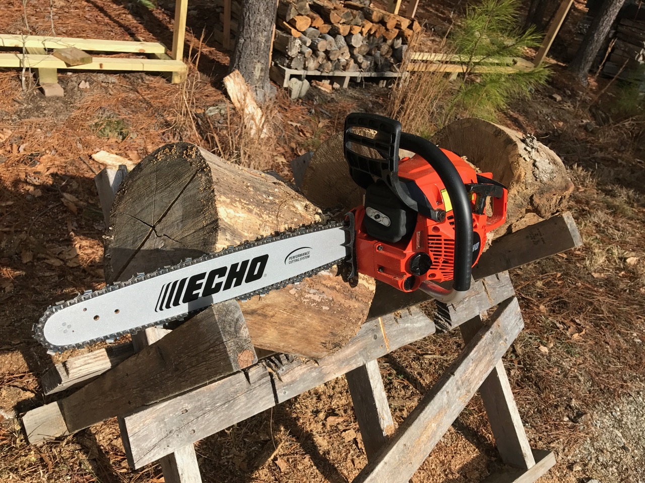

So every few years I tend to cycle a new saw into my quiver. For a while I have been getting by with an Echo CS-400, Husky 562XP, Stihl 461, and a small top-handle Echo. I also had a Stihl 261 but sold it after getting the Husky 562XP, as the Husky was a lot more saw for only a small increase in size and weight.

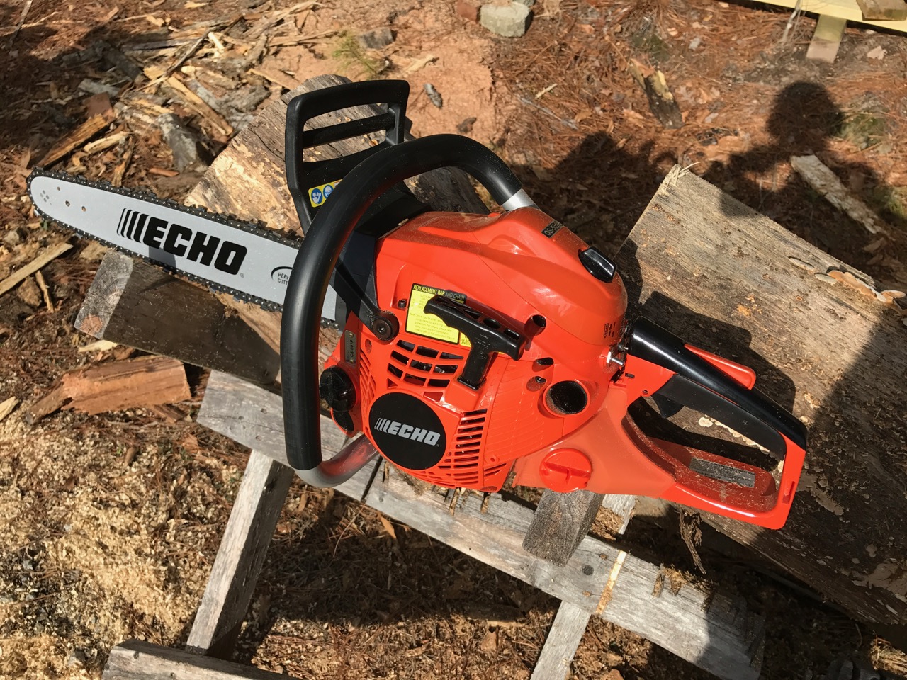

Recently, Echo came out with the new CS-501, replacing the CS-500 in their lineup, and it caught my eye. The 501 is more powerful (they say 17% more power than the 500) and has some minor other tweaks like captive bar nuts, de-comp valve, updated case design, etc. Compared to some of it's peers from Stihl and Husky, it's got a much more compact powerhead and handles much better. I was able to get a good deal on the 501 with a 20" bar, so I took the plunge.

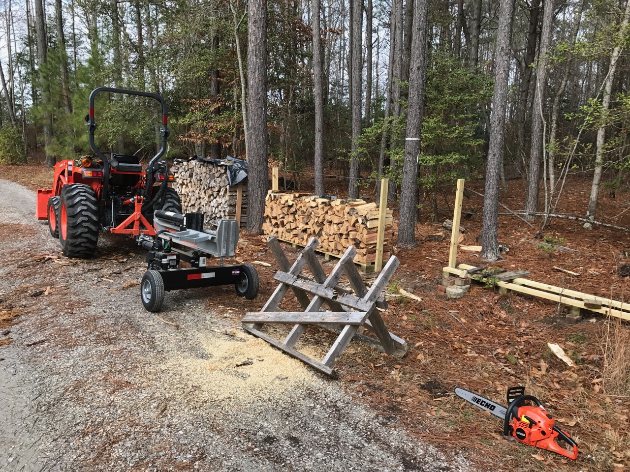

I used the 501 for some felling a couple weeks ago and liked it, but this weekend I used it extensively for processing firewood and have been really impressed. It is a very strong saw, much stronger than my Stihl 261 was, and has a noticeably smaller lighter powerhead than the 261 did (Stihl has since updated the 261 to make it a bit lighter). I was bucking 12-18" oak all weekend, and the 501 sailed through it, almost to the point where I think it's abnormally strong for a 50cc saw -- really feels more like a 55-60cc saw. Not once did the saw bog down -- it would load up in the cut and maintain RPM, just like a big saw. Really impressive.
The 501 balances pretty well with a 20" bar, but I ordered an 18" setup as my backup bar/chain, and I suspect it will balance even better. I really like the overall feel and lateral balance of the saw, and it is very enjoyable to use. Vibration isolation is among the best I have experienced on any saw.
Here are a couple pics:

Congrats on the new saw. I think you're right about an 18" bar being a better setup for that model. I've always been super impressed with the Echo stuff I've owned. You may already know this, but in the chainsaw communing it's pretty well established that Echo sets their saws very lean from the factory. It's said that a minor muffler mod and removal of the carb limiters is necessary for them to run properly. Only takes a few minutes to pull the carb limiters, which I wouldn't hesitate to do.
Out of curiosity, was your 261 standard carb, or m-tronic? Also, there's a second version of the 261 that's quite a bit lighter and a little more powerful.
/ Echo CS-501 Brief Review
I know my CS-400 was set very lean, as was my little CS-330T, but the 501 doesn't feel that way. I will give it a little more break-in time and do a brief rev test to see if I can hear a four-stroke warble at full throttle with no load -- that's usually how I judge carb tuning. If I don't get the warble I'll open up the H screw a bit. Unlike the previous two saws, the 501 carb seems to have more range in the adjustment screws, so it may be unnecessary to mess around with the caps for once.
