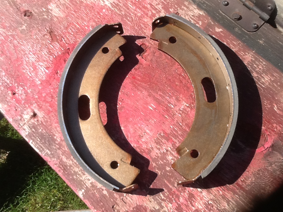

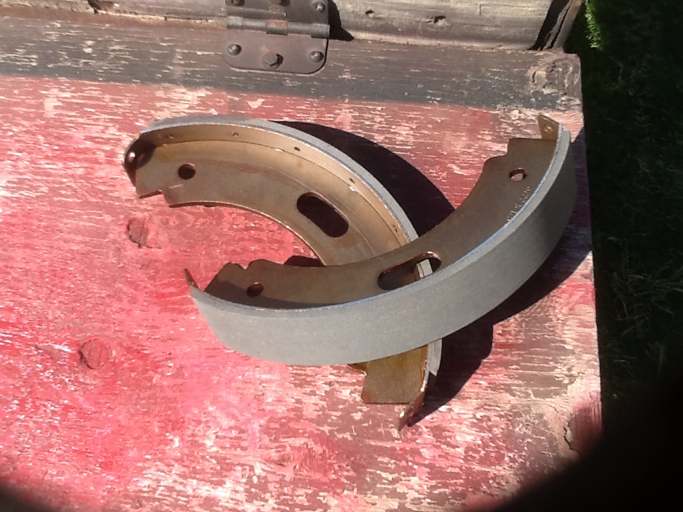

Picked these up today, maybe I will have a working parking brake next trip.

Are those new or just relined?

Relined, we have a place that will reline just about anything. My place is half the elevation of yours, our trails at about 9-10 thousand feet will not be accessible until about another month and a half either. I did not want something higher for that reason. I love the high country, but I will just have to be a visitor.

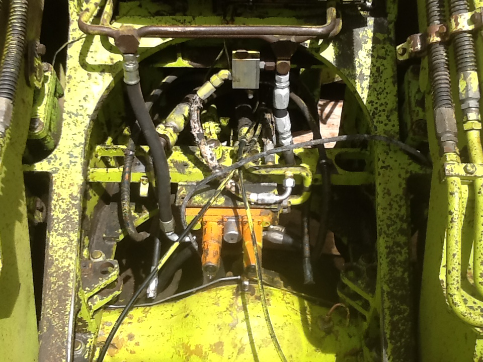

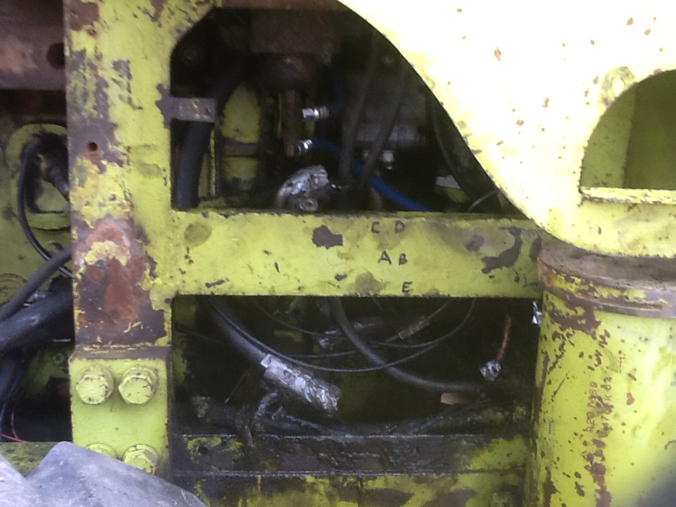

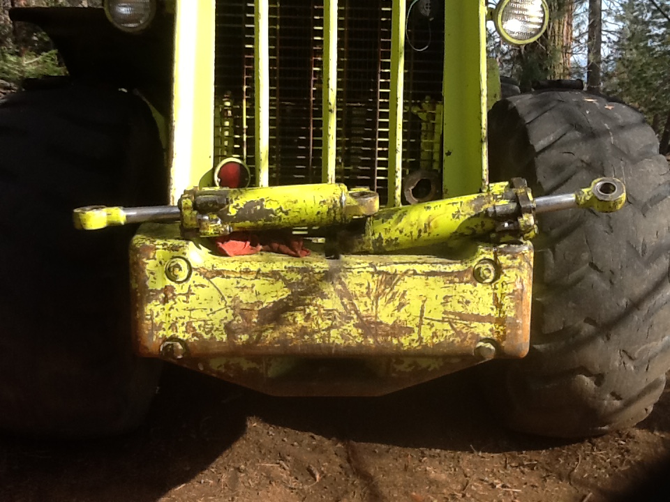

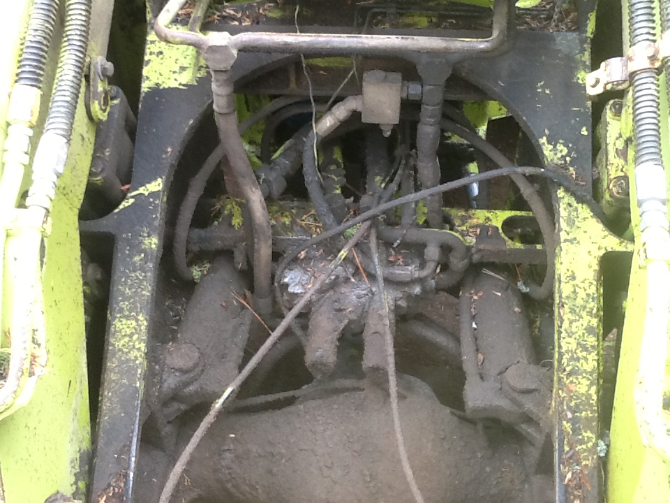

Finally got access to the steer cylinders. Pretty nasty, but cleaned up good. The steering wasn't perfectly centered. One side came out easy, the other side I fought with until I took the spool valve mounting bolts out. Then it came right out, just a little bit keeping it from moving. I had the cylinder seal kits with me, but brought them down to do at home. Better resources, and that way I only have to expend my energy up there on what has to be done up there. :dance1:

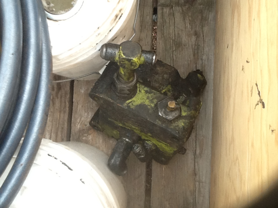

Also removed the steering manifold assembly, it was leaking. I figured I'd do all the steer stuff while the system is open. It was a bear to wrestle out of this little opening. Finally found an angle that worked, after trying others. The buckets show how BIG the thing is. And needless to say, it was a nasty mess.

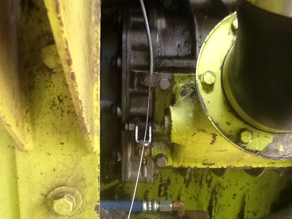

Also got the emergency engine shutoff cable installed, still need to put the stop on next time. I put the knob on the left edge below the dash.
