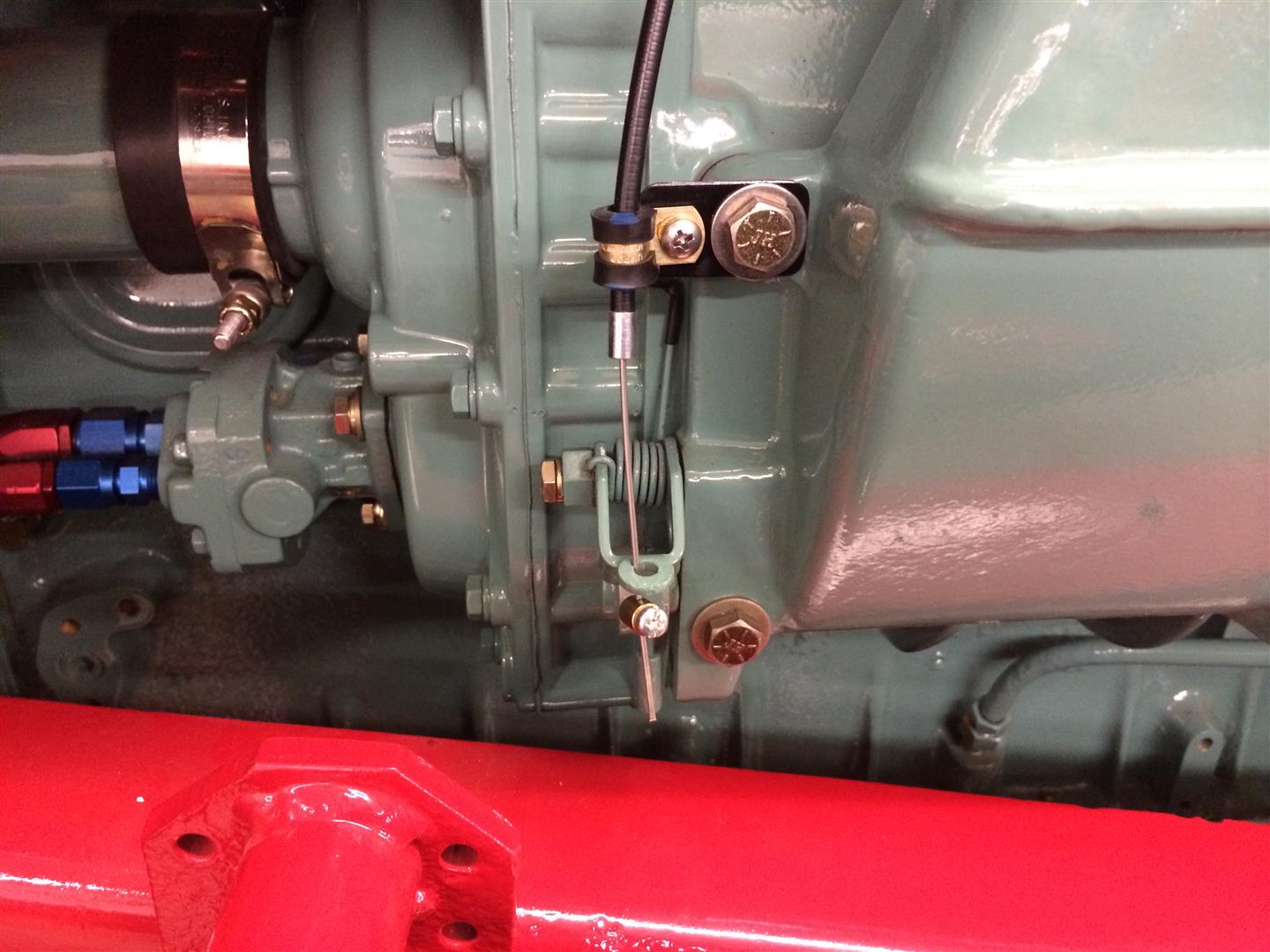

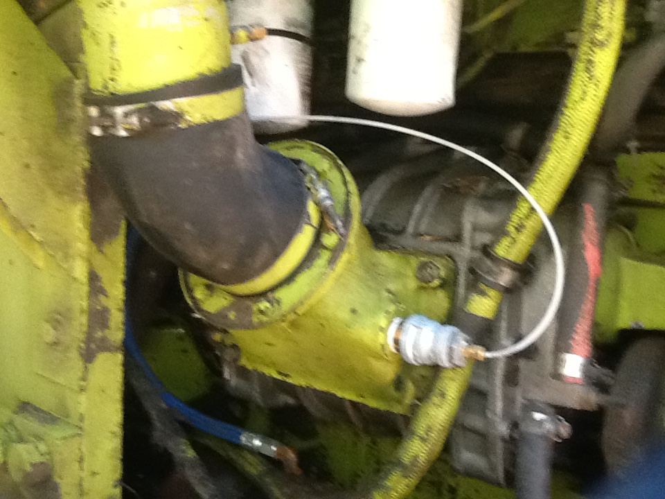

What I thought was the water outlet is the fuel pump, the part in this picture with blue and red fittings on it. I reviewed the diagram showing where the block heater goes, there is a cut away indicating it is on the other side of the engine. I do not know why they did not just use a view of the other side. So now I remember, early on I had to fix the heater hose going to the air compressor. That is where the block heater goes. Next time up I will get a better look and see if I can access it without removing the sheet metal over the engine, it was already off when I worked on it before.

Also the above view shows how someone else made his own holder for the cable.

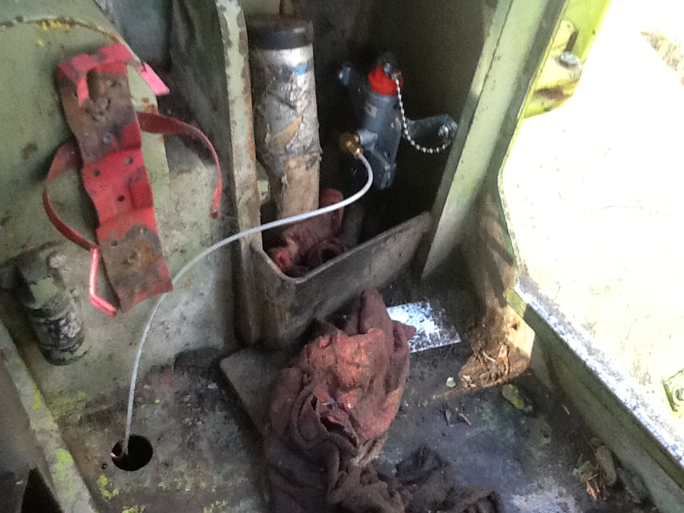

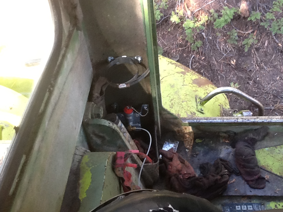

Went up Tuesday, the snow is mostly gone. Could not put the ether injector on the left, it would interfere with the emergency shut off cable. That would put it closer to the cab though, and the manufacturer wants no more that 4’ of hose. I will have to figure out what the length will be this way, maybe I will put a 90 degree elbow going straight up instead of back. Then it will not be doing a u turn.

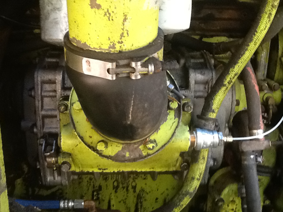

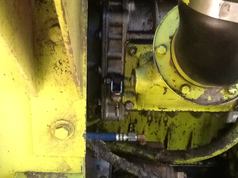

Installed the ether start system yesterday, I think I need to protect the tube though. Maybe some flex tubing??

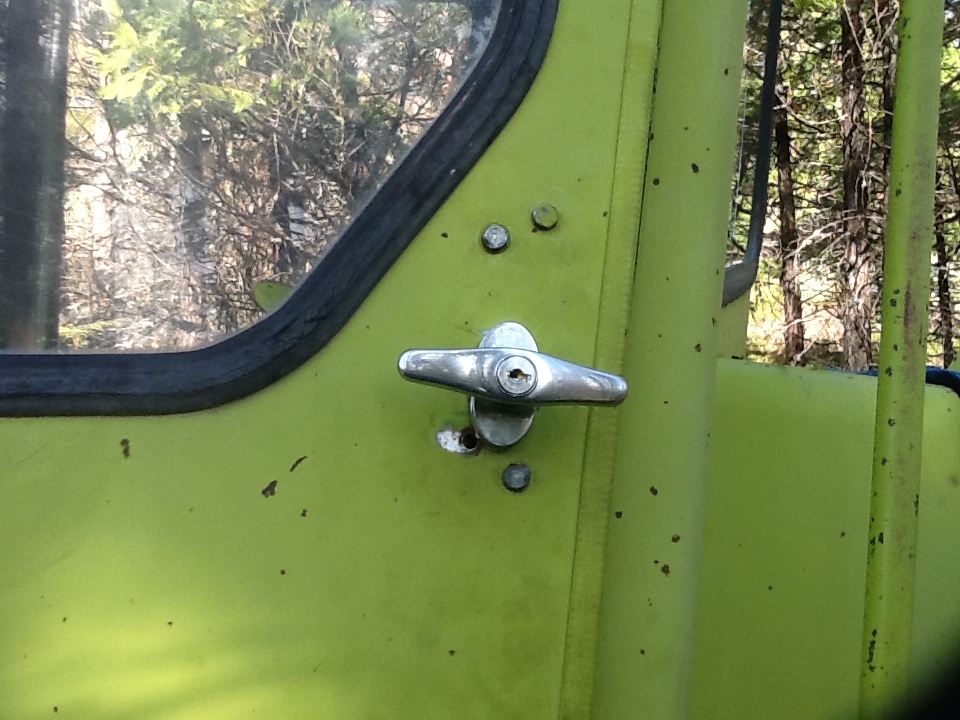

Got both locks done. Turns out the latches are left and right, but the handles are the same. The handles only turn ninety degrees, so one is horizontal and one is vertical. Meh.

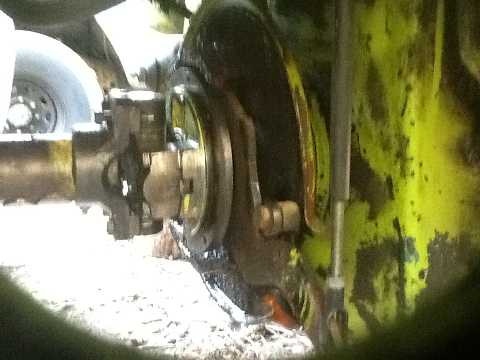

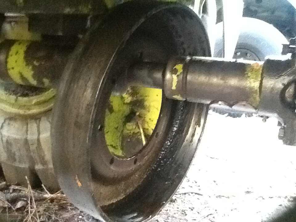

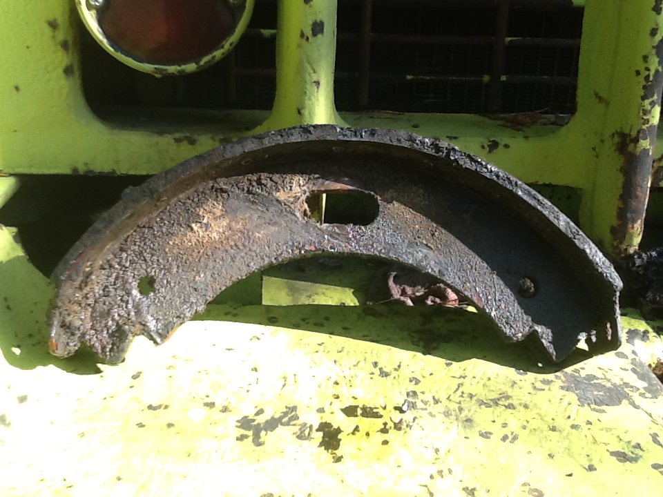

I took off the parking brake drum, it was caked with oil inside. I'll pressure wash the shoes and get them relined. The oil was coming from the steering valve above, we resealed it last year.
