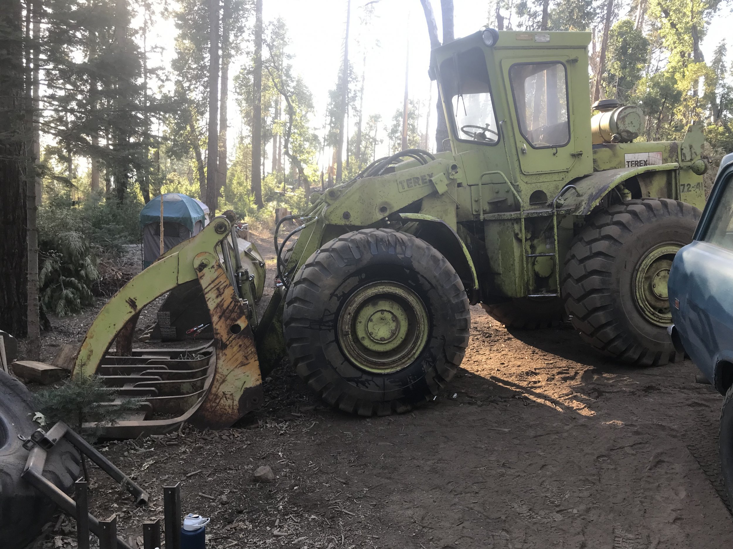

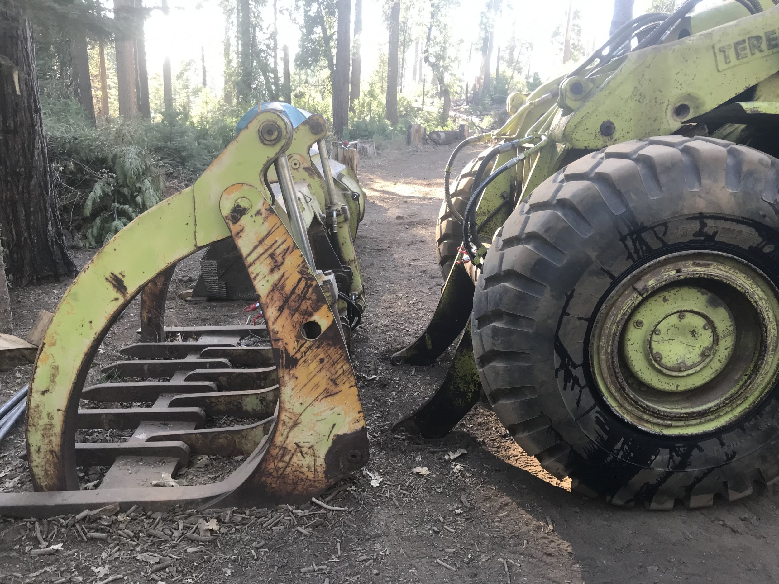

My son and I went up today and put the tilt cylinder on, no leaks. Once we tightened the fitting on the back of the gland, forgot to do that before.
   / Ed's 77 Terex 72-41 Wheel Loader
#584
Then we unpinned the bucket and went to the grapple. We don’t have pins compatible with the grapple, so we thought we’d just cycle the clamp cylinders. Then refill the tank. The diverter valve didn’t work though, I checked the wires on the valve itself and they looked undisturbed. I pulled the seat to check the controller’s connection to power, in doing that I disconnected the hot wire and it grounded out. Oops! Then when I went to move the loader back to the bucket, there was no drive. Nothing. Is there an electric component to it that might have been damaged when the wire grounded? I don’t know what else could have happened, coincidence doesn’t seem likely. It was working fine.
#585
This is after it rolled forward, its too far forward here to pin it. You still can get an idea of how it’ll look.

What material do I need for pins to hold the grapple on the loader? They’re 1.75” diameter. Two need to be 7” long, and two at 9” long. They’ll need a tab with a hole welded on one end, and grease channel/zerk holes.
