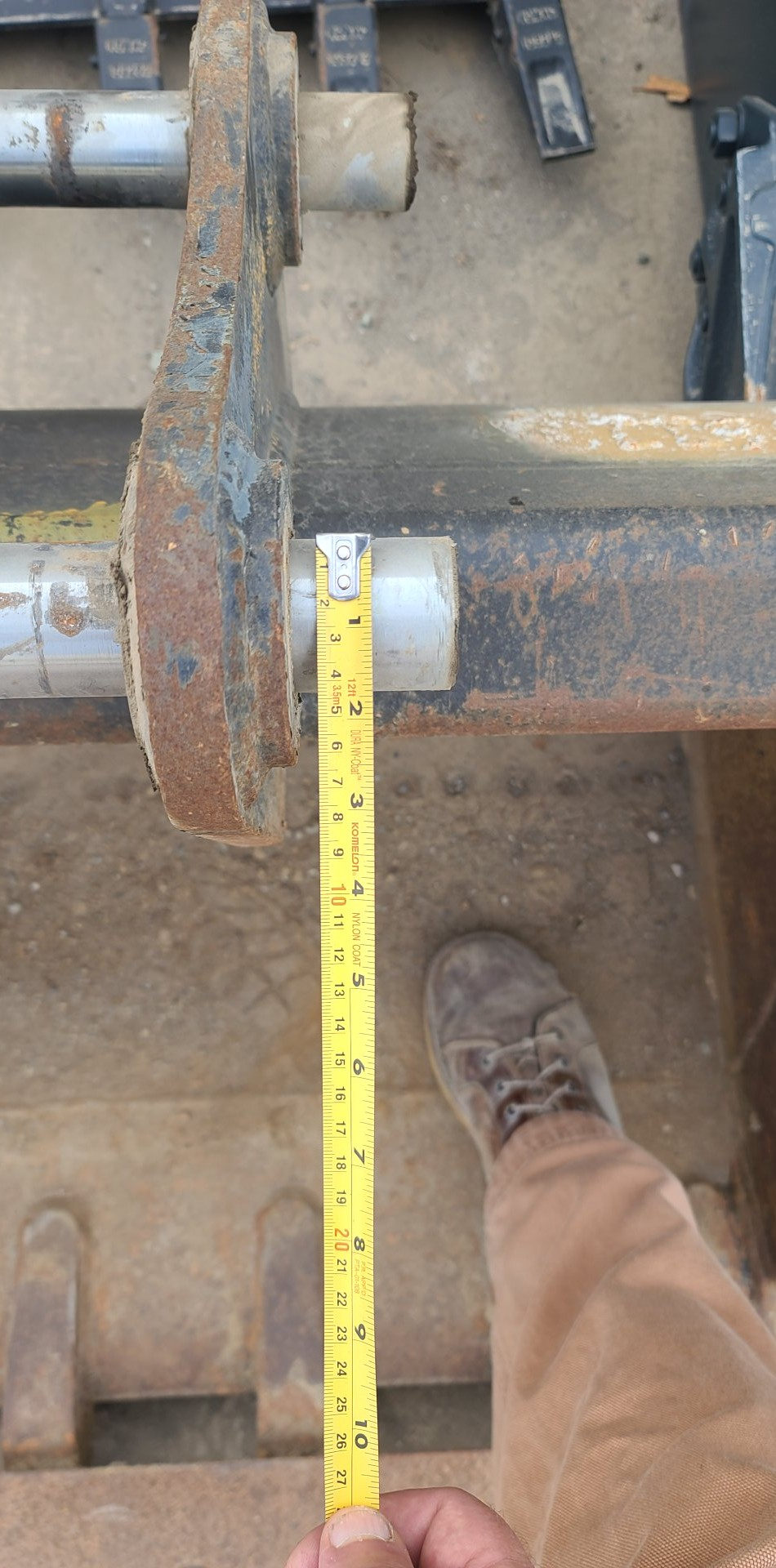

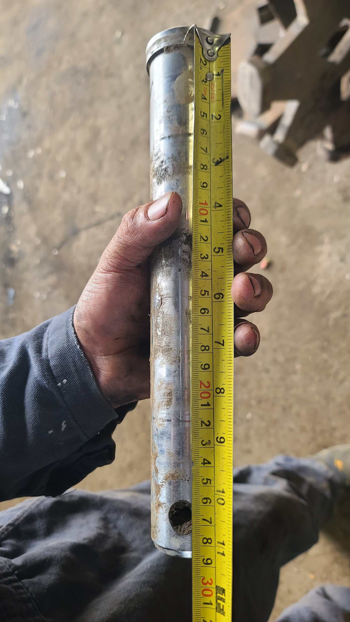

A buddy is offering me these used pins, he has the same quantity I need. They’re 45mm, I need 1.750”. So these are 20 thousandths bigger .020”. He said use a metric hammer to install them into the standard bushings, lol. I can probably open the bushings up some. They’re 1 inch longer than the longer ones, and three inches longer than the shorter ones. Doesn’t sound like a problem.
   / Ed's 77 Terex 72-41 Wheel Loader #593
That's really close in measurement. Worst case you could have a machine shop turn them down to 1.75" for you. And cut them to the length you need.

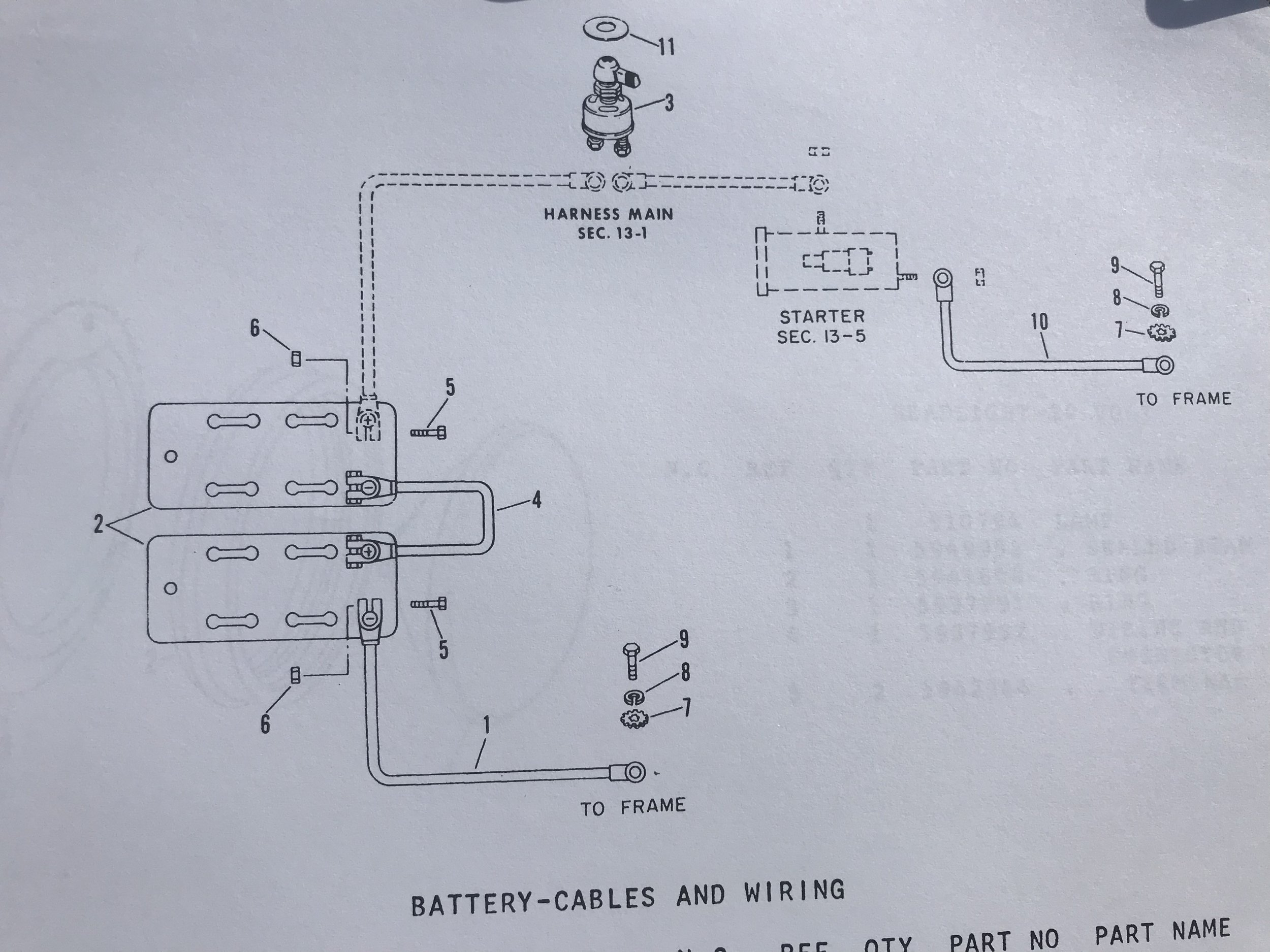

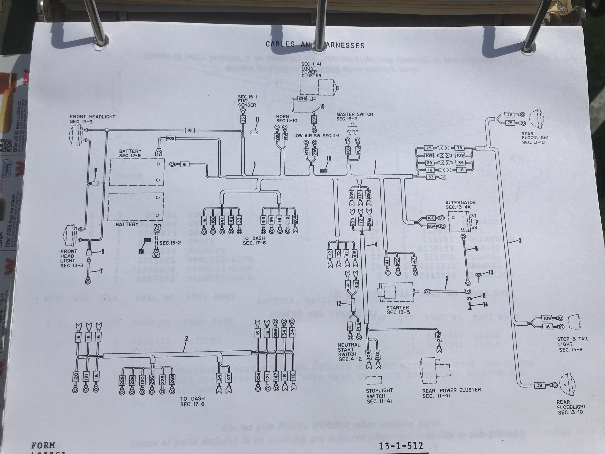

I bought 24v relays, but the snow came before I could do anything. It’ll have to wait.

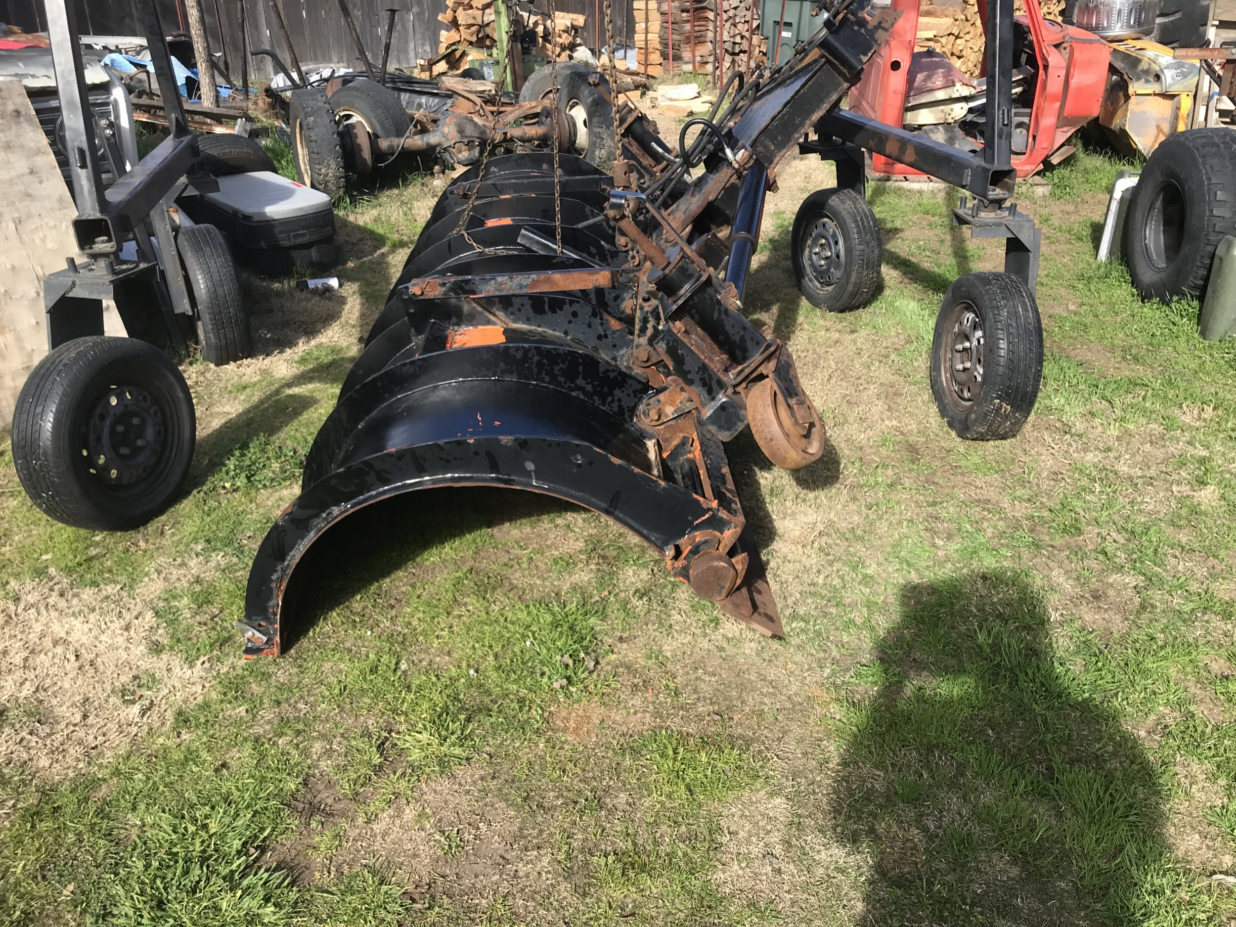

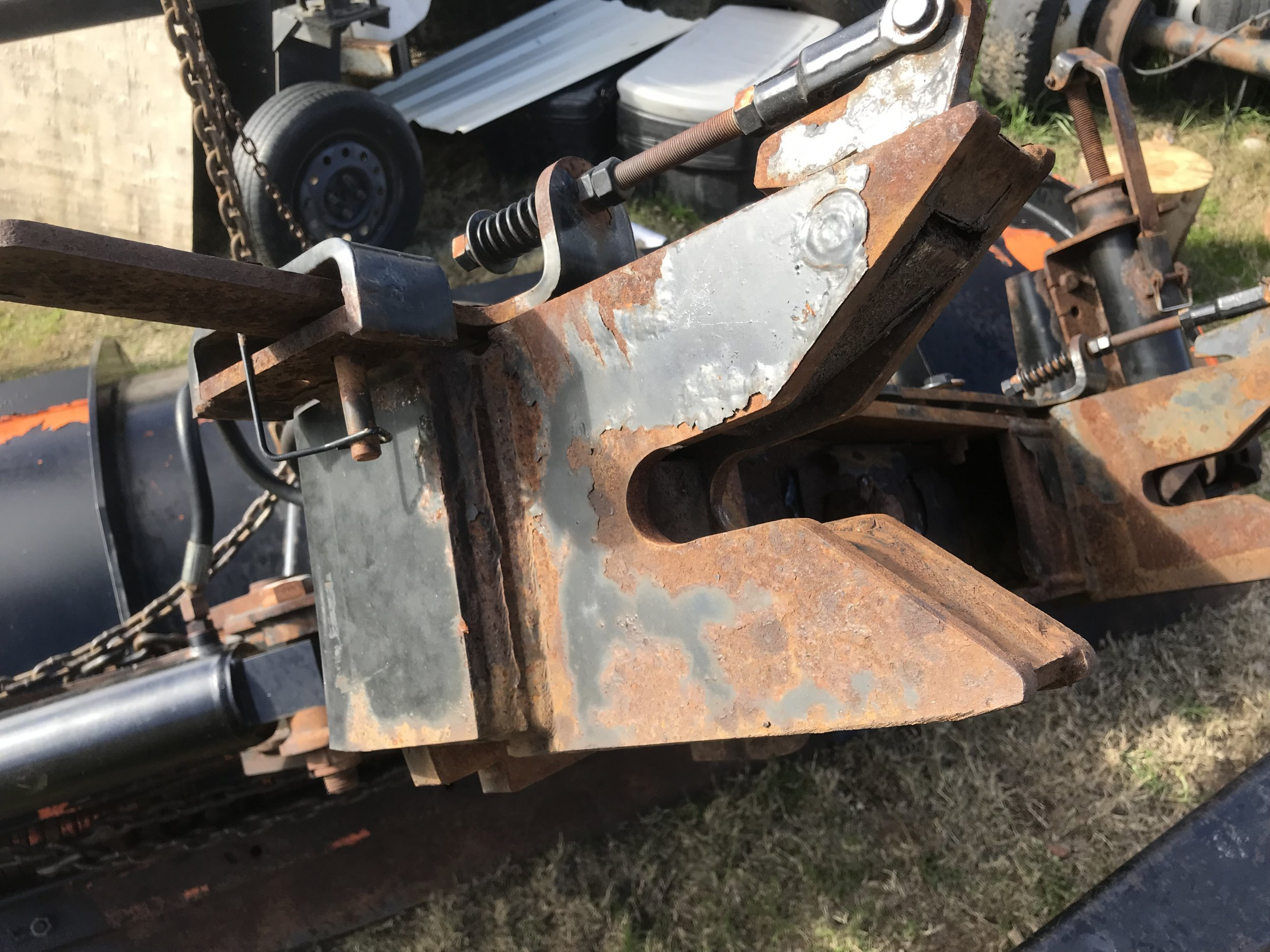

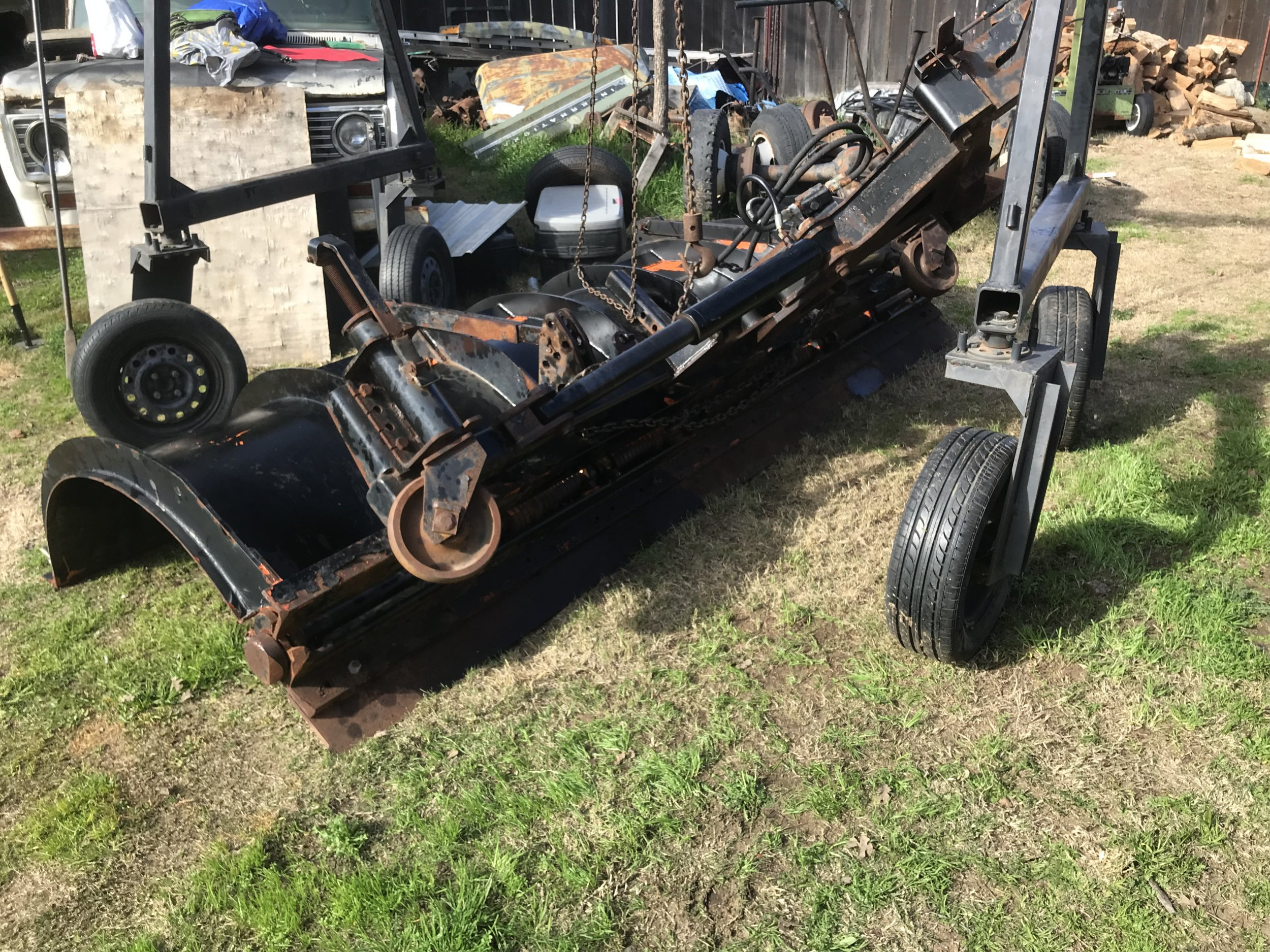

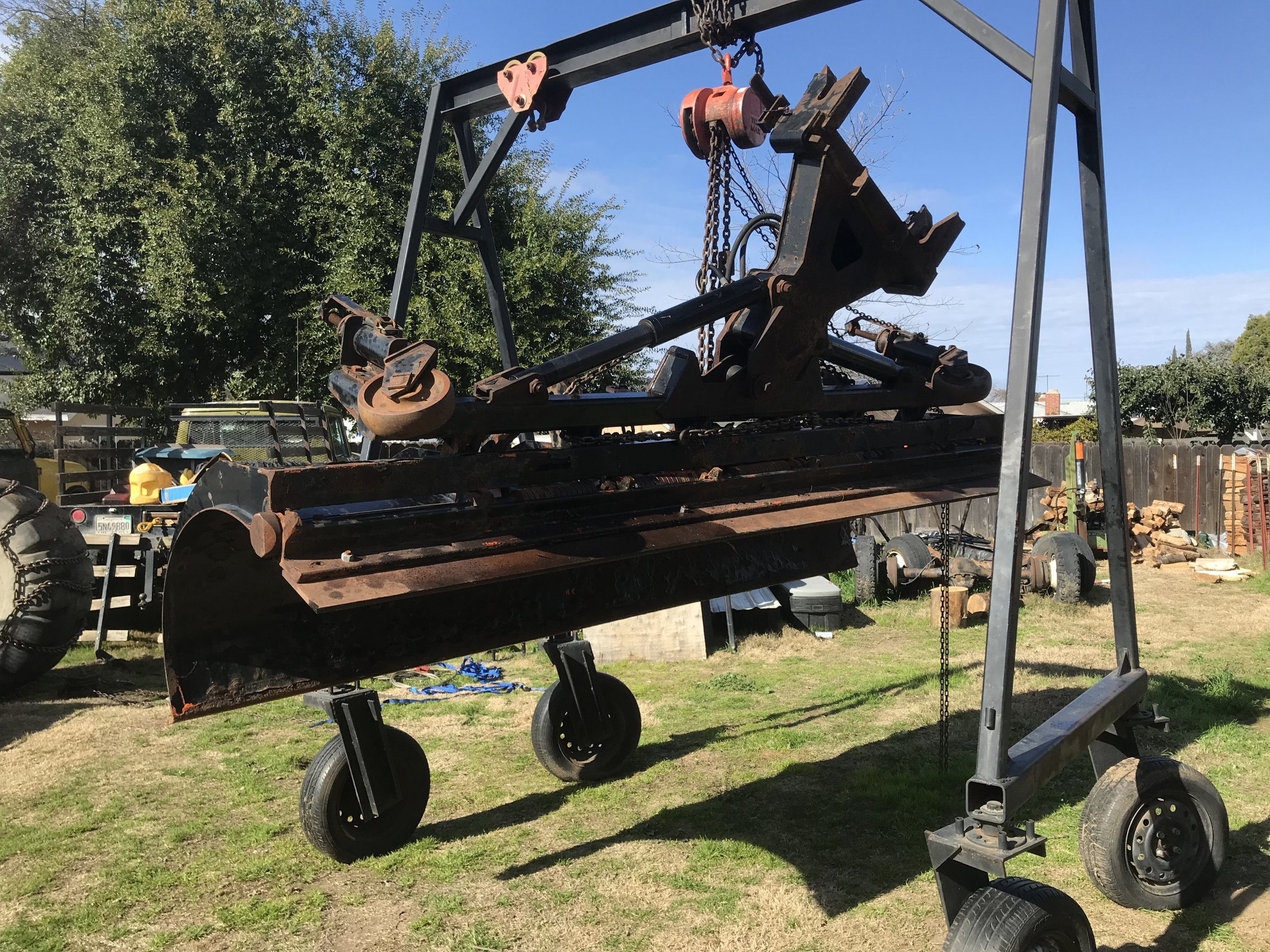

Got a good deal on a 12’ snowplow, and plan on adapting it to the loader. It’s reversible, so the snow will go either left or right. Or you can make it perpendicular to the road, that’ll be necessary for abrupt uphill or downhill changes.
